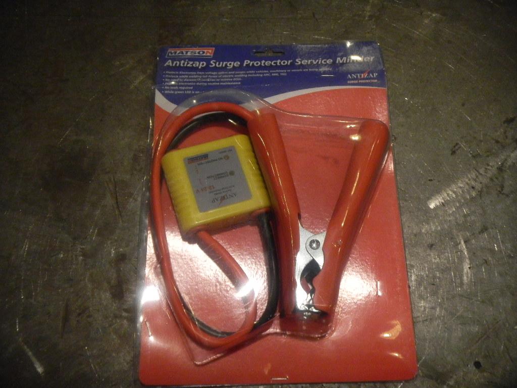

Guys over on Welding Web really brag about this tool. I bought one, but haven't used it yet.
That looks like good insurance. Especially if the WW guys endorse it - Thanks.
Says.... Made in China.... you sure it works????
