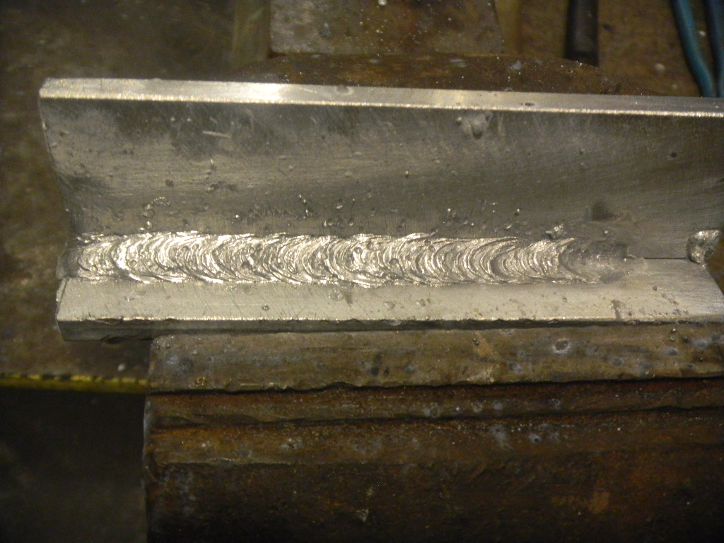

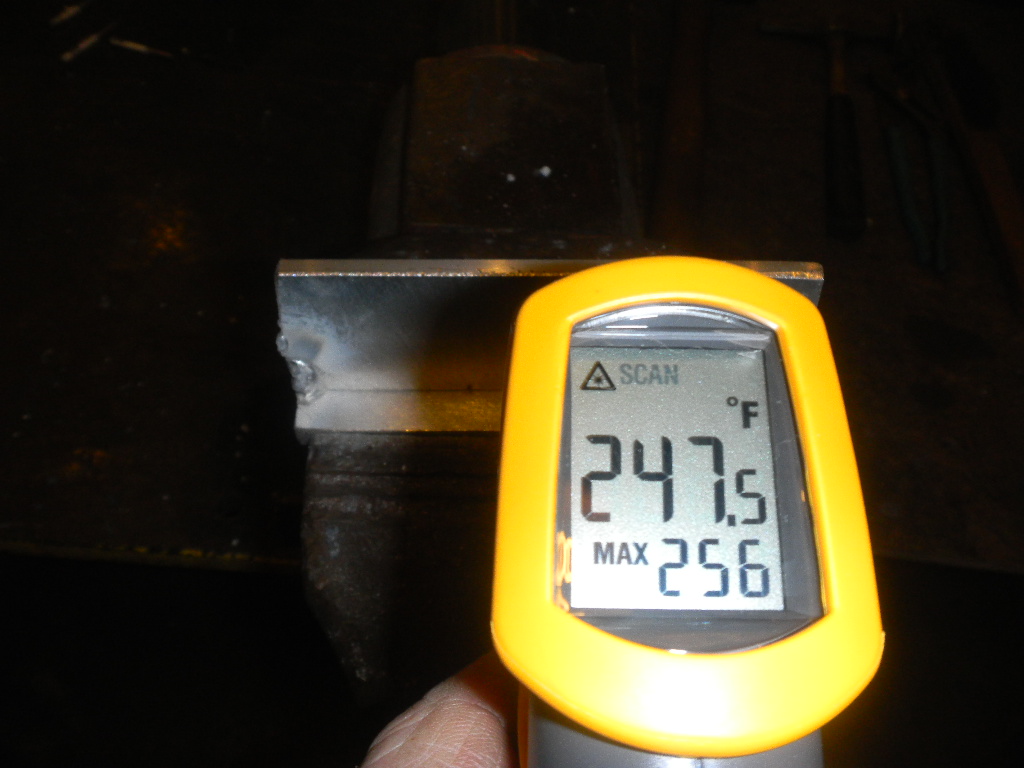

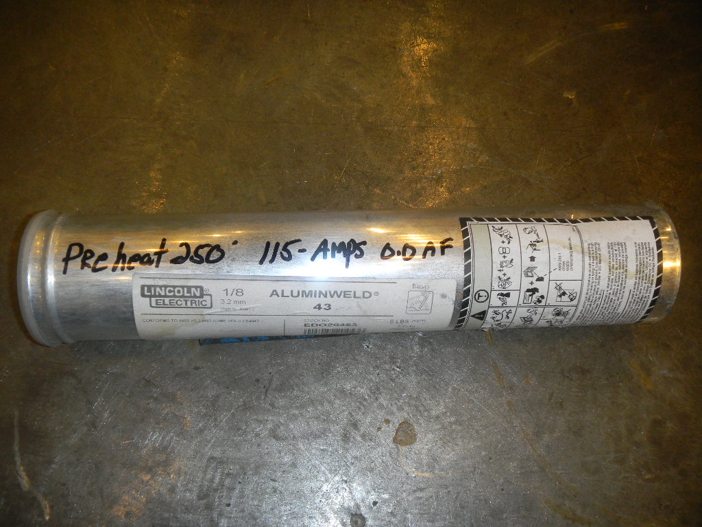

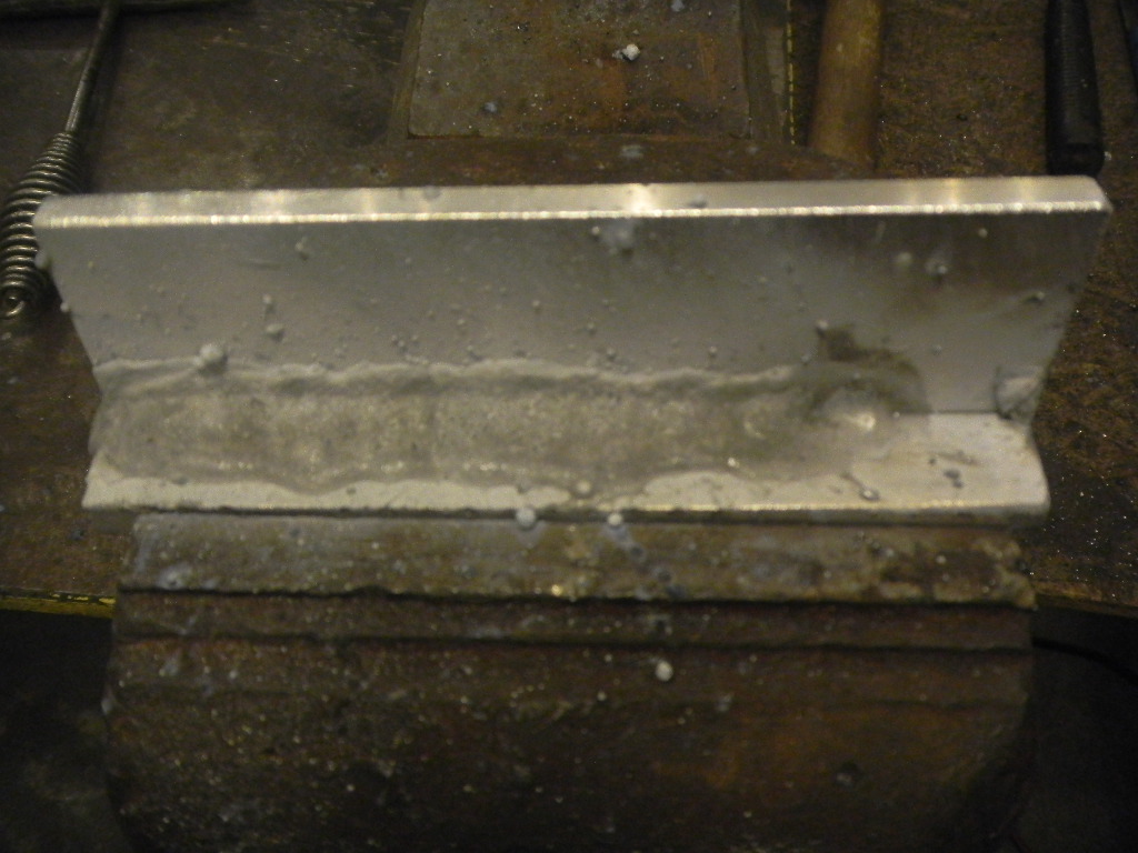

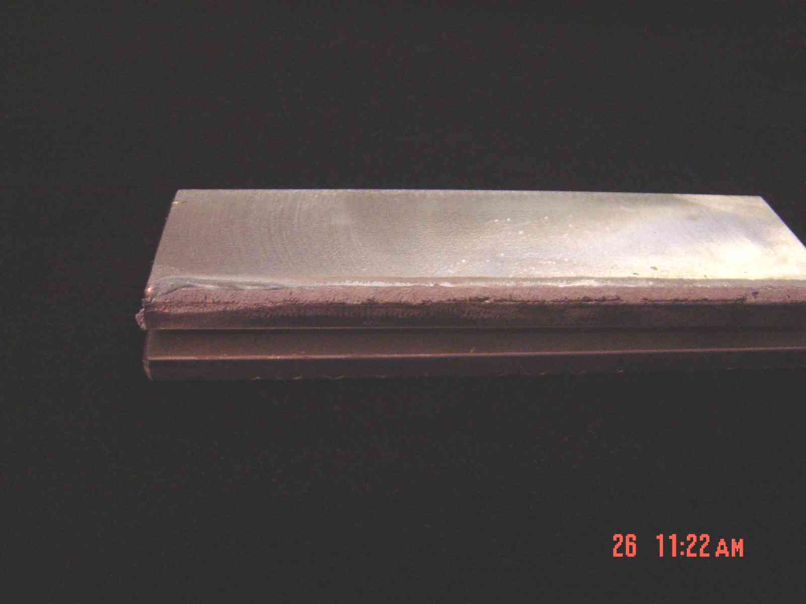

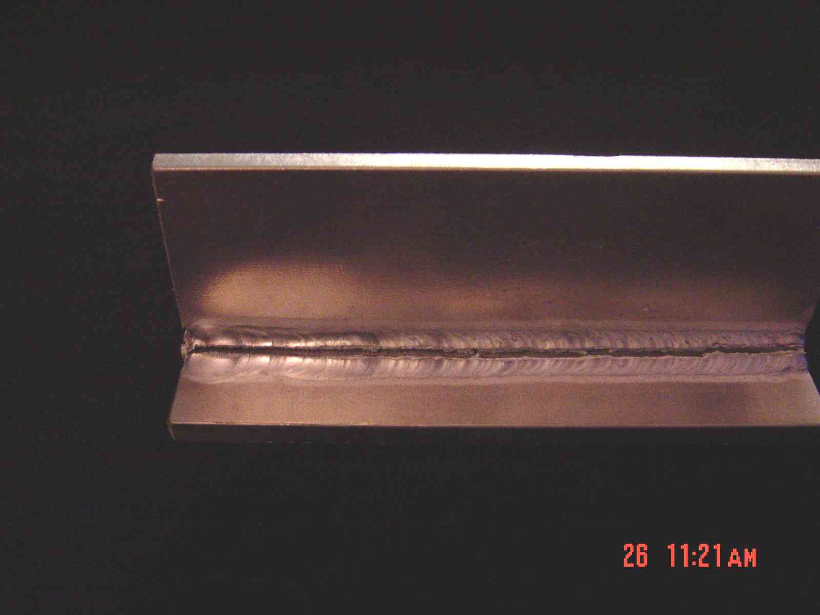

I gave it another go this morning. I don't know why, but preheat made it easier to weld. The picture doesn't seem to do the weld justices, it looks better in person.:confused3:
The slag is still a beach to get off!
Keep at it Shield, you will make pro some day!:D .Seriously though it does look tied in to the base metal, so I guess it is welded pretty well.. did you consider taking a hammer to it and finding out?
/ Stick Welding Aluminum #22

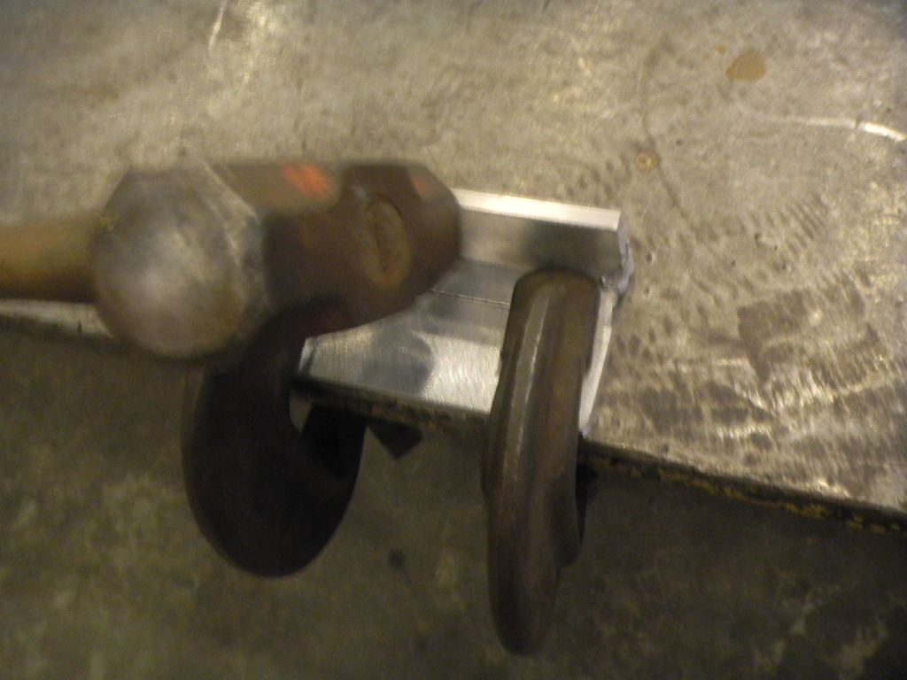

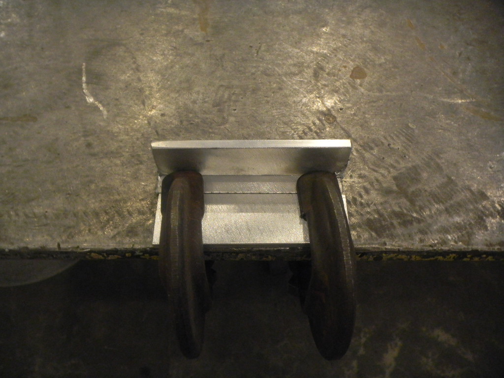

Well I accidental dropped it on the floor and it didn't break, does that count?:laughing:
I didn't think about breaking it, so I went back out to the shop after reading your post.
2-blows with a 4-pound hammer!:eek:

/ Stick Welding Aluminum #23
yeah, I am thinking that this stick welding of aluminum is for the birds.

Out of curiousity: How many hammer blows would that particular joint taken to break say it had been welded with either tig or mig? (Reason I ask is that I have never welded any aluminum).

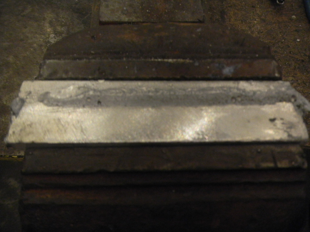

When I first got my Dynasty 300 7 or 8-years ago I was trying to figure out how to run it. I did some testing, but I can't remember the number of blows. But look at the top edge of the plate, it has some pretty good dents in it. And look how much the top plate is bent before breaking.

I had to join in the fun and give it a shot, I took it a little more serious than the last time it tried them. Heres some 3/32 alum stick filler at 75 amps. The rods were horrible, been sitting in a cabinet for years.

I know what your saying, the flux is like a hard yet soft brittle sponge, until you have to remove it :0 I did notice it comes off alot easier when it cools down tho. Ill check my bench tomorrow and look at the stubs. In a pinch tho I felt they would work, maybe not for long term, but I felt a little more confident with them after a little tuning.
