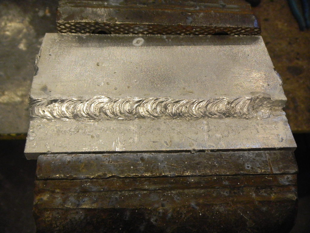

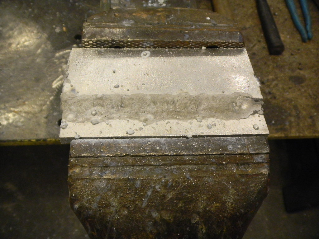

/ Stick Welding Aluminum #4
Talk about burning up dollar bills! :eek:
I get the biggest kick out of your videos! :laughing:
I had similar luck as you.:eek:

/ Stick Welding Aluminum #5
I did some aluminum stick welding years ago and it took 2 pots of coffee to put me in the correct frame of mind to use this process and by the way the welds pictured here looked like my best aluminum stick weld beads. I feel better after seeing real welders struggle with this method. :D

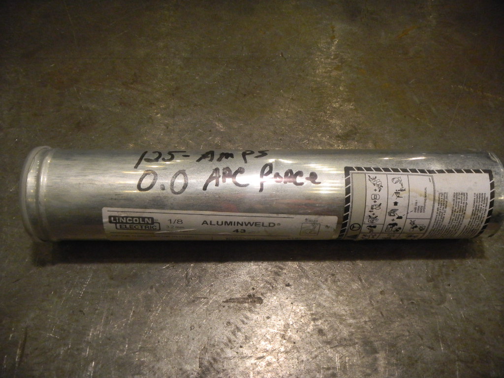

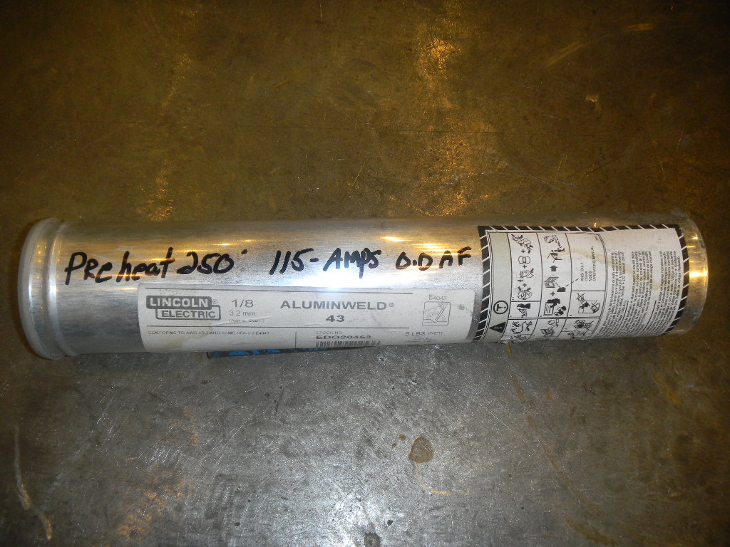

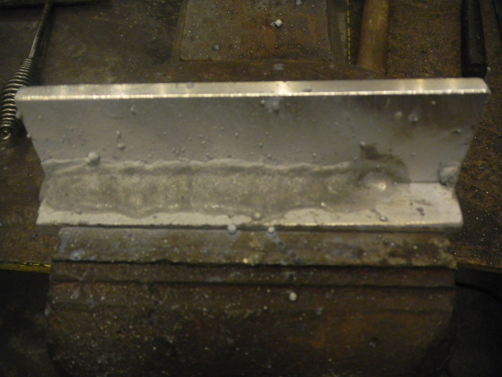

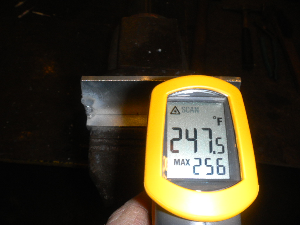

I gave it another go this morning. I don't know why, but preheat made it easier to weld. The picture doesn't seem to do the weld justices, it looks better in person.:confused3:
The slag is still a beach to get off!
