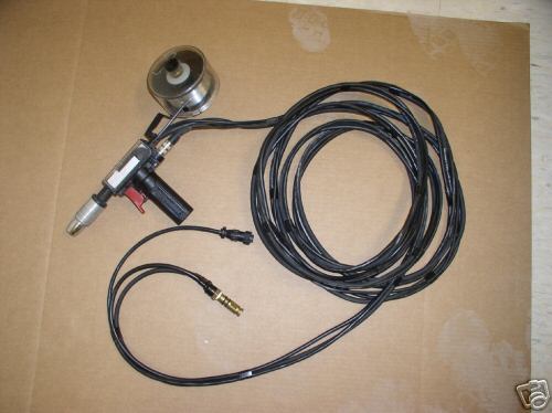

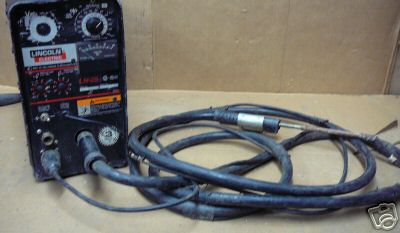

I seem to remember using a wire-feed unit that attached to a big lincoln welder-generator. It was a flux core alittle smaller then a pencil and we used it to weld relatively thick metal. I wonder f there is something like that for a smaller stick welder to give you wire-feed capability for cheaper then buying two welders?
   / Stick or wire feed? #13
You must be talking about these units. The LN-25 will handle mig wire up to 5/64. It is an add on to generators. I have a 10,000 watt diesel generator that I would love to add this unit.
The LN-22, Squirt is a smaller add on unit. Ebay has both of these listed.
The second picture is a spool gun, just plugs into the generator.
