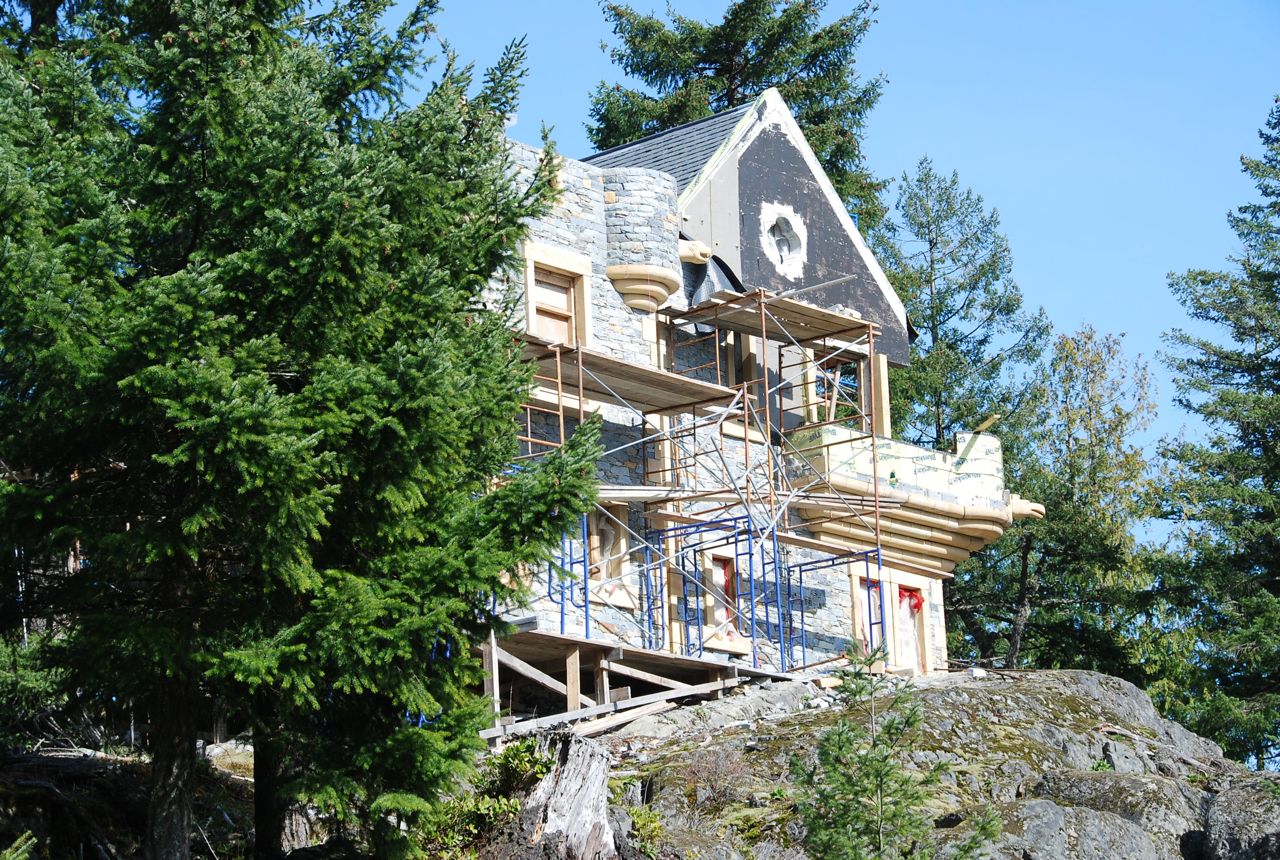

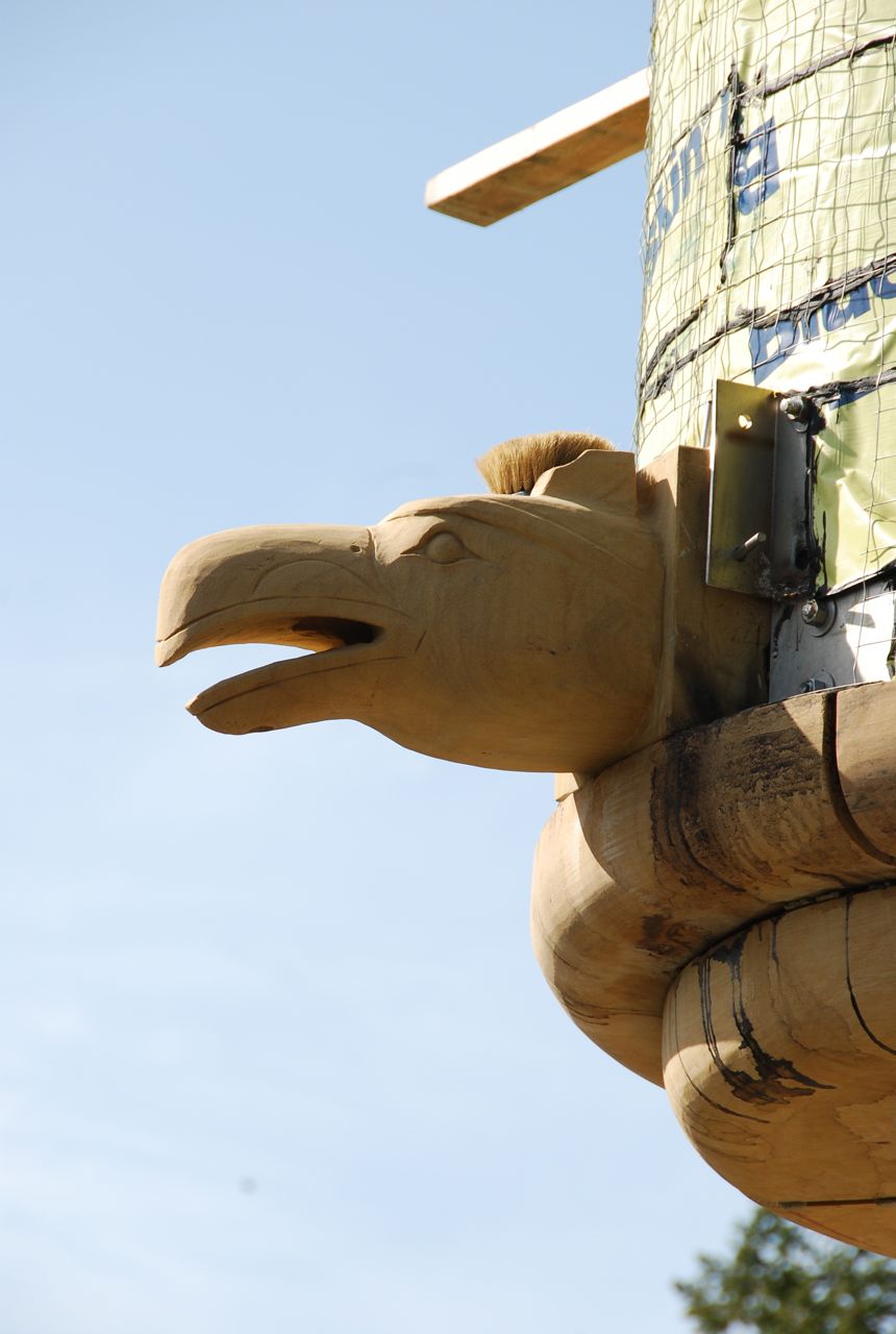

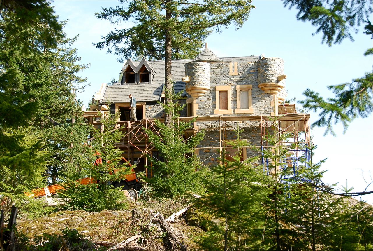

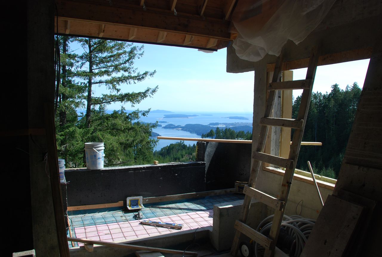

I'm with the concrete aficionados. A well designed and built concrete structure will out perform stick built in just about every aspect except cost and construction speed. Here are a couple shots of a stone clad, insitu concrete home we designed for a client and which we've spent the last eighteen months building. The stone couldn't be readily hung from the structure using a construction method other than insitu concrete. There is just no way we could have built this using stick frame. The complexity of the structure, including curved stone corbels and the need to hang eight stone gargoyles from the envelope, shows just how versatile a material insitu concrete can be.
