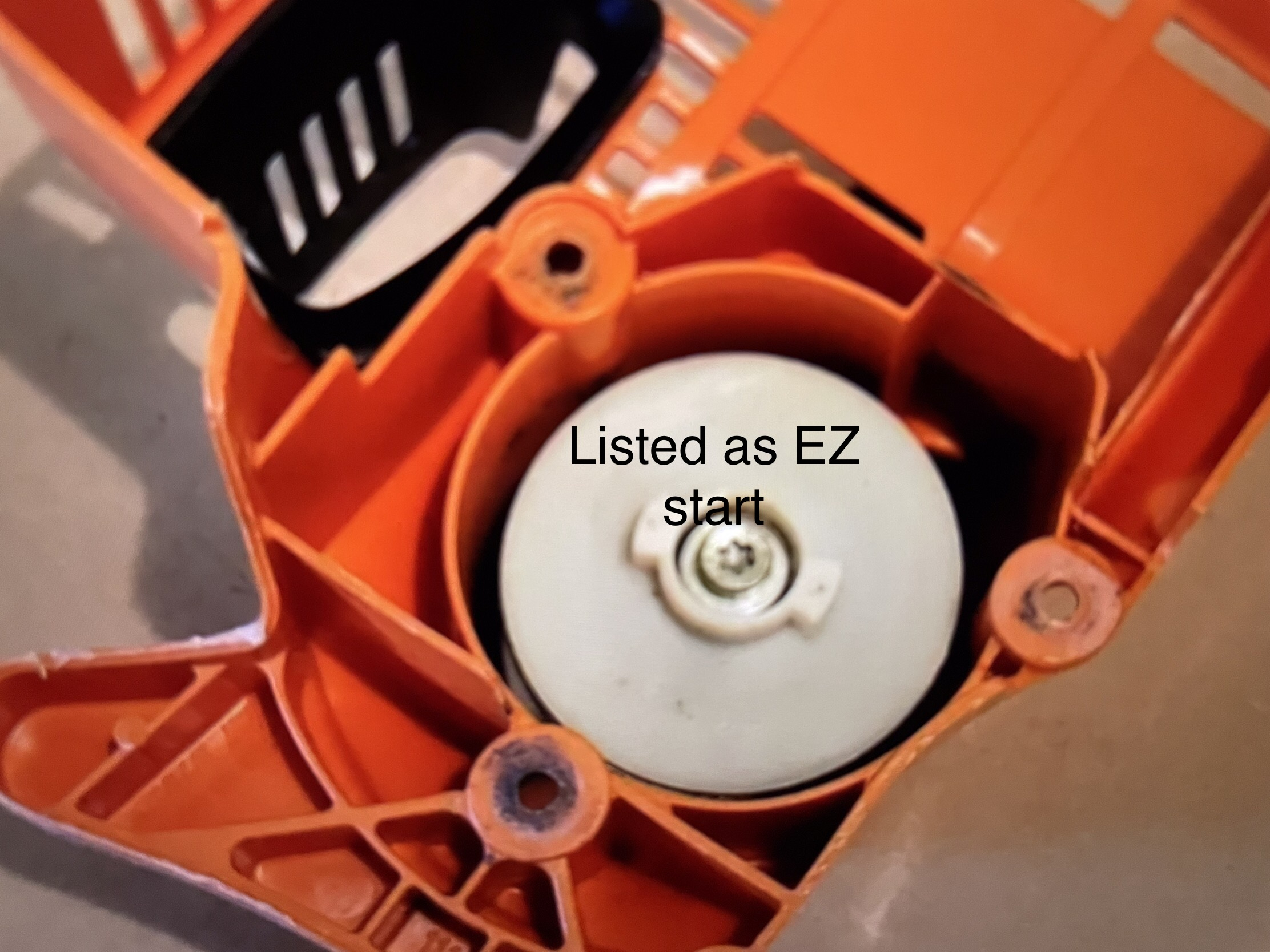

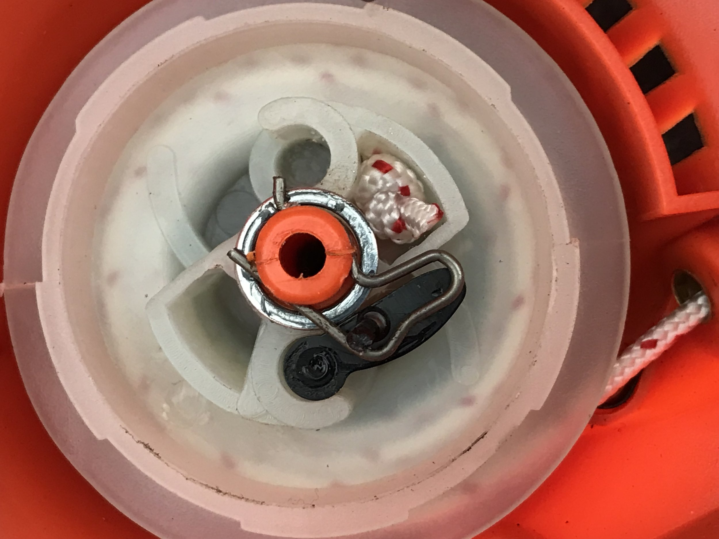

Hi All, having problems with the recoil starter pawl, it’s an aftermarket assembly with a white pawl, when I install the stater it pulls and turns over fine with the spark plug removed, when I reinstall the plug it snaps the white pin on the pawl.
Any Thought as to what I may be doing wrong.

Hi, here’s what I know : Sthil mdl # FS46 C E2S , S/N 263985156, was running fine until the string broke at which time it was disassembled, and parts were lost, I have tried to install an OEM aftermarket starter, see pic’s, when installed and plug removed it pulls fine , when the plug is installed pull hard and snaps the pin off Of the pawl, is there a different starter for an EZ start?

Can you indicate in the photos that part that keeps breaking ?
I don't see it.

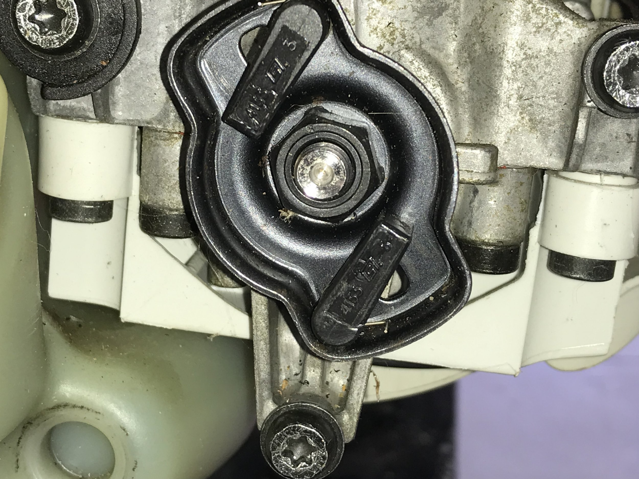

Hi, it should be FS46C , here is a pic.

Yes , the black piece is mounted on the motor.

Now we are cooking. First of all, you have a mismatch between the recoil starter type and the recoil item that is on the engine. The starter part that is bolted onto the engine as shown in your post #4, photo 4, requires the recoil starter as shown in photo 1 of post #4.
Here is a photo of a screen shot from a video, note that the recoil start item on the engine is a cup type;

If you want to use the recoil housing that you have, then you need to get this cup style item for the engine.

So you are saying the one I have listed as EZ start is the correct starter.
/ Sthil FS45 #13

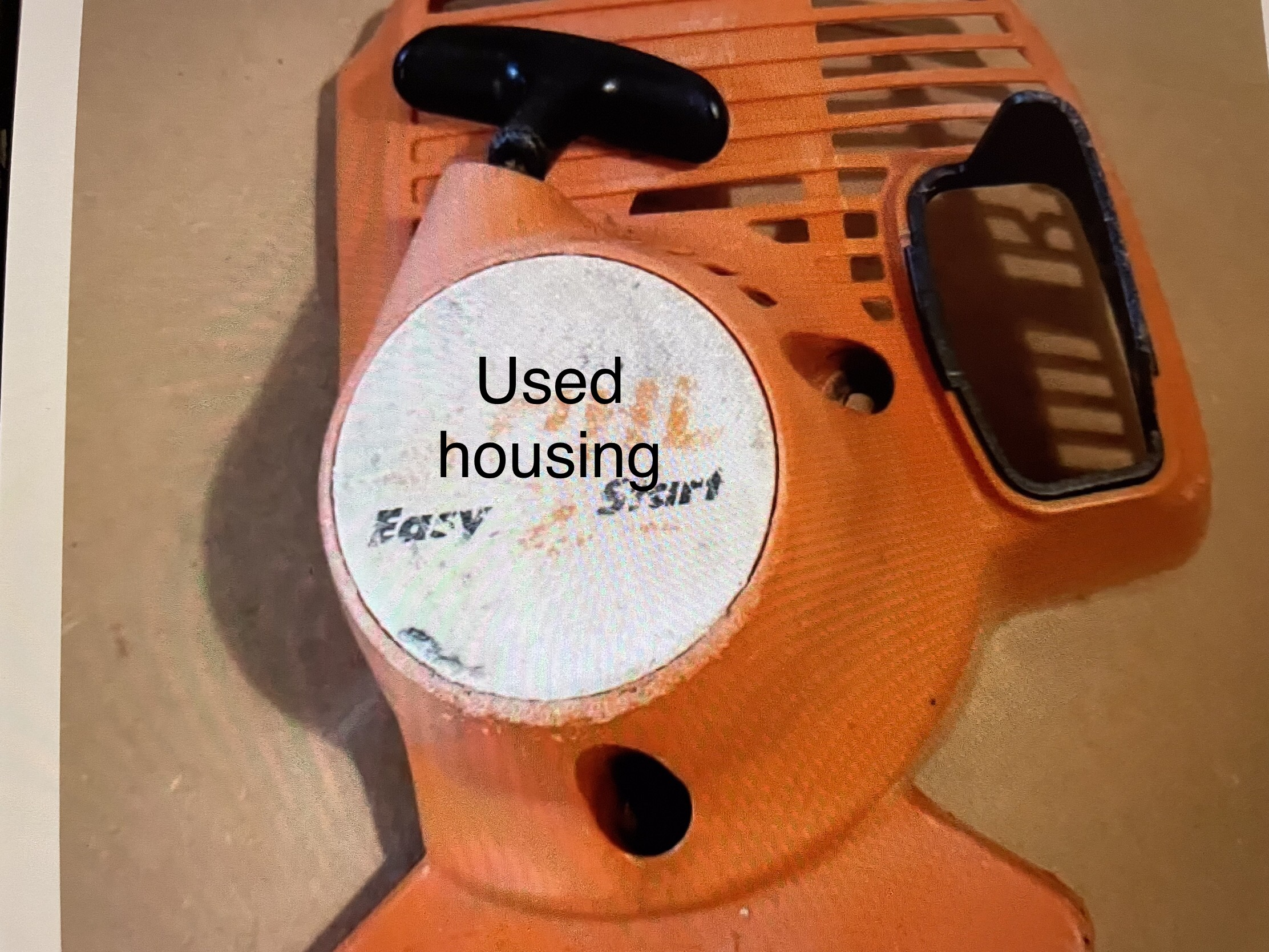

Yes that would work with the item that is now bolted onto the crankshaft. You have choice of either getting a starter housing that will work with the item on the crank, or getting a different crank part that is like the cup that is shown in the photo that I took from a video. Then the recoil housing that you have will work with the cup type part.

Hi, I am pretty sure I have , I order a used starter housing on E b, waiting for it to arrive, it should match the end that is on the motor, Ill let you know the outcome.
