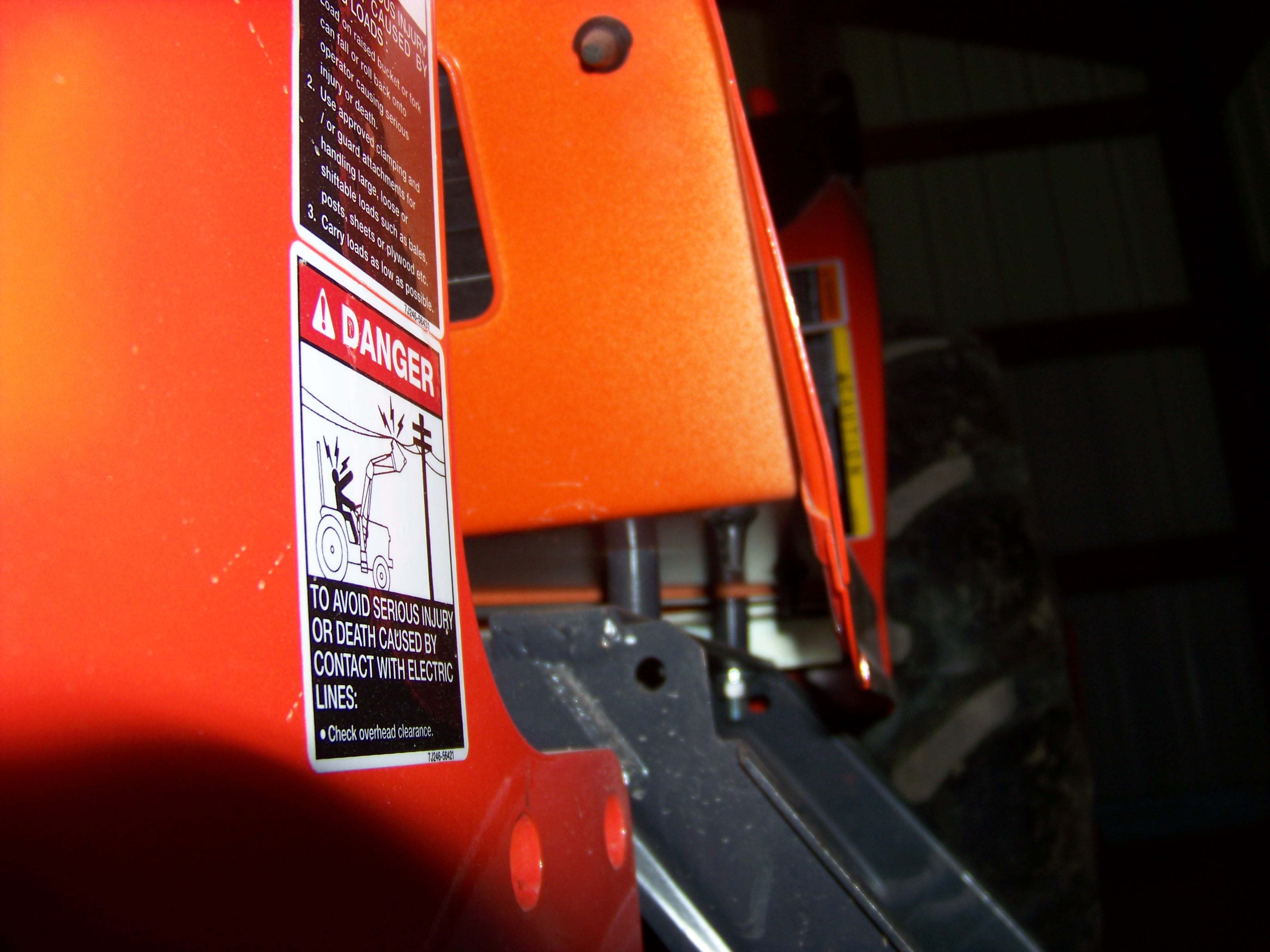

The step off the B3300su fits the B3200 for sure, and might even fit the B2x20's, I looked under the floor board and saw the mounitng plates, on my B3200. Have not look under the B2x20's floor board yet to check it on this.

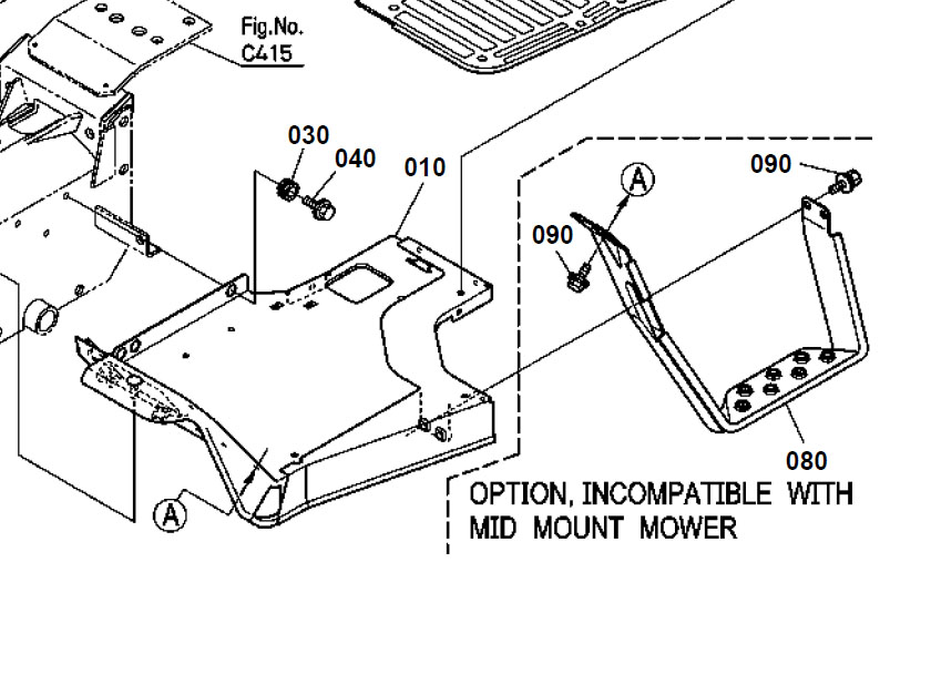

I bought a factory Kubota step for my B2630 right from the dealer. It was under $20 and made all the difference. I think Kubota makes steps for all the tractors, just not sure why they're not included. Check a parts diagram, you might be surprised.
Any chance of getting pics of the mounting plates, Troy?
I ask because I had my dealer order a B3300 step for my B3200 after reading here that it fits. Well, unless I'm blind or stupid (probably) there's no way!
Now, the dealer just replaced the floor board for the vibration issue, so maybe they left something off from the original???
All I received is a horseshoe shaped step, so I thought perhaps there is mounting hardware that I didn't get.
Thanks
Ken

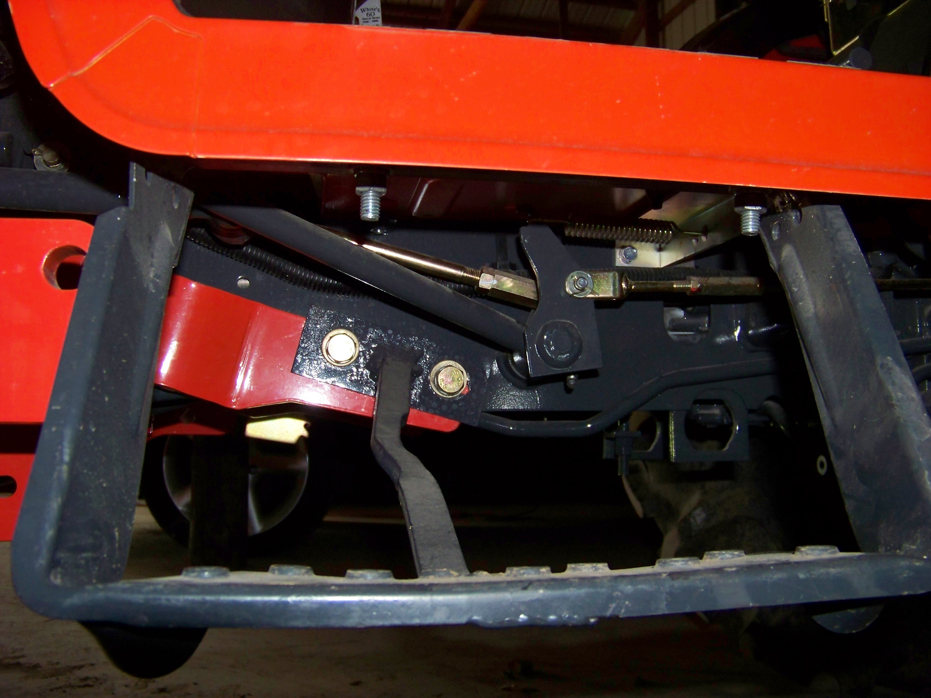

I bought the same step for my B3030 and it fit right on. The left side of the floor pan should have a bracket welded to it and two weld nuts on the front angled part of the floor. The step comes with no extra pieces. Is it possible that the floor pan the dealer replaced is different from the original?

Kubota makes a left hand step for the B2630/3030 which also fits on the B3200 and the B3300. They all use the same floorboard/fender setup but I have not looked if the step will fit the B**20 or not. Might be close enough to retrofit. Only cost about $20 form Kubota.

Thanks guys.
Rob, your posts explain my problem. They sent me part number 6C230-71693, which has different mounting tabs. I printed your image and took it out to the 3200 and it's obvious that will fit perfectly.
I'm calling them in a few minutes to exchange for the correct part.

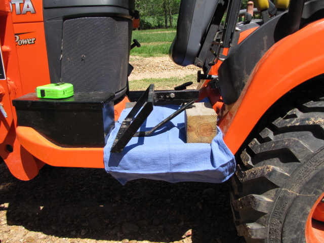

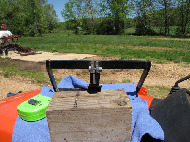

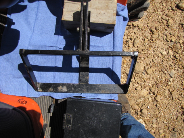

Tried to do this last night, but was getting a big updateand couldn't do. Dial up sucks!!!!!
Well anyway this is how I made mine for the BX2660. It's 12" wide X 6" high. The top cross part is 3/8" x 1" and the others are 1/4" X 1 1/4" and 1 1/2". It has 3 adjusting holes, only one hole is used and that is 5/16". You could use a pin I guess, but it might move around a little.
The step has to come off when using the MMM deck.
