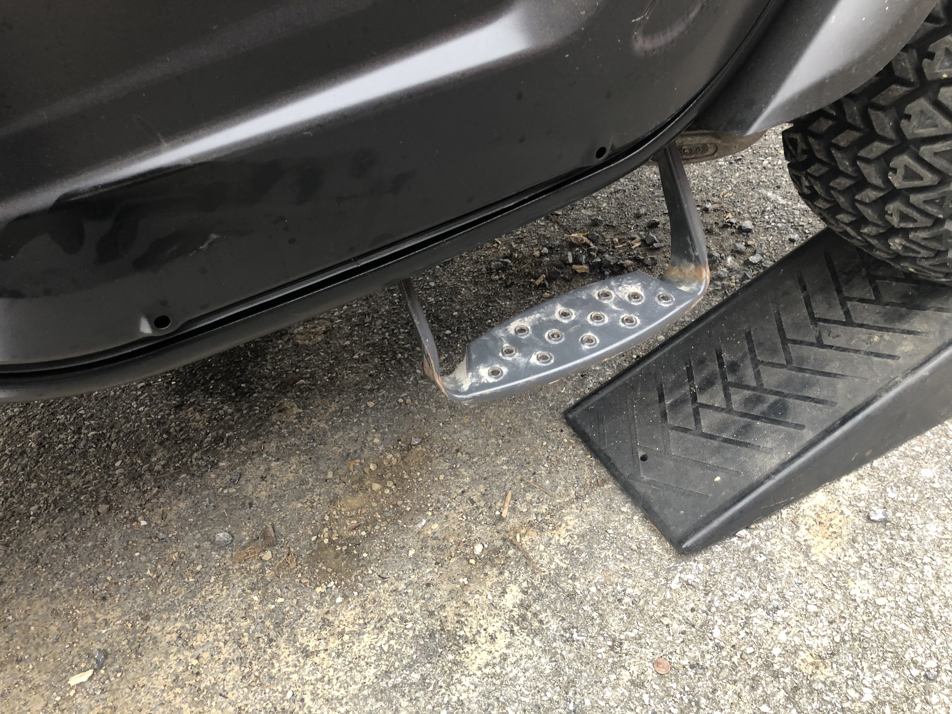

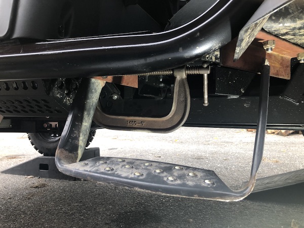

I looked at my x1100 and bolted in two 10 inch lengths of 2 inch angle iron and bolted the step to the angles. Did not have to weld anything
   / Steps for an X1100C? #13
here are some pics

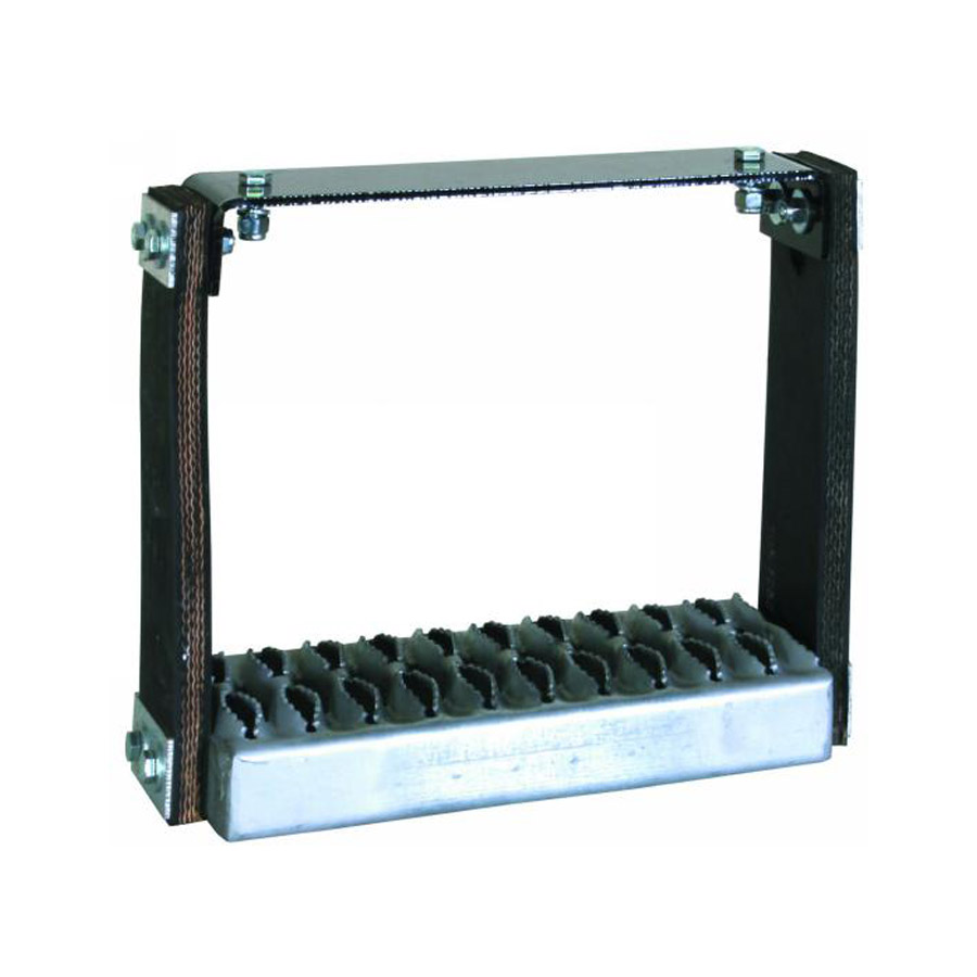

   / Steps for an X1100C? #15
Yes it is flexible for sure. However it needs hang directly under the front edge to work best
