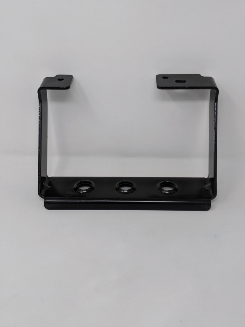

I added a step to my old 1100 for my wife. Took it off when I traded it in for the x1100. It worked just fine but had to watch clearance over large rocks. I still have it if you want me to take a pic of it?
/ Steps for an X1100C?
Yes please, thank you.
My concern is the mounting. Did you weld directly to the underside frame rail?
And did you use a small truck or jeep step and adapt it?
/ Steps for an X1100C? #7
The step is from a Kubota tractor. It is one these hoop types that bolt on. Drilled mounting holes into existing support straps on the underside and bolted it on. Works very well and sturdy

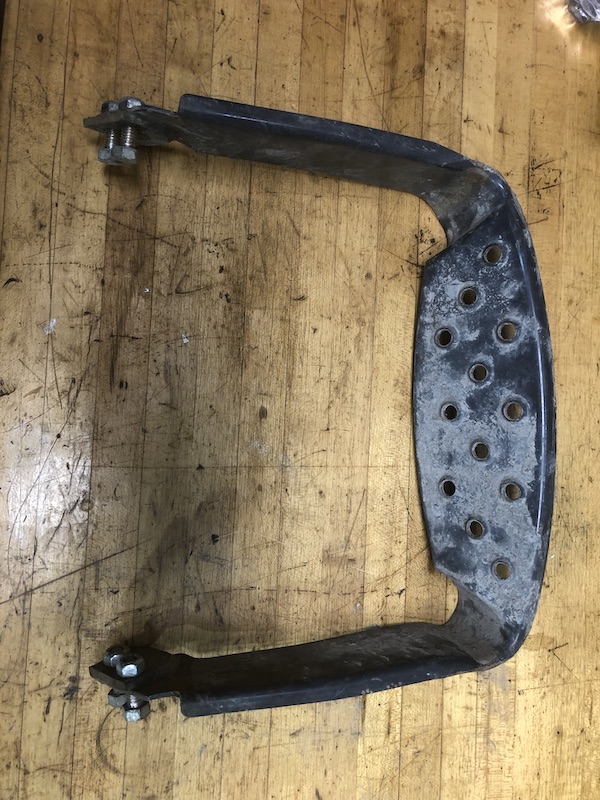

/ Steps for an X1100C? #8
Here is a pic of the step

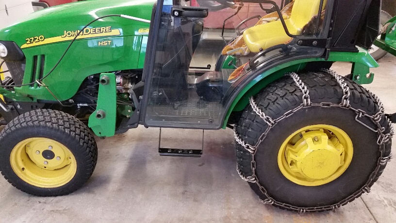

/ Steps for an X1100C? #9
That looks similar to my Deere one I put on my 2720. It is about 10.5" wide with a 5.75" drop and about 3.5" offset. The deere part number is LVU18332.

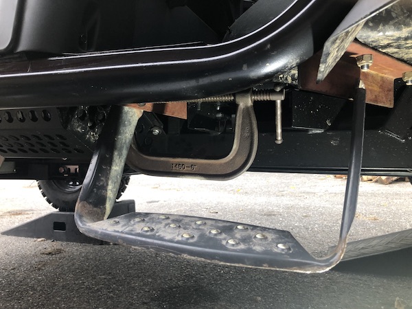

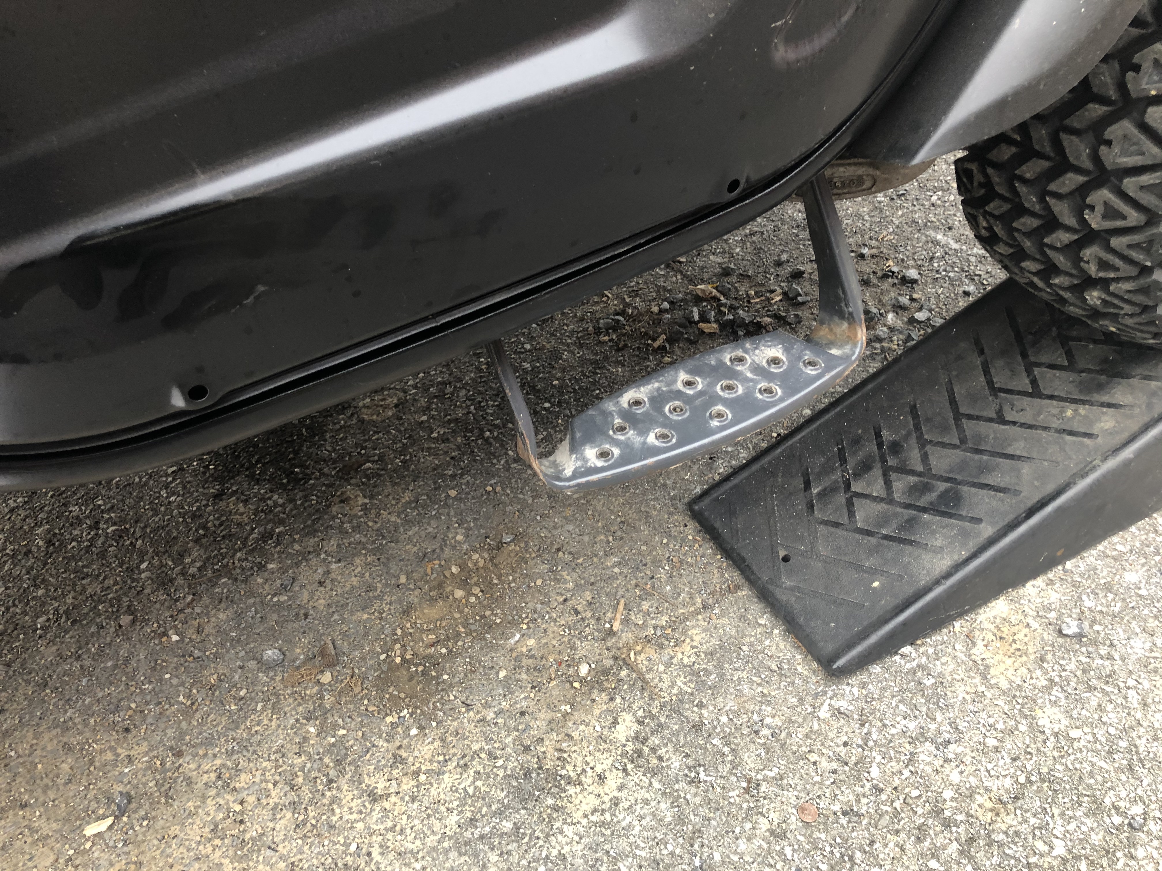

/ Steps for an X1100C? #12
I looked at my x1100 and bolted in two 10 inch lengths of 2 inch angle iron and bolted the step to the angles. Did not have to weld anything
/ Steps for an X1100C? #13
here are some pics

/ Steps for an X1100C? #14
/ Steps for an X1100C? #15
Yes it is flexible for sure. However it needs hang directly under the front edge to work best
