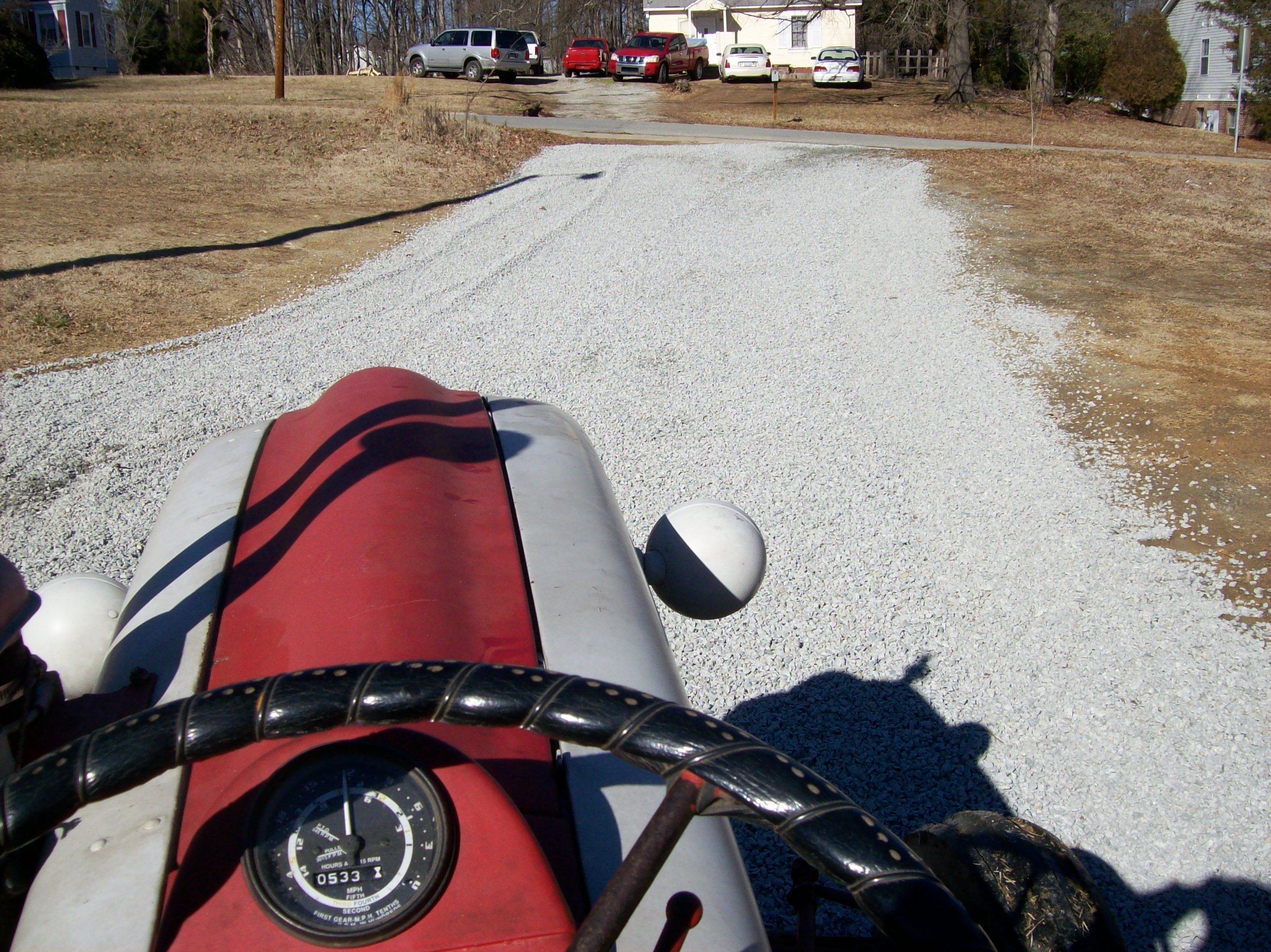

By the time I get one of those new steering wheels to my front door it has cost me fifty bucks, a serious dent in my beer budget. So, I'll repair what I've got, stitch on a fancy new leather cover and call it a day.

I have ordered some epoxy filler for the repair. I chose epoxy because of vibration, flexing (getting tugged and pulled) and for the strength of epoxy. JB Weld would be good but, somewhat expensive so I chose PC7. Once cured, I'll shape it to the spoke profile and then paint it with gloss rattle can enamel. After that has set properly, I'll stitch on the new leather wheel cover.
Thanks to all for your inputs and comments.
