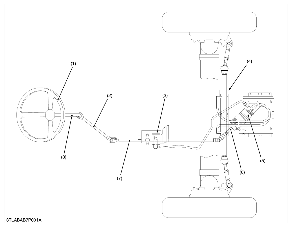

Actually, it does have steering shaft linkage and U joints.
Well I stand corrected with egg on the face. I ASSumed his steering system is the same as mine on my Kioti, which has no steering linkage and no steering gear box. This looks more like automotive power steering. I guess this is what I get for ASSuming. :)
/ Steering wheel acting funny #22
Still an orbitrol steering unit, just located way up front. While most manufacturers just mount it under the dash.

Ok so this is what happen WHEN I WAS DRIVING to my friend the steering was not going from full right to full leaf just a bit off movement but by the time i got there the steering wheel had done a few turn on it self .
Now at home this morning whit engine off the wheel wont turn but if i get the tire off the ground the tire will move if i turn the steering .
Whit the engine running yes i can turn turn wheel find to the right and to the leaf

ALL Orbitrol steering systems will free wheel when the engine is off ALL. You will have a little bit of residual pressure but if you keep turning the steering wheel left and right, it will bleed off and will go round and round and round as many times as you want to turn it. This is perfectly normal.
Mine does not freewheel when off. It does drift especially when cold. I know you said all, but I can't remember one?
Best,
ed
/ Steering wheel acting funny #36
The HMU is a small hand driven pump that sends pilot flow to a valve. Turn, flow shifts the valve, valve directs oil to cylinders, machine turns, stop turning, centering springs center valve, flow stops. It’s all hydraulic, no feedback to the steering wheel like on power assisted steering like a rack and pinion. When hydraulic pressure drops below a specific pressure, flow from the gerotor pump flows directly to the cylinders to provide ability to steer if the engine dies. This is the system on the machines I’ve engineered my whole career, and as described in my WSM (checked to see if there was something new under the sun). I read directly from my L6060 WSM. “When the engine is not operating, and the steering wheel is turned, gerotor(1) rotates to supply oil to the steering cylinder (2). Thus the machine can be steered manually.
The WSM covers all Grand L 60’s sold in USA. I do not believe this same unit is marketed in Europe because EN500 requires cross over reliefs so if you hit an object with a tire at and angle, feedback will create a pressure spike that can burst a hose. We needed to use a different HMU for Europe, a bear to keep straight on the assembly line. I thought Kubota might have commonality. My old M135GX has the North America, Oceana, and European versions in its manual.
So OPs tractor is full hydraulic, will have steering wheel rotate a little continual due to leakage (likely worse when hot), perfectly normal within limits. I don’t find those limits in the WSM. The difference between full hydrostatic steering and power assisted is described in my M135GX WSM. It concludes with all hydraulic, no feedback to steering wheel on position. I think they left off same as everyone else in this class, likely HMU from same supplier, live with it.

If the cylinder that is connected to the tie rods leaks internally, then the steering wheel could be constantly turning. On my little BX24 that is what happened. I noticed the drifting and if I was on a side slope the steering wheel had to be constantly, albeit slowly, turned to keep it straight.
