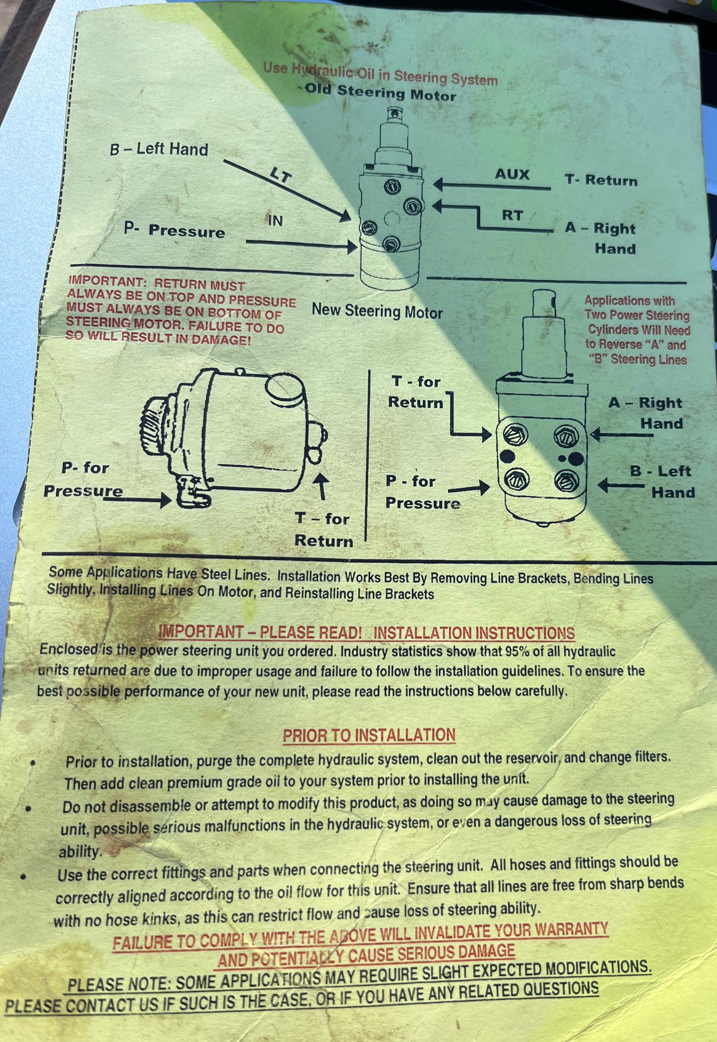

The first diagram below shows how I'm plumbed.
The second is the install instructions for the new pump.
Note on the pump instructions it indicates that if you have two cylinders you need to reverse the Left and the Right lines. I reversed them and disconnected them from the wheels. The steering wheels was then moving the cylinders in and out accordingly free of the wheels...buy its a bit of a hard wheel. Once hooked up to the wheels, it did not want to turn the wheels....very hard steering wheel. Then I switched the pump lines so left to left, right to right...very firm wheel...won't move. Thoughts? (cross posted on FB)
