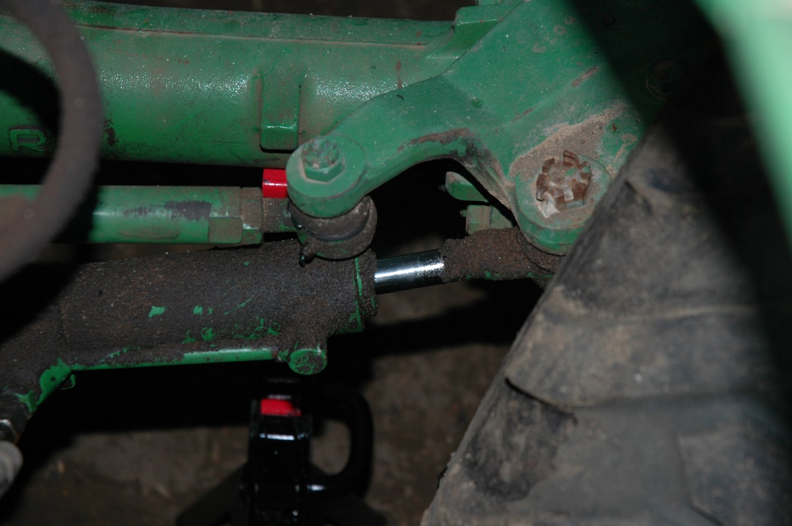

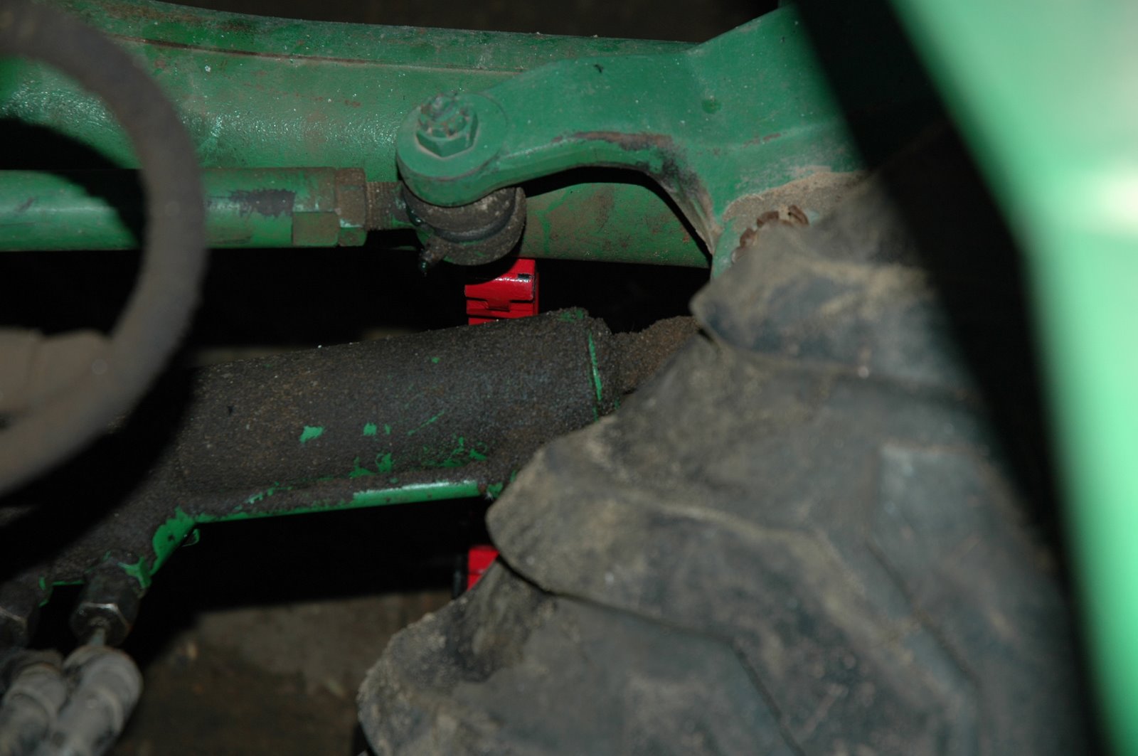

I had the wheel almost all the way into a full right-hand turn when I stopped to chat with someone. When I powered up again, I can not turn the wheel to the left. It will turn the rest of the way to the right and then back to the "starting point", but that's it. As it is we're talking less than 10 degrees of wheel movement.
Hydraulic hoses going to assembly attached to the right wheel both seem to flow properly when disconnected and the wheel turned. Fluid level was low and has since been filled and all hydraulics have been exercised a few times with no change in performance.

AKfish-- steering cylinder isn't blowing fluid. Got too dark by the time I got home and I've got tomorrow morning off so I held off your suggestion of disconnecting the cylinder.
kennyd-- turned to the left-- pic 3336. And turned to the right-- pic 3337
jd110-- hydraulics make the same noise whether the wheel is turned to the extreme right or abbreviated left...which is the same noise they always make when turned to the extremes. Again, what little play the wheel has it turns as easy as always. Put it on stands and disconnected the hoses to the steering cylinder. Could not budge the wheels. Steering wheel turns while these hoses are disconnected and spits out fluid from the appropriate hose depending on which way you turn the wheel.
Thank all you guys for thinking about this. --pd

If you could not move the wheels with the hoses off, then my bet is the cylinder is toast. perhaps the gland nut loosened and the seals are cocked sideways.
Take one end of the cylinder off, or just take it all the way off...and make sure you don't have a mechanical problem like a bent or binding ball joint. If all is free, you need to crack the cylinder open or take it to a hydraulic shop for a re-build.

After removing the cylinder and getting a good eyeball on it, I could see that it was slightly bent.
Took it to two different hydra shops and both said it couldn't be rebuilt.
Called up my Deere shop and got a new one for $550. For that price it's going to have a seat at Thanksgiving dinner each year. Yikes.
Seems like it's just a simple cylinder and someone could make one, but neither shop could.
Live and learn.
