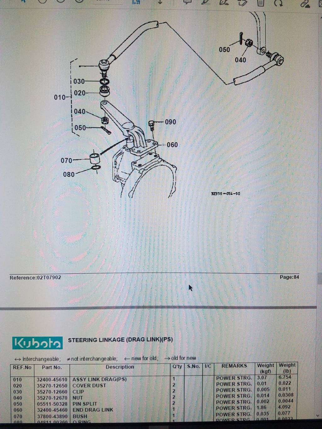

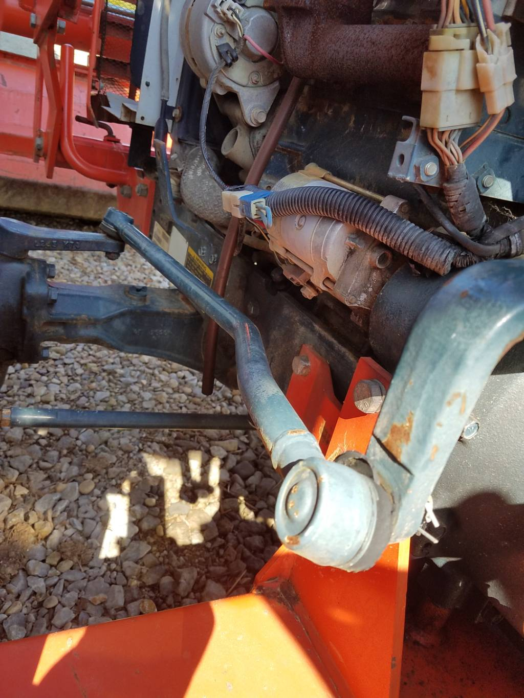

Hi!
I have a L2350dt... It looks like the 2 bushings on the ends of the steering linkage are torn and worn out. I've also attached a pic of my parts diagram that shows 1 of them (end by the wheel) I think as 35270-12650 COVER DUST. It does not show this part on the end by the cab.
Is this just a rubber bushing or is there more to this (the part name says dust cover)?
Are both of them the same part (since the diagram only shows one but my tractor has them on both ends of the linkage)?
If it's just a bushing, is it something I can get at a local auto parts store or do I need to order the real part from Kubota dealer / Messicks?
This looks like a simple unbolt, replace bushing, rebolt repair. Just want to make sure I get the correct pieces

Just a ball joint dust boot. Sized by big end ID, little end ID, and height.

So that is just a boot - not a bushing.
If my drag link bar is "loose" (it wobbles around)... what is needed to repair it? Does it require a complete new drag bar?
/ Steering linkage (bushing?) #4
If the ball stud is loose in the rod end, you will need to replace the entire drag link. The rod ends appear to be welded onto the link bar.
It is possible to weld on new ends, but you would first need to find suitable tie rod ends and set the length correctly, as there is no adjustment.

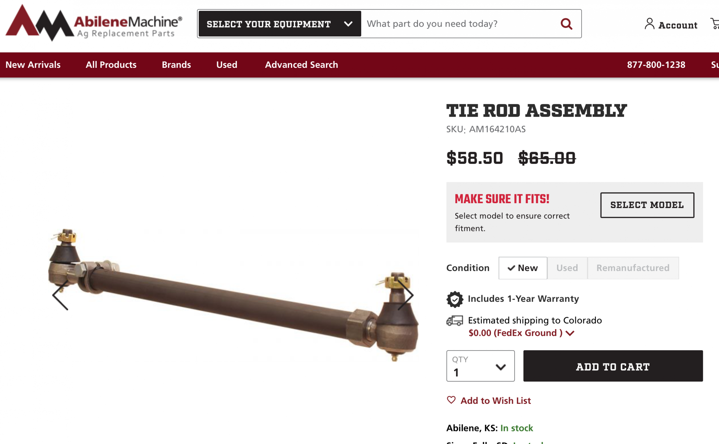

That's right. I believe what is confusing to the OP is simply that this part ought to be rebuildable and is not.
Normal construction for a tie rod involves making the ends and dust covers all independently replaceable with standard parts. And length adjustable. Kubota didn't do it that way. They welded it all together.
But there is no reason in the world why anyone can not adapt or fabricate something of better quality.
BTW, the OEM part also appears to be missing the necessary grease zerks on the ball joint. They were also missing on our M59.
Use a needle injector on your grease gun to put a squirt of grease into the dust cap every year of so and the next ball joints won't wear out so fast.

Yes thank you for that info! Making one better like what you posted above might be best and easier.

/ Steering linkage (bushing?) #9
Looks like a new drag link 32400-45610 is needed.

Don't know if it has been mentioned. The rod end is not a simple unbolt. It is pressed into the connection by the castle nut on the other side. It is a tapered fit. You will probably need a tie rod spreader fork and hammer to pull it out. When you install the new part, tightening the new castle nut will press the new part into place.
It is surprising that one end is not a adjustable. But Kubota probably sees that as an safety issue.
Also, I noticed you called it wobbly.
If the ball joint on each end has NO PLAY it is safe and will be fine. The rubber is to hold grease in the joint. It will wear faster after the rubber does no hold grease.
However, if the ball joint has ANY PLAY at either end, repair is needed and should be replaced.
If you put you hand around each part of the ball joint and have someone turn the steering wheel, you can feel if there is play.

Thanks for the info. Yes, the entire bar wobbles
/ Steering linkage (bushing?) #12
You can apply new ball joints to your bar. But you will first need to detetmine the stud taper and come up with a way to drill and tap the link. You may want to weld on an appropriate threaded sleeve instead of tapping. Don't know what equipment or skills you have at your disposal.
