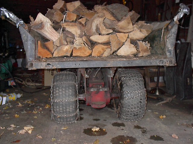

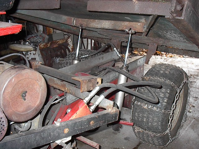

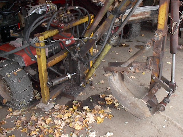

Yep, if ya look close just in front of rear wheel ya see the silver hyd. cyl. (one on each side) that raises the box. When the box (5' x 5') is full of dirt over the side extensions ya gotta remember to remove the tailgate or ya get one heck of a ride up in the air. Yep, seen the real dumps (triaxles) do the same thing.

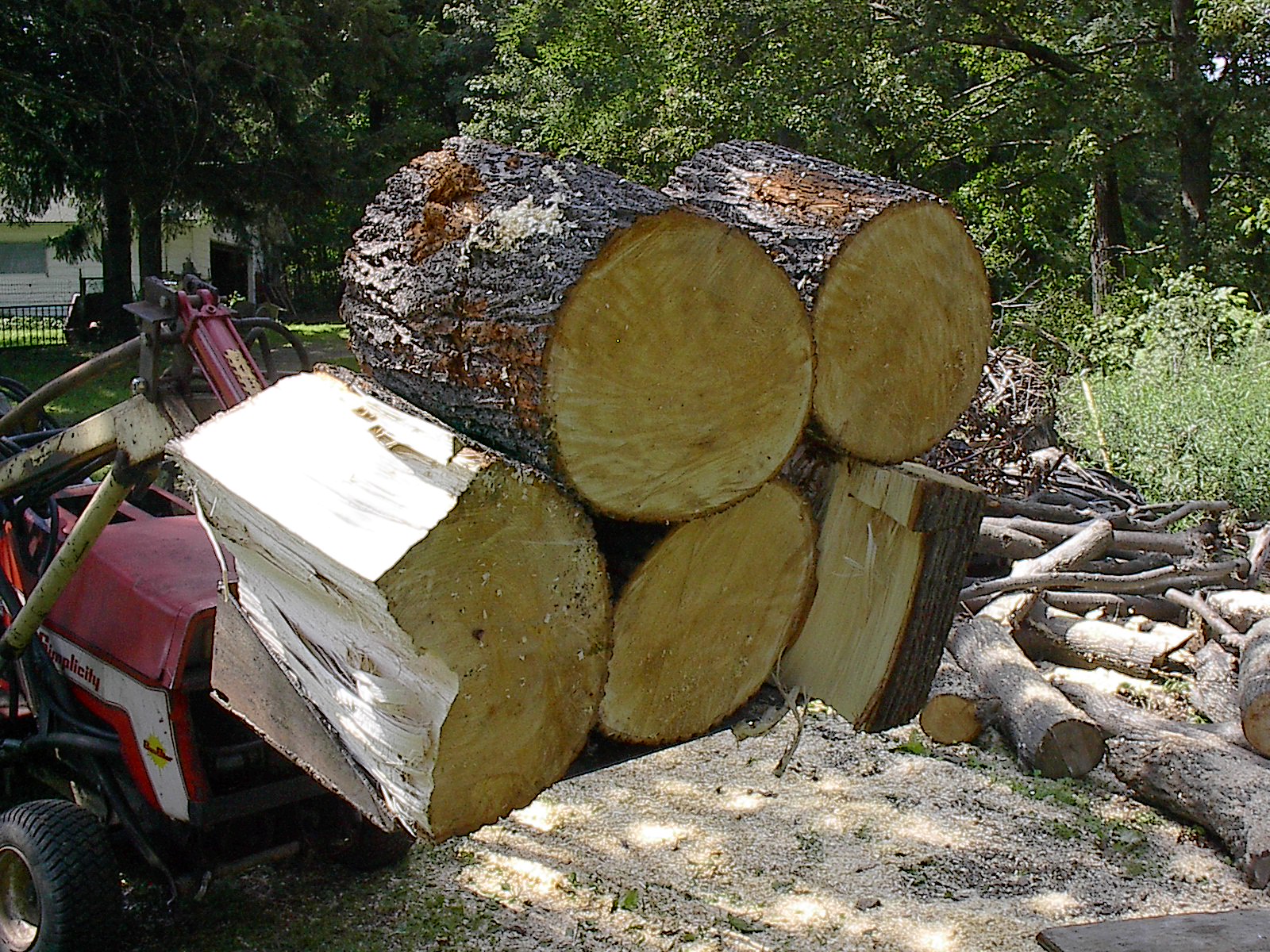

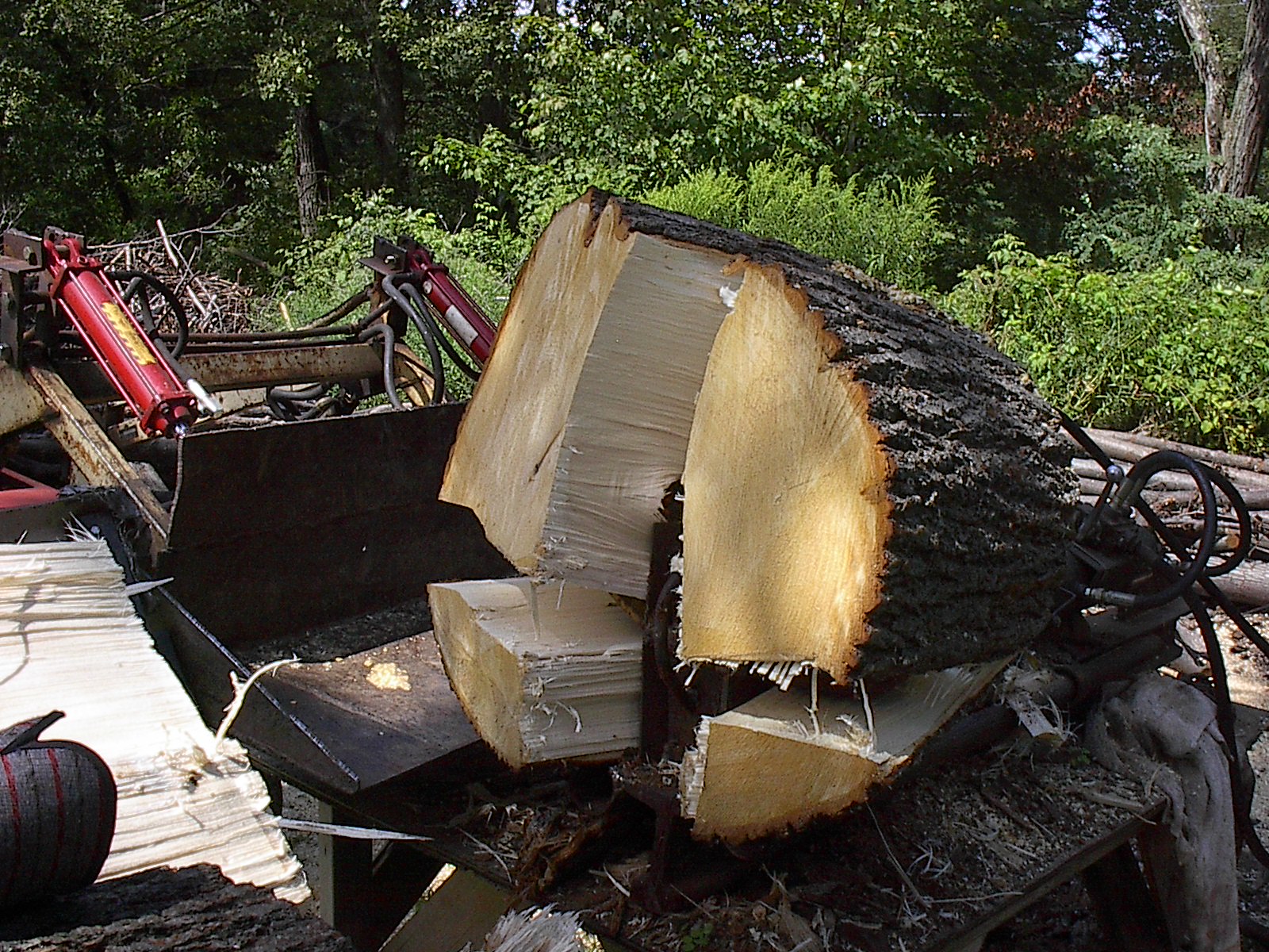

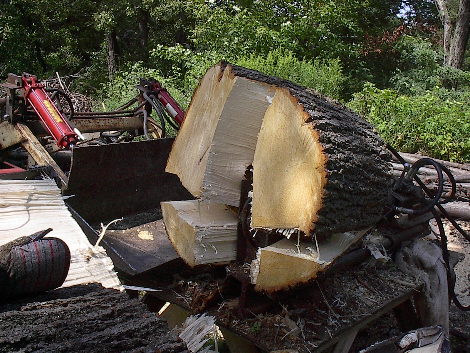

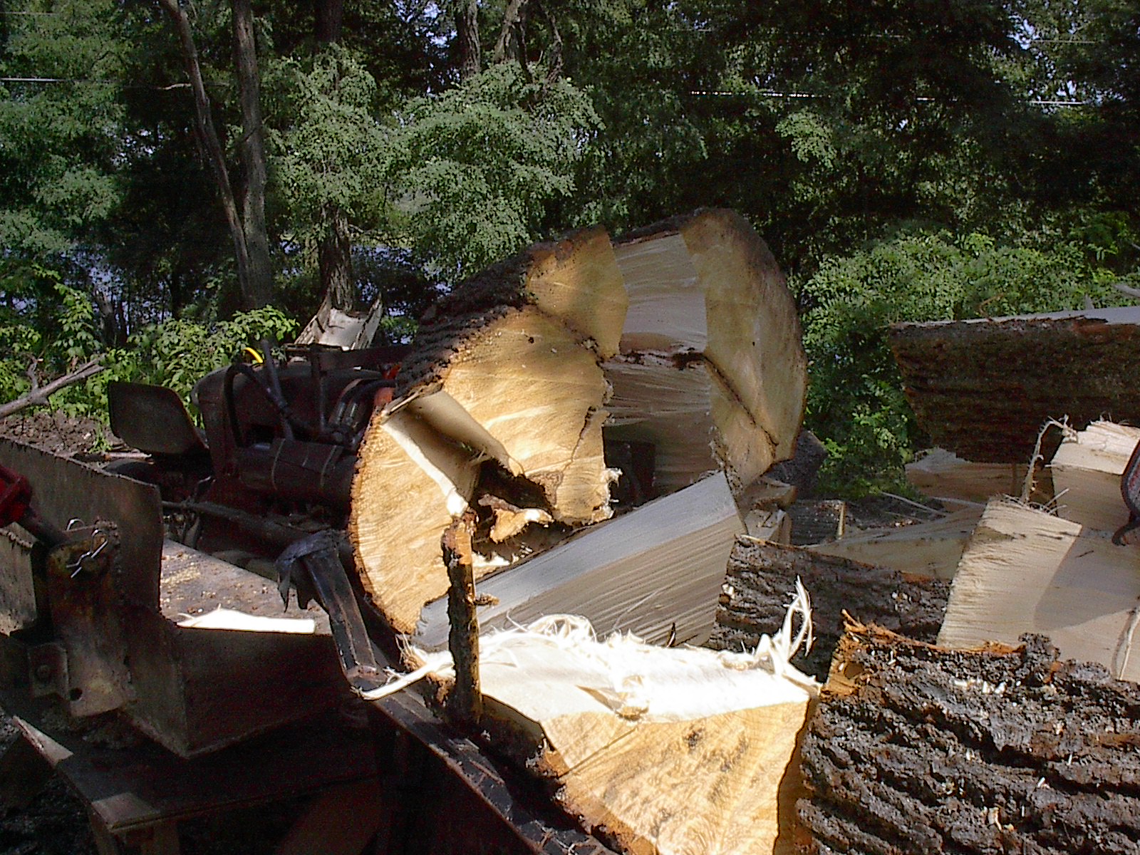

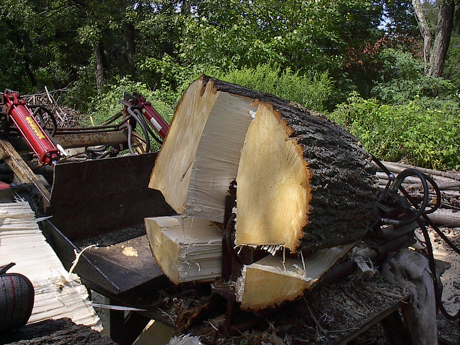

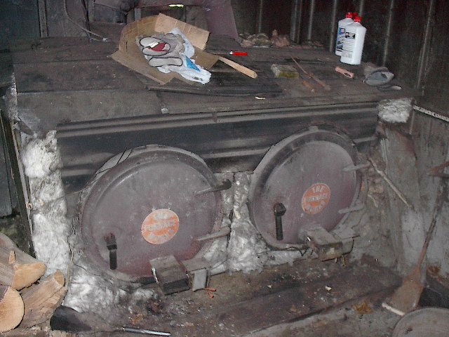

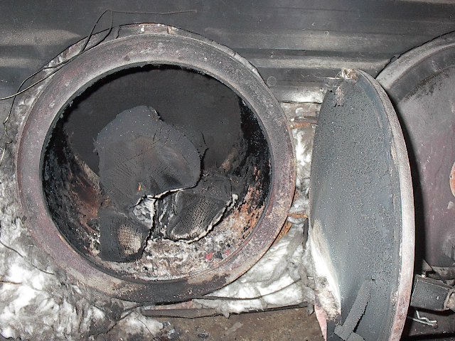

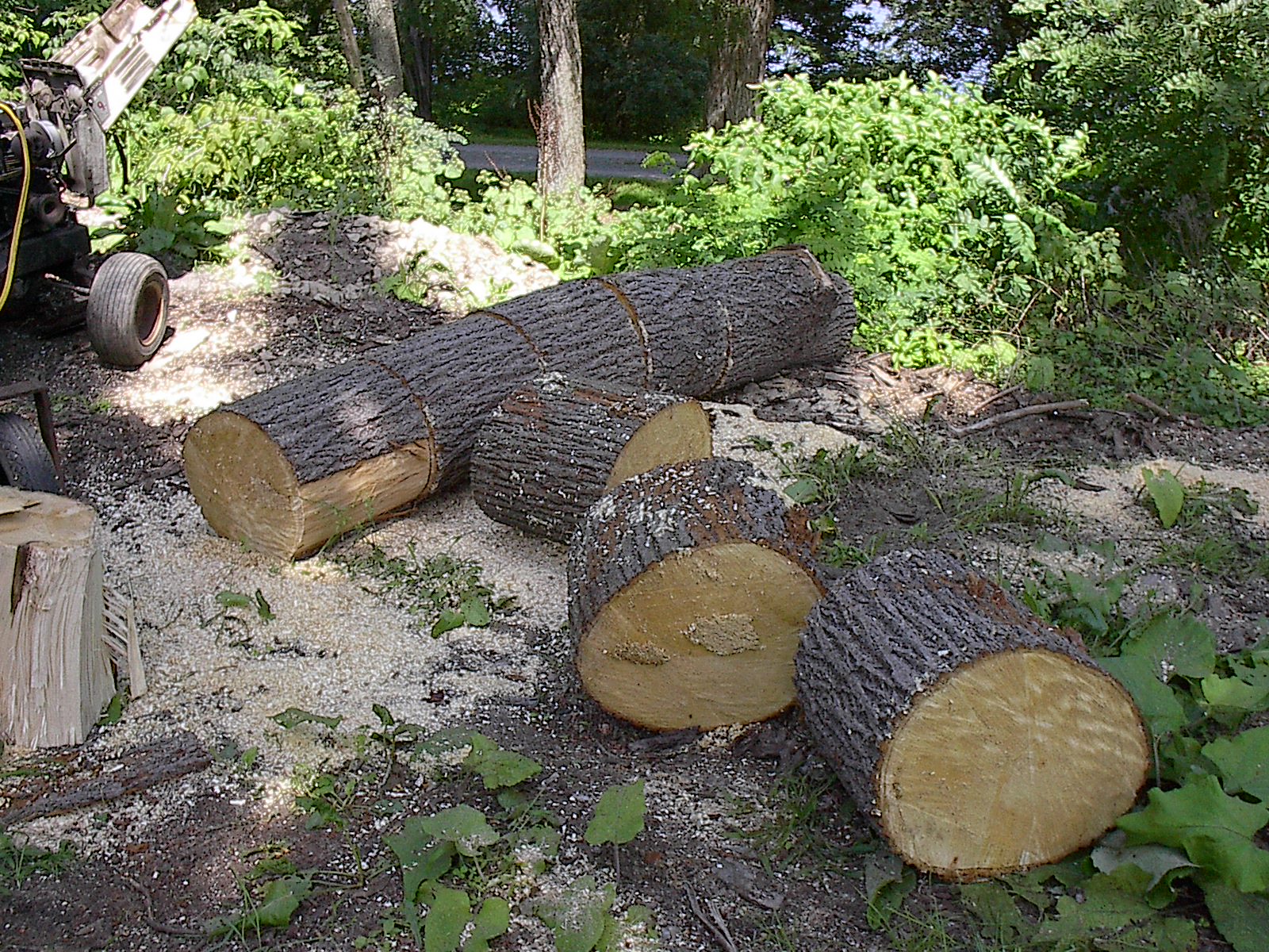

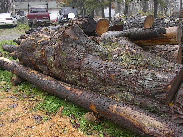

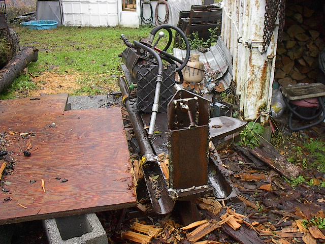

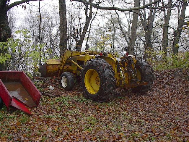

Just found these pics, so here they are... The loader bucket is 49" wide for reference. Started splitting some really gnarly stuff 30" or larger and had to take 1 wing off, actually broke off, so now it is a 3 way splitter, still much faster than 2 way. If a bad piece, means cutting through a big knot, I use one wing and just chop it. Another change from last year is table deck is now same height as splitter rail. Don't know if ya can see but unique push plate with guide rails so side forces are eliminated or reduced to null. Before that change would just twist main "I" beam/RR rail. Logger that supplies my logs just keeps shaking his head when seeing the stuff I want. One log was so big he had trouble moving it out from loader. His comment "you asked for it" and I just laughed. Will try to get a pic of that baby before it is all cut up. Installed outside boilers way back in '74 and last year one had to be rebuilt. Now find one of these new outside "open loop" boilers that will last that long. Had to weld the thing myself because my 2 boilers are closed loop. Welders told me I had bombs and would not touch that. Yeah, right, and every one who has a hot water heater too. Now, how many check their blow off valves? Well mine are at 30 pounds and work fine as I run about 12-15 pounds and both boilers also have a solder plug at top so if overheat they melt out and spray water into boiler. Yep, burned coal about 18 years ago and found that does work. Never blew the pop offs but melted the solder plugs, ???? strange but suspect that is why the boiler failed "prematurely". If any interested can get boiler pics and more log pics.

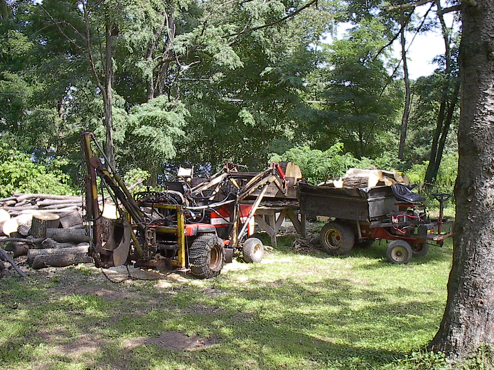

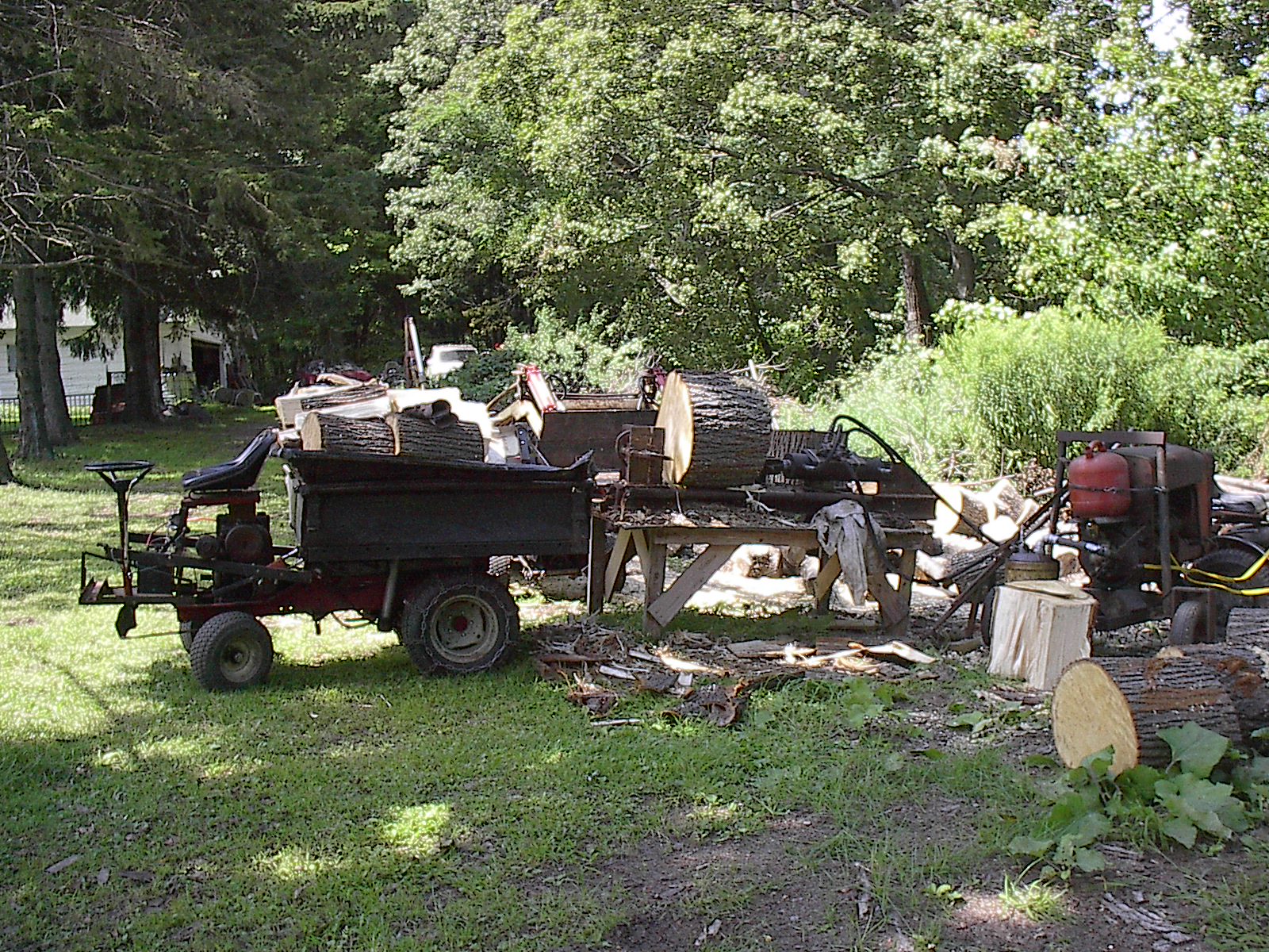

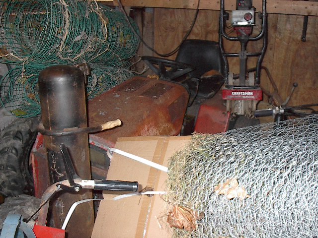

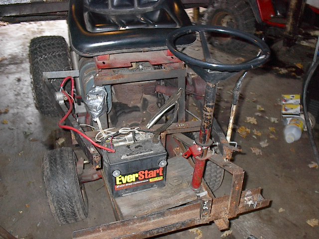

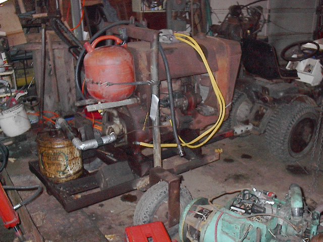

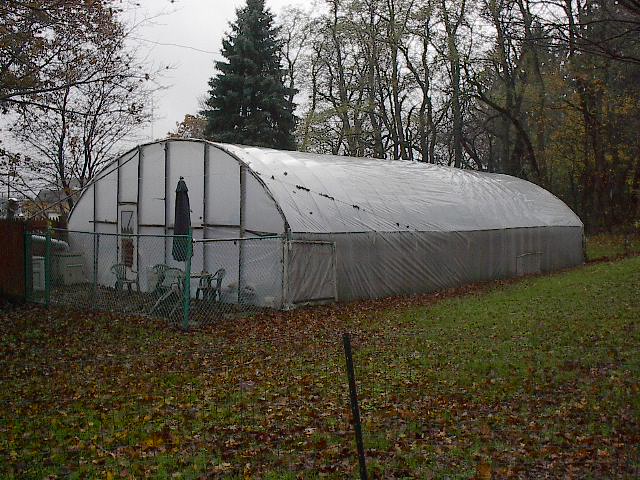

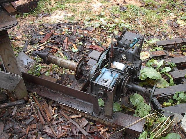

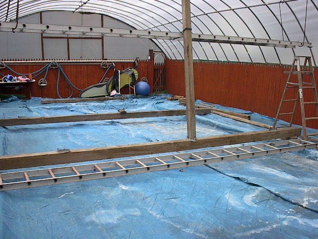

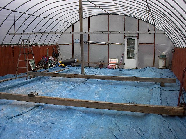

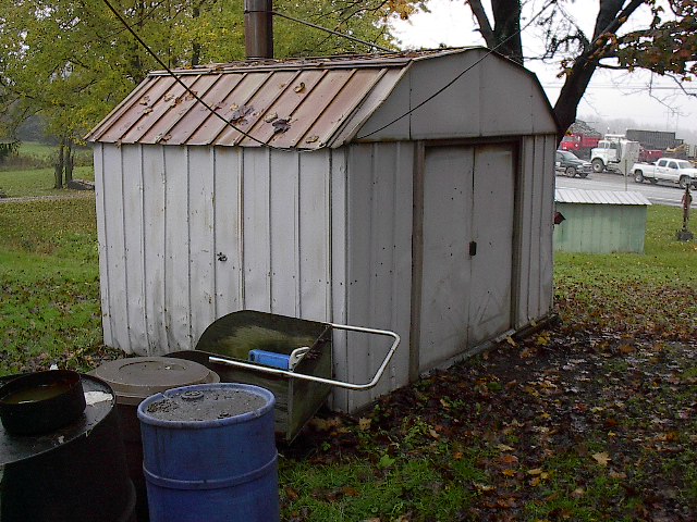

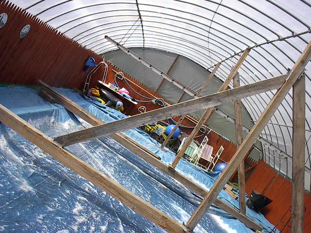

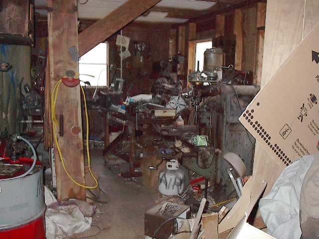

Here are more pics of cobbled stuff. Yes I can spell, main name is pun depicting cobbles. The 4 way became a 3 way when the gnarly stuff was too much to chop so one wing came off and now works fine. The screw splitter was the transmission for the baby backhoe in the '70's which saw many transitions to the simplicity sunstar. The 8th pic is spare parts shed with back up sunstar only a 20 instead of an 18. White building is boiler room with left boiler rebuilt in '10. The 9th-10th are baby dump truck made from old 1 wheel bumper trailer from the '40's originally on power unit trailer to 10 horse simplicity (screw-splitter remains) to cub cadet with extension for seat and original wheel base for maneuverability. The lift cylinders are from old convertible from fifties used to raise and lower cloth top. A second transmission could be easily added as output shaft present on cubs, but would be more difficult to maneuver. Other pics are depicting my stuff through the years including 30 x 50 pool house (not a green house) with beams for snow loads. Also, the 4 cylinder cub tractor engine hydraulic power unit for 3 way splitter. As I said b4, not pretty but made to work as keep getting older pushing 70 unless I can get dead.... Old age ain't what it is supposed to be, body fine, mind well, google Mahs2003 and click xanga one and see my life or lack thereof.... IF ya wanna know. (Moderators can yank this or I can if inappropriate.) IM006897.JPGIM006898.JPGIM006899.JPGIM006900.JPGIM006901.JPGIM006902.JPGIM006903.JPGIM006904.JPGIM006905.JPGIM006906.JPGIM006907.JPGIM006908.JPGIM006909.JPGIM006910.JPGIM006911.JPGIM006912.JPGIM006913.JPGIM006874.JPG
   / SteelCobler
#13
Would be interested in anyone who has made a unit like the dump truck and added a second or third axle. When I did (floater) and when loaded would only go straight. I had to pull it (the front) where I was going with baby backhoe 18hp simplicity. The real triaxles have the same problem in mud and snow, just want to go straight. Same with tri-axle tractors if pulling very heavy trailers especially on wet concrete highways and left or right angle turns.. Trying to figure a way to raise middle section (axle) for turning, but would defeat the whole idea. When that box 5 x 5 and sides to 6 x 6 filled heaping (over 3 feet) with load it is very heavy. Must be close to a yard of dirt, stone etc. Also, very top heavy. Has been flipped many times through the years sideways and over back, so far never over front. When overloaded I walk along side as shown by shift lever and steering offset. I have considered dual rear wheels but have not figured out how to support outer wheel and outboard axle so do not break main axle. I do not think axle would take that, I know with farm tractors they leave the outer tires a little lower on air pressure. Ideas?
