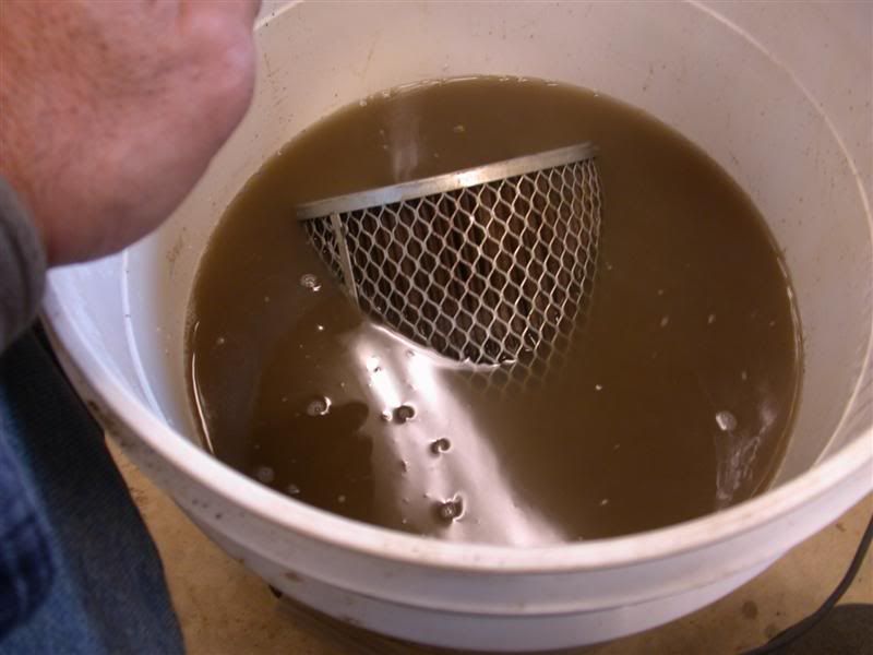

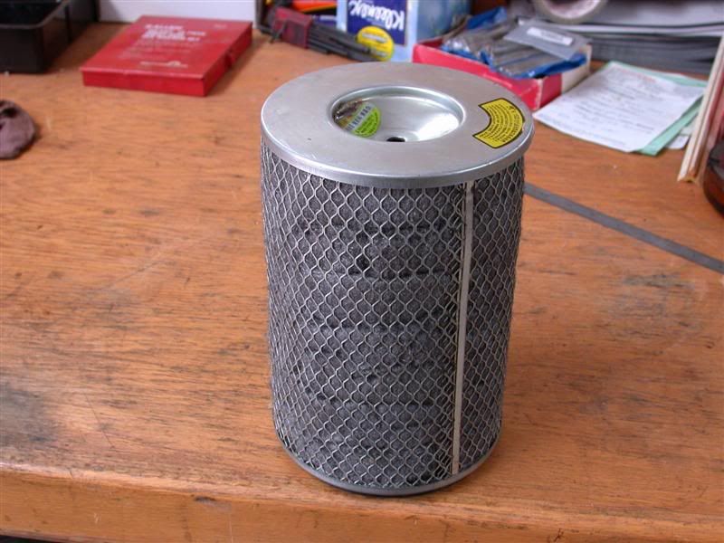

I tried to wash out the paper element and dry it out, but the paper clumped together and the filter was destroyed.
I had bought spares from Chip at Artrac and they are pretty expensive to replace. In fact, I just ordered another spare filter. Anyway, after ruining the paper filter, I went retro and removed the paper element. I bought some 000 steel wool and jammed it into the air filter case pretty tightly. Then glued the filter ends back together again with an oil resistant RTV material. I did this when I had just over 600 hours and now I have nearly 630 hours on the Kama. It seems to be working pretty good. The oil vapors from the breather lubricate the steel wool making collection of debris sort of like the old oil bath air filters.

I am scared more by a nasty air filter than black as soot oil. I would probably just pay the money for the paper air filters versus taking a chance on giving your engine a home made boring job. I feel as though the incoming air is critcal to the life of an engine. If the steel wool is letting dirt get by it that is not good.

I've always followed the precept that diesel engine longevity is directly proportional to the cleanliness of the air/fuel/oil it's fed. And that diesel engines appreciate cleanliness more than their gasoline counterparts.
That said, there are automotive air filters out now with porosity in the 0.3 to 0.5 micron range. Compared to that, I think you could drive a small ship through steel wool

Are there any materials I can wrap around the steel wool, but inside the steel grate? I want to make this filter rinsable/washable and re-usable.
/ Steel Wool Filter for Kama 554 #11
Rob,
It looks just like my Donaldson (on one end anyway).
For the price, you could just remove the plastic fan.
The Donaldson filters are washable, but kinda pricey.

That's sort of what I was intending except using steel wool and the oil vapors from the breather exhaust. What's odd is that Brad's 554 came with the oil bath filter and mine has the paper filter.
Which one is a better filtering system?
