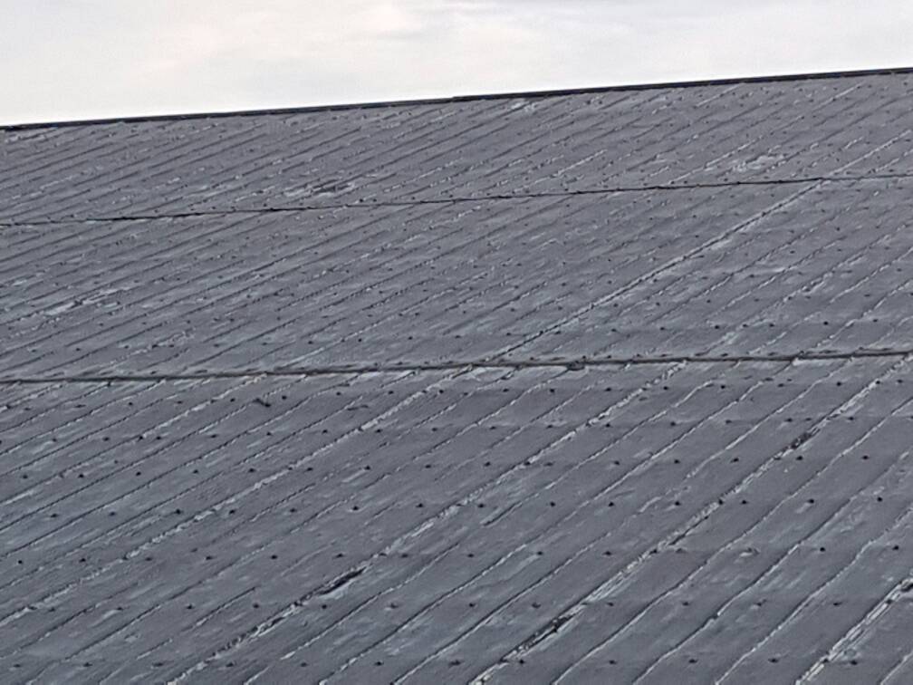

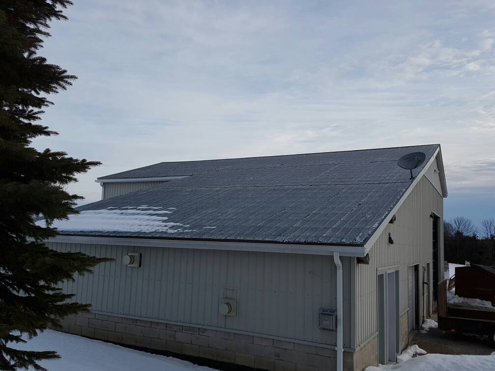

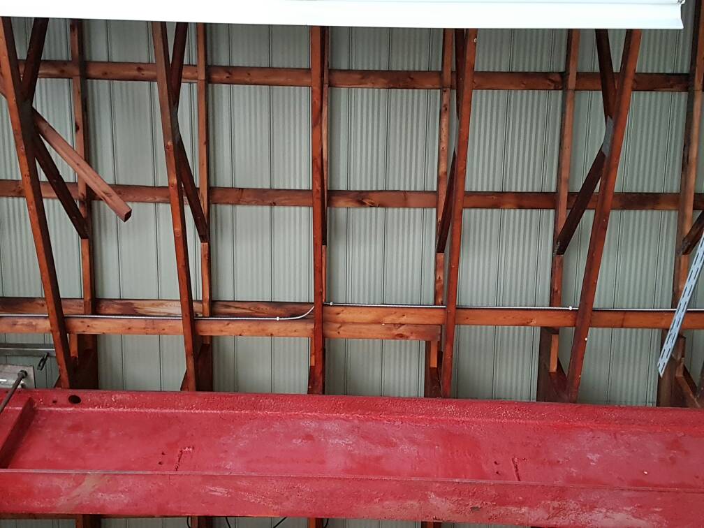

Having a problem with my existing metal building. It's slab on grade with concrete block knee walls and stick frame interior with metal siding and roof. The area with the large drive up door is my warehouse. Where the small roll up door is is where my tractor goes and the man door is a fireplace showroom. I have Heating in all 3 but only use it in the tractor area and showroom. The warehouse area needs to be insulated. Problem is I have roof leaks at the metal seams on the tin roof. It's wrecking the ceiling in my showroom and I don't want to proceed with insulating the warehouse area until I solve this issue. What are my options for fixing the leak? I have a friend that does metal roofing he tells me the only way is to pull the tin off the roof put down sheathing and ice sheild and put the tin back down. Right now it's just the tin screw-down to the cross bracingView attachment 499531 . Does anyone out there have any experience with this type of situation or any other ideas?
ATTACH]499528[/ATTACH]View attachment 499529View attachment 499530
Looking at your pictures and ignoring your denial about condensation, I notice the massive amount of staining on your purlins. This is very common in metal buildings without enough venting. Do you have any venting from your soffits to your peak? If there is no air flow along the underside of your metal, condensation will form almost every morning. You might never notice it, especially if you do not have a lot of humidity, but it's there and the proof is on your purlins. To stop the condensation, you either need to create more air flow, or insulate with closed cell foam. Only use closed cell. Open cell is cheaper,has a lower R value for the same thickness, and it absorbs water, which will speed up the deterioration of your metal.
Another option for dealing with condensation is removing the metal, installing OSB and putting roofing paper or some other membrane down that will catch the very small amount of condensation that forms every morning. Most of the time the amount of moisture formed is minimal and you never notice it. Other times you can actually see the water coming off the roof, under the metal and over the paper.
Since your building was built in the 80's, I would guess that the rubber seals on your screws are bad. The 80's where probably the very worse decade for home building materials. The EPA was just getting started and making changes so quickly that manufactures had to keep changing what they where producing. Rubber, glue, paint and plastic where all hit really bad. I don't trust anything built in the 80's.
Please post a close up picture of your screws that show the condition of the rubber gaskets. Are they plump looking, or flat and crushed? Are they cracked or damaged? On a metal roof, the rubber seals on the screws are where most leaks happen.
Please don't fix one thing and ignore another because you don't want to believe there is more then one thing wrong with your roof.
