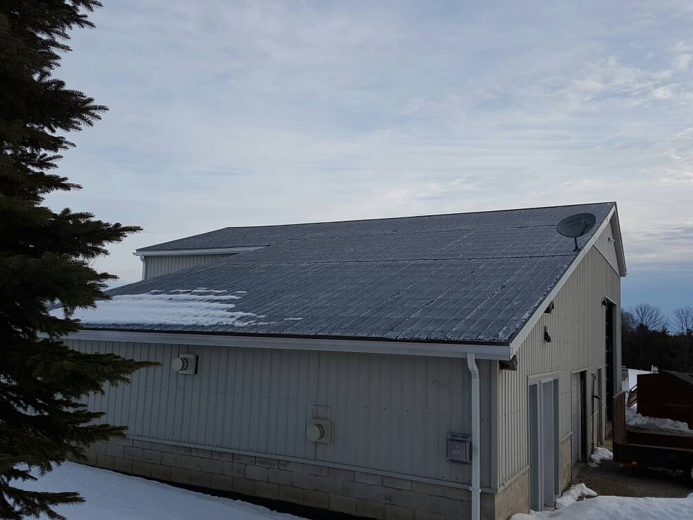

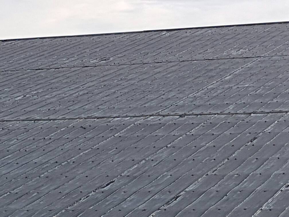

Having a problem with my existing metal building. It's slab on grade with concrete block knee walls and stick frame interior with metal siding and roof. The area with the large drive up door is my warehouse. Where the small roll up door is is where my tractor goes and the man door is a fireplace showroom. I have Heating in all 3 but only use it in the tractor area and showroom. The warehouse area needs to be insulated. Problem is I have roof leaks at the metal seams on the tin roof. It's wrecking the ceiling in my showroom and I don't want to proceed with insulating the warehouse area until I solve this issue. What are my options for fixing the leak? I have a friend that does metal roofing he tells me the only way is to pull the tin off the roof put down sheathing and ice sheild and put the tin back down. Right now it's just the tin screw-down to the cross bracingView attachment 499531 . Does anyone out there have any experience with this type of situation or any other ideas?
ATTACH]499528[/ATTACH]View attachment 499529View attachment 499530
How old is your building/roof?
In one of your pictures, it appears that the steel on your roof is in poor condition.
Before being concerned about condensation, and/or insulation, it would be best to determine the condition of the steel on your roof.
The building was built in 1984. I am not worried about condensation. It's definitely a leak I can visually see when raining at a few seems.

Is it clear this is a leak rather than just condensation??? Two very different solutions...
Yes it's a leak for sure. I think people are getting confused with another posters similar problem. I can visually see the water comes in when it rains a few different seems. I have no water in the building other than when it rains or snow is melting on the roof.
