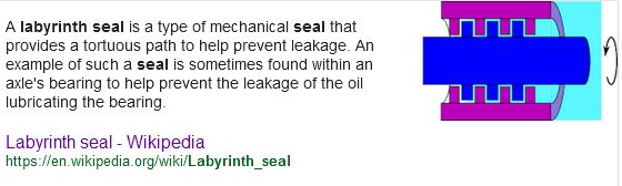

They are correct. Air doesn't like changing directions and any bends that causes a direction change of air flow forms a partial seal that's known as a Labyrinth Seal.
They did a good job.
