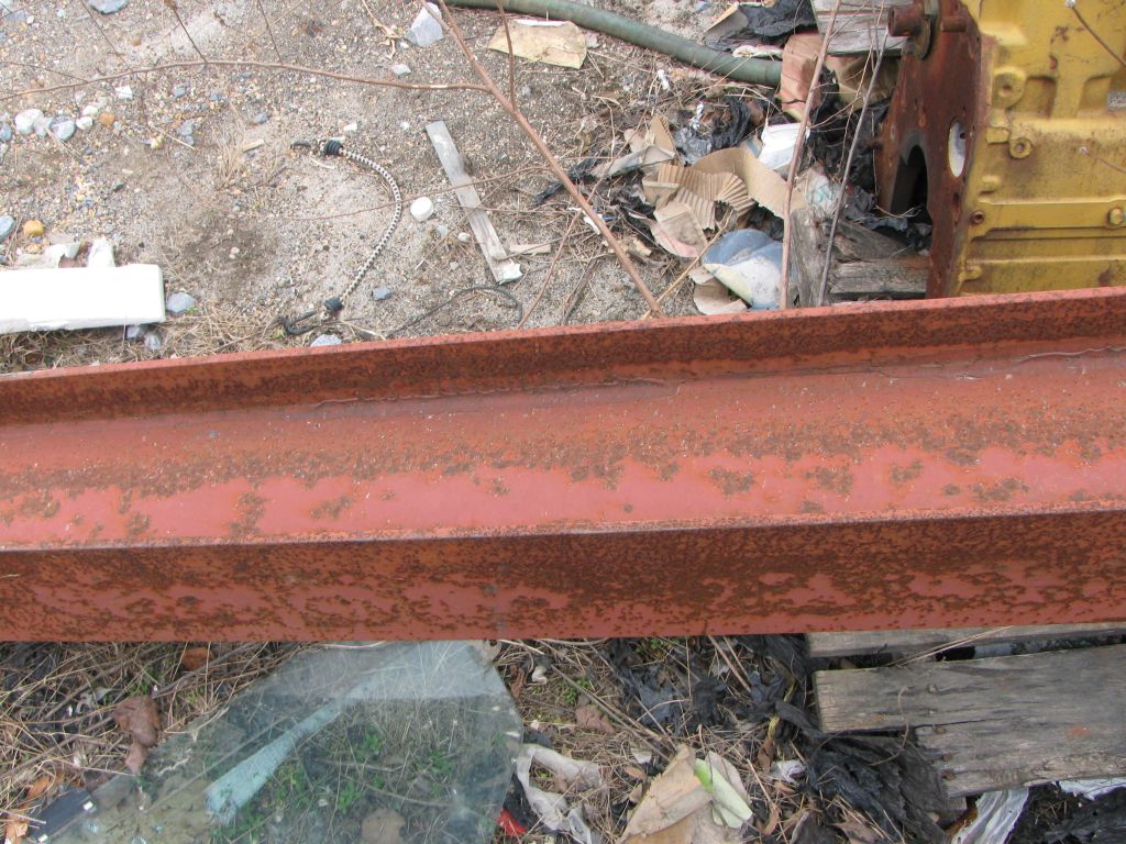

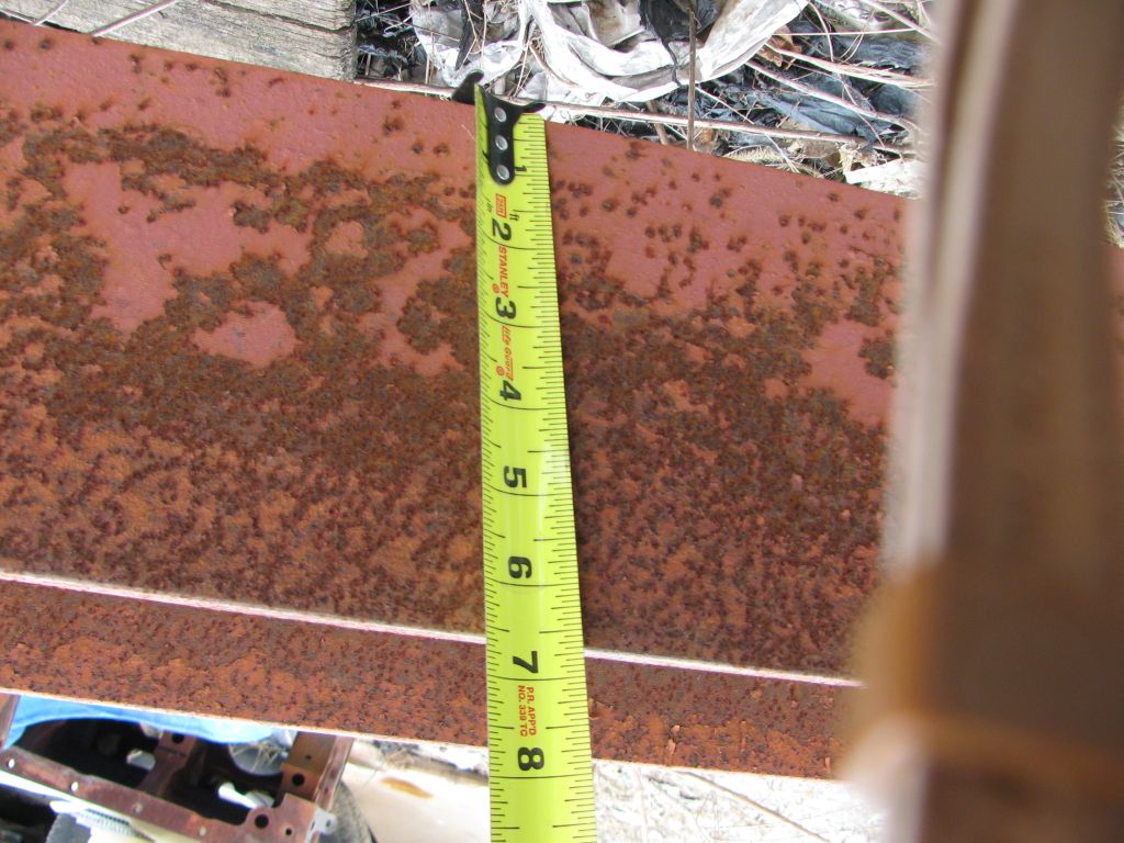

I'm starting to scrounge parts for my next project, a log splitter. I found this peice of steel I can have for free, do you all think it will be heavy enough for a 25 or so ton unit? I may stop by home cheapo and look at the steel they use, but wonder if 8"x6.5" would work. It is 3/8" think. Here are a few shots.
Thanks!

I am doing the same thing . Northern hyd has a cylinder kit 5 inch cylinder load 44000 # or so . They say use 6 WF 25# beam thats means 25# per foot. The beam measures 6.08 wide 6.3 high the flange is .456 thick and the web is.320 thick all numbers are inches . If that would work I think yours would work.
I just looked at your pictures. I think the flanges may want to be a little thicker. but I bet it would work anyway.

From the measurements in your post, that is a W8x24. A W8x24 has almost 60% more bending capacity (section modulus) than a W6x25. The flanges are slightly thinner than the W6x25, so take that into consideration for your splitter sled. Other than that, it's a good find.
Good luck.

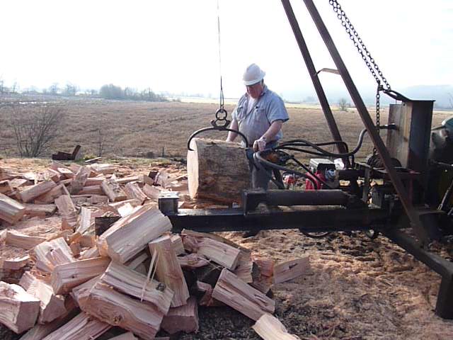

Here is what ours looks like.
My Dad built one like that over 30 years ago, but it disappeared one night when it was left in the bush. Apparently, we did not disguise it well enough.
But if you use that as the base, you will be fine.
