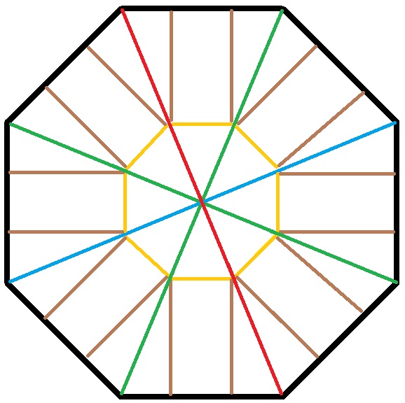

So I'm thinking of building a gazebo next summer. It'll be a 14' octagon about 8' off of the ground. I'm going to use steel tube on top of cement tube footings. There's going to be white lattice around the base and I'll use the space to store firewood. All the weight from the gazebo structure will rest directly on the steel posts. My question is about the sub floor. I was thinking of using C channel. Te flooring will be Tigerwood (to match my deck) and can span up to 24" between joists. This picture is kind of rough but it gives an idea how I was planning on laying out the c channels. The load this should see would be maybe 3000 lbs (12 people and the weight of decking) spread across the entire deck. My local steel supplier can answer basic questions about deflection but this is out of his comfort zone. Each side would be approx 6' and also would be c channel. This, of course, will be welded together. Only one channel will be a solid piece (it could be a S beam) but the rest would weld to it. I'm planning on welding a plate to the bottom of the beams where the joints are. So what size c channel would be needed?

How far is the sub floor going to be above grade?
Most people would design the floor of the gazebo to the same criteria as a deck, which would be about 100 lb/square foot in most jurisdictions.
If it were a 14' square, it would have 196 sq feet of area, and I would design for a 20,000 lb load. This is a lot more than the 3000 lb load you are thinking about.
While I like the idea of the joist structure you show, it is not particularly easy to calculate. I would think long and hard about a more conventional framing plan with joists on 16" centers, which would be a lot easier for the average engineer to understand and calculate.

Yeah, I have to agree -- what you're proposing would take Finite Element Analysis on a computer to figure loads and size the members. Try to simplify it if you can. And why are you building out of steel? Gazebos are easily made from PT lumber. Built a few dozen myself.

Pretty design, but not very practical. With only a 14 foot span, I would build three beams and run your joists on top of the beams. This gives your joists a 7 foot span, which makes it very strong

I agree, you are over complicating the joists.
And even so, it is impossible for anyone to calculate that out because you did not say where the posts are going to go, and how many of them, etc.
I am "assuming" one post at each point of the octagon? But I dont like to make assumptions then give bad advise based off a wrong assumption

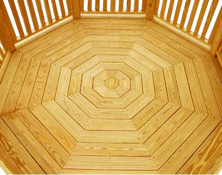

The reason joists are run that way in a gazebo is to allow the decking to be placed in a pattern, picture it as 8 triangles, whose points are at the center.

put a support in the center of the floor joist and your problems are solved, the max span then is 7 foot,
for the floor, just run the joist across the unit at the desired spacing and do not worry about the fancy web type construction, much like this picture, http://www.diyonline.com/graphics/gaz-fig6.gif
unless your desire if for a fancy pattern in the floor planks,
That makes sense why you want the fancy joists now.
I may try to do some load figuring.
However, as nice as that design looks, I dont like it for practical reasons. When I build a deck, I try not to have ANYWHERE on the deck where 2 boards are butting up. Cause over time, as things change, they never seem to line up and cause trip hazards. I like full length deck boards.
IE: IF I was doing a full length of the house deck, like say an 8'x40' or a 12' x 40', my joists run the long span, and deck boards will run the short span as to not have any butt ends meeting in the middle. Your design is going to create ALOT of that.

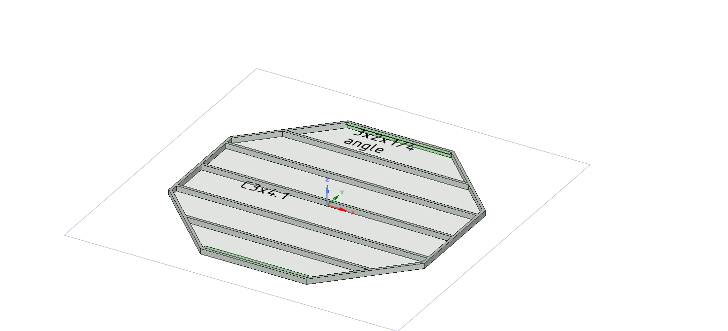

To do the joist pattern like you have designed, without a post in the middle, you are going to need a substantial carrier beam. Whatever one is the full 15.15' length.
And the design of all the other joists tying RIGHT into the CENTER of that beam, puts a point load right at midspan. A point load roughly 1/2 of the total load on the gazeebo deck.
I would not design for less than a 50psf live load and 10psf dead load.
162sq ft with 1/2 of that loading right on the midspan of the long beam @ 60PSF is 4860#. Lets just call it 5k.
So, you need a beam to span 15.15' and carry a load of 5k at midspan and not deflect more than 1/2" (L/360)
Minimum I see is a C9x13.4 channel. Could drop to a 8" with a C8x18.75 but gain more weight (and will cost more). And only way to get under 8" depth is with an Ibeam. S7x20 would work. But again, heavier and more $$$
I didnt figure any loading on the rest of the beams, as it isnt going to be too significant. But wanted to see if this is still what you are planning on doing.

If you wanted to do channel on 2' centers for the joists, like farmer2009 describes or like how I described with 2x10's
For steel channel it would require c5x6.7 at a minimum for the joists. If you want to do steel, this is how I would do it. Instead of a large beam in the middle, then 3 smaller ones on each side radiating out from the middle, then even smaller ones for the remainder of the bracing. Just seems way more complicated than it needs to be.

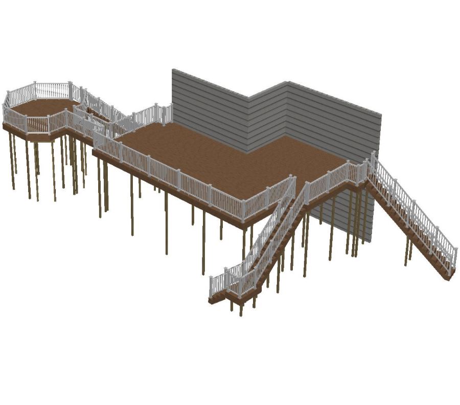

So here's a picture of what I have now. The wife has never liked the woodshed. I've seen much worse looking ones but since we both want a gazebo I thought I could move the shed and put it there. My plan is to have a bridge from the corner of the deck to the gazebo and also a set of stairs coming down towards where I took this picture from. The idea is to use the space under the gazebo to store firewood wrapped with lattice to hide the wood but allow plenty of air flow. The firewood would already be seasoned, no green would be stored under it. The shed is 12' wide and 8' deep and the opening is about 7' high.
I found a picture on the net that may give a better idea of what I'm looking to do. When I get a chance I'll use one of the on-line deck designers and do a layout. If possible I would like the floor of the deck to be at the same height as the gazebo floor, one step up would be acceptable. Because I would like to store wood under it I would like at least 6' between the floor for the firewood (this could just be wood simply laid on the ground and the bottom of the joists. A center post isn't out of the question but I figured I would see just what size channel was needed without a center post first. Also the location of the outside posts doesn't have to be exactly at the edge. But the posts will be carrying the load of the gazebo's walls and roof so they should be close, say within a foot. Otherwise I think it would be adding even more calculations to the load mix. Part of the reason I like the idea is because it's complicated. I knew figuring out would be more work but that just makes it more rewarding when you look at it. Anyone can do simple.

Those pictures help explain why you want what you do. I think it will look really nice. If that's all the bottom will be used for I wouldn't worry about the underneath and use the double layer to frame the floor and a center post.
With the bridge out to it you won't have to worry about access.
