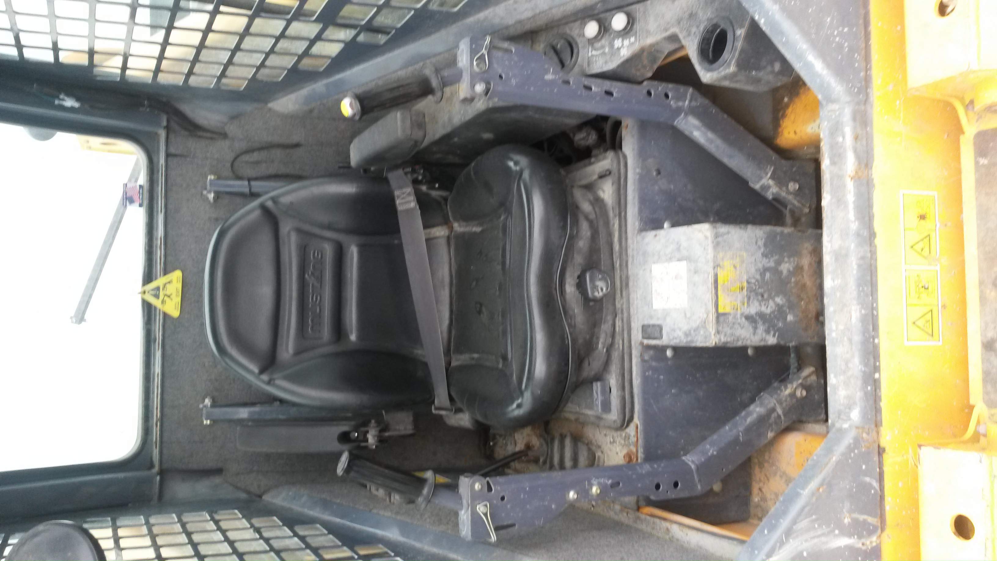

/ Starting problems Mustang 2054 Skid Steer
#9
Do anyone know anything about the wiring to the seat? Is it suposed to be any voltage on one of those wires?
I`ve checked the switch, and it is fine, but I dont get any voltage in any of the feeding wires..
