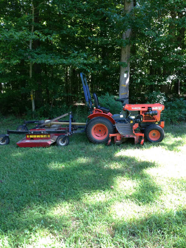

I had 10 acres with a house on it about 70 miles away from my house. About 6 acres are mowed and only about an acre around the house was anything that resembles smooth. I decided the L3240 was much more useful at home, and the riding mower couldn't handle the whole place by itself. I bought a B7100 with a MMM to mow there. It's sole purpose in life is to drag a MMM around. In which case I'm ok with a MMM, but I wouldn't have one on a tractor that does anything else. This thing isn't a bush hog, but it's much more robust than a regular riding mower. If I had a little bigger tractor I'd us my finish mower instead, but it's too much for the B7100. image-917185462.jpg I had a ZTR until it burned. On nice yards it was the weapon of choice, but isn't nearly as robust as the B7100 with a MMM, or my grandpas B7200 with a smaller finish mower. The B's also win on versatility, mud crossing, and going up or across hills. The ZTR has a low center of gravity and was stable, but you couldn't keep it on steep hills. Now it takes a pretty steep hill before I'd park the ZTR, but the B's are capable of more.
