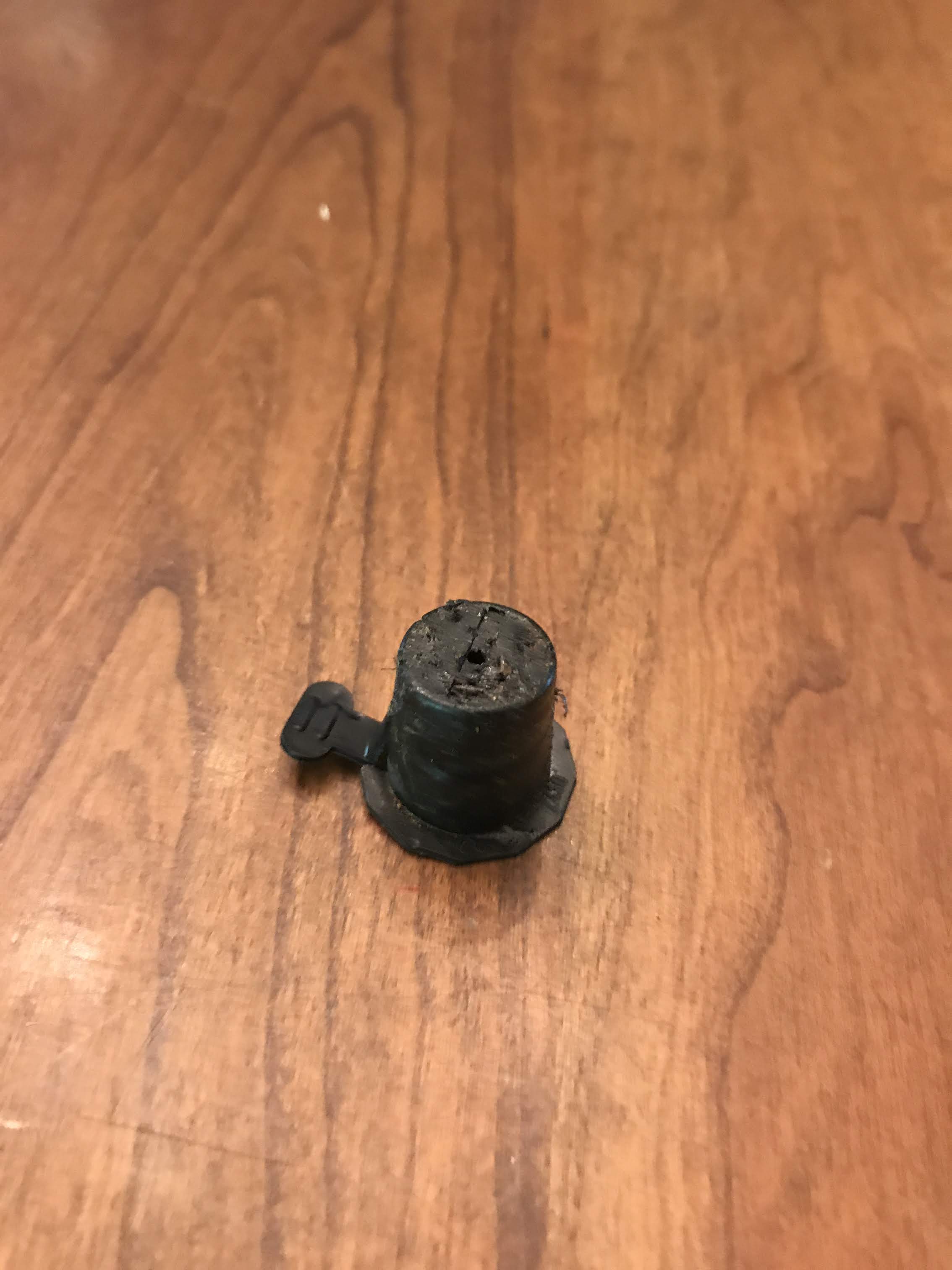

I would also take off where the negative cable connects to the frame and clean that up and then reattach it with the negative cable from the battery on the bottom so that it is the closest to the frame with the smaller terminals on top of it. That should give you the best possible connection for your negative terminal.

As soon as I disconnect the jumper cables, all the lights and gauges go dead. Tractor still runs fine but no electric features work.
I believe that suggest you have an electrical problem.
Start by checking all the connections at the battery and measure the voltage at the battery with the engine running fast idle. Report back.

You are misunderstanding me. I am saying, remove the bolt that holds the negative cable to the frame, clean around the hole and put it back together.

Are you guys sitting down? This is probably the most stupid mistake of my tractor life. I can't thank you all enough for helping me troubleshoot. I learned a lot. I especially learned how stupid I am. :duh:
Just remember when you're having trouble with your tractor and realize it's something simple, just say, "Well at least I'm not as mentally challenged as that guy who left the cap on his negative terminal."

Not the first time and won't be the last... Sorry I didn't catch that. Now that I look, I see that in your first picture...

Don't beat yourself up too much....we missed it too. At least you now have a huge, new, reliable battery.
