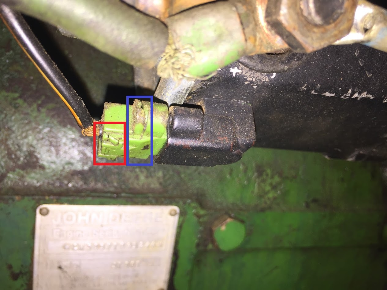

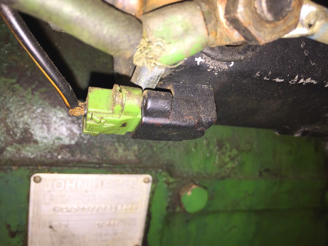

Can anyone identify the electrical connector in these pictures and recommend a source to purchase the connector from? I'm redoing the electrical wiring on my John Deere 1050 and this connector goes into the starter motor. It is in okay shape but I'd prefer to replace it with new with the new wiring. The John Deere parts catalog lists it as part of a wiring assembly that is $45... I would prefer not to pay that!
The starter part # is TY6716 and appears to be a Nippodenso and the connector that plugs into the starter is part of part # CH19283. It is key 5 in the attached John Deere parts diagram.

Can you post a picture of the place it connects to the starter? From your picture it looks almost like one could use a insulated ring terminal, a short piece of wire, and a covered insulated female spade connector.

Hey Aaron Z, thanks for the reply. I'll see if an insulated spade fits. Here's another picture of the connector plugged in... I'll try to get a picture of the connector on the starter side tomorrow.

If you gently pry on the two tabs in the red box, it should split on the line in the blue box and let you redo the wire (unless it is corroded, I would just put shrinktube over it, if its corroded, I would pry the crimp on the wire apart and replace the wire).
