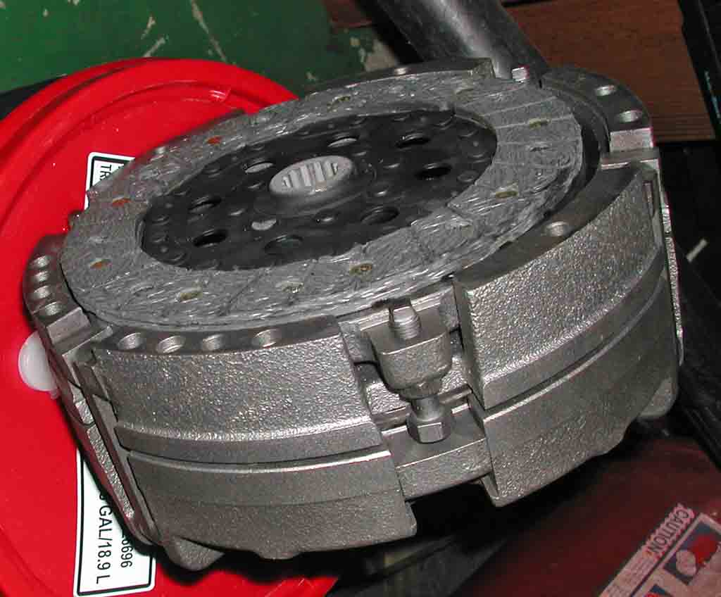

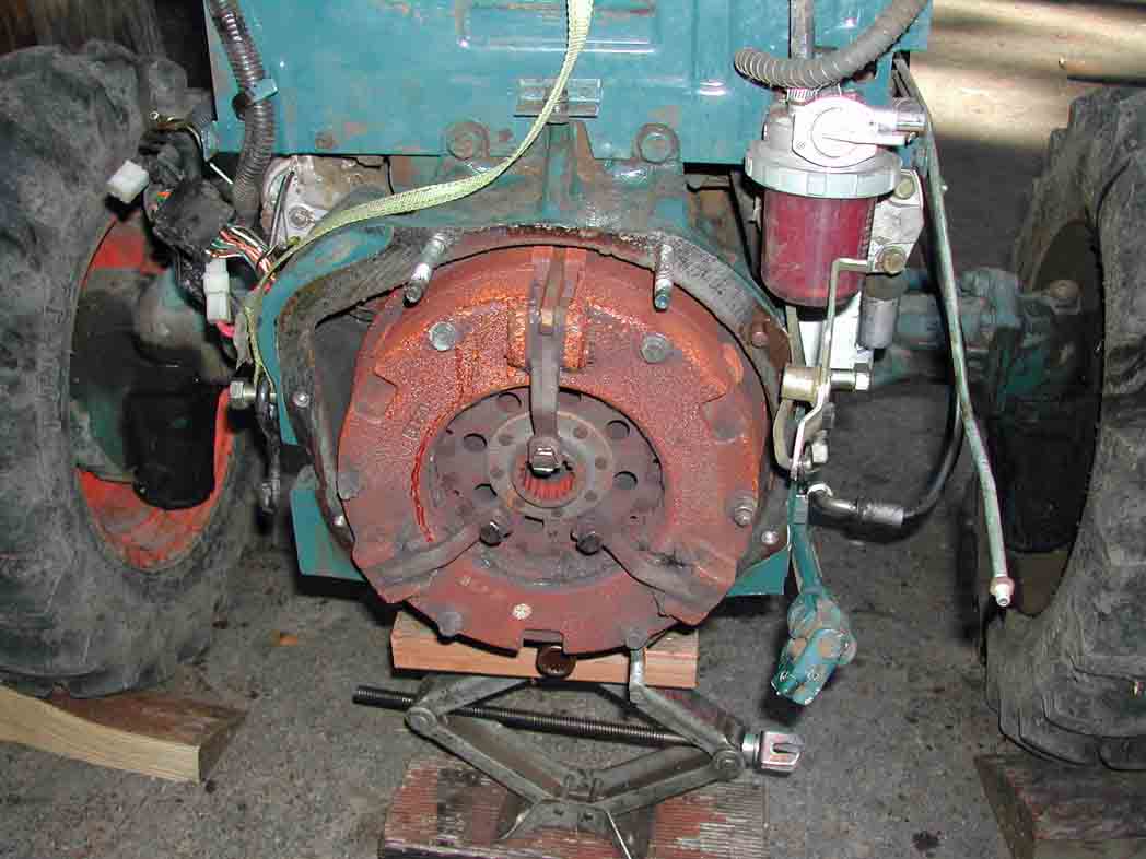

I have adjusted the 2nd clutch on a Kubot, and other brands probably provide for it similarly.
-- There is access to the adustment bolts thru a "window" cover on the housing as I recall. ... Once you find it, the most
important thing is to mark each bolt and turn each the same amount so the plate is lifted evenly.
I just fully rebuilt my first 2-stage dry clutch this last summer, but it was also on a Kubota. L2550DT. There IS a
window as you describe, to access and adjust the fingers for the PTO clutch. Unfortunately, it was underneath the
FEL subframe, which has to be removed.
In this situation, the road clutch was burnt out, but the PTO clutch was pristine. The PTO clutch can be stuck to
the pressure plate independent of the road clutch. I had a shop set up the new clutches and fingers to spec
in their shop. It cost $600 for the shop part of the rebuild, which was a shock. I did all the splitting and
assembly/reassembly of the tractor myself.
/ Start engine with PTO engaged #57
The PTO clutch can be stuck to the pressure plate independent of the road clutch.
That's the answer to the question I asked earlier in the thread.
I couldn't see a reason that that wasn't possible.
Weird! Exact same tractor w/factory FEL and I did the adjustment with no removal. It was very difficult because I was working with a hurt rt shoulder ... some whimpering - but successful. :dance1:
/ Start engine with PTO engaged #59
Note that the $600 was to put new friction material on both friction discs, and re-surface all mating
surfaces, incl the flywheel. Clean and adjust everything to spec.
In the OP's case, I would hope to be able to adjust the PTO clutch thru the window (if provided) and NOT
split the tractor.
