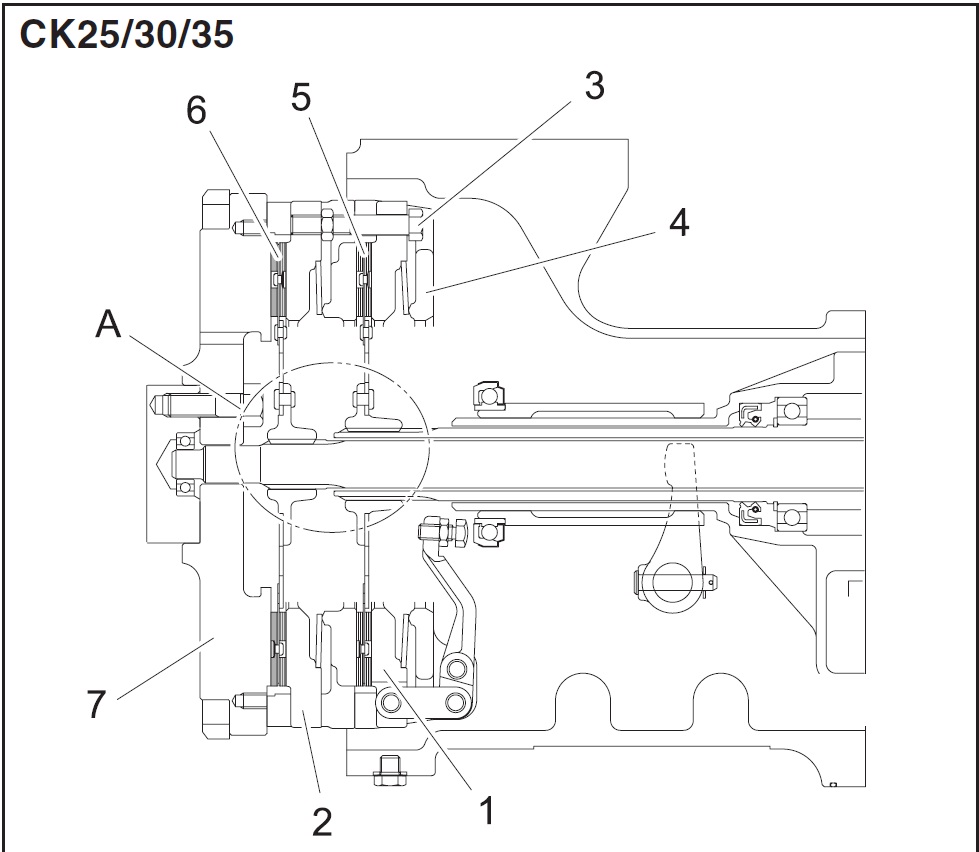

There is no mention of the window in the manuals, which are for the CK25/30/35
series. Probably isn't one.
Yeah, I sure don't see a window, Tony. Of course, the manual is not very good, and my own CK30 is
an HST with single clutch, according to the CK25/30 parts book.
/ Start engine with PTO engaged #63
Yeah, mine too, but the clutch section is the same, I read over it, no mention of any window anywhere. It details how to adjust the stop, pedal, and switch, then goes into splitting the tractor. Everything else is once the thing is opened up. I do have my doubts about a manual for 6 different tractors, but then it is 400+ pages.
/ Start engine with PTO engaged #64
You have the LK which is different from the CK obviously. My manual is pretty good, with step by step instructions for splitting the tractor and then making all adjustments and replacements, complete with halfway decent pictures.
Yes service manual has detail on split but not so much other than pedal free play for clutch adjustment. Hate the thought of splitting tractor to adjust clutch.

Just FYI. I adjusted my clutch and it is working like a charm. Real easy to adjust and now works like it should. I can say a trip to the dealer made it much easier than trying to read the manual. The mechanic walked out to a new one, pointed to the spot and said just loosen this and adjust it here.

Attaboy. Glad you took the advice from post 9 (and 39).
