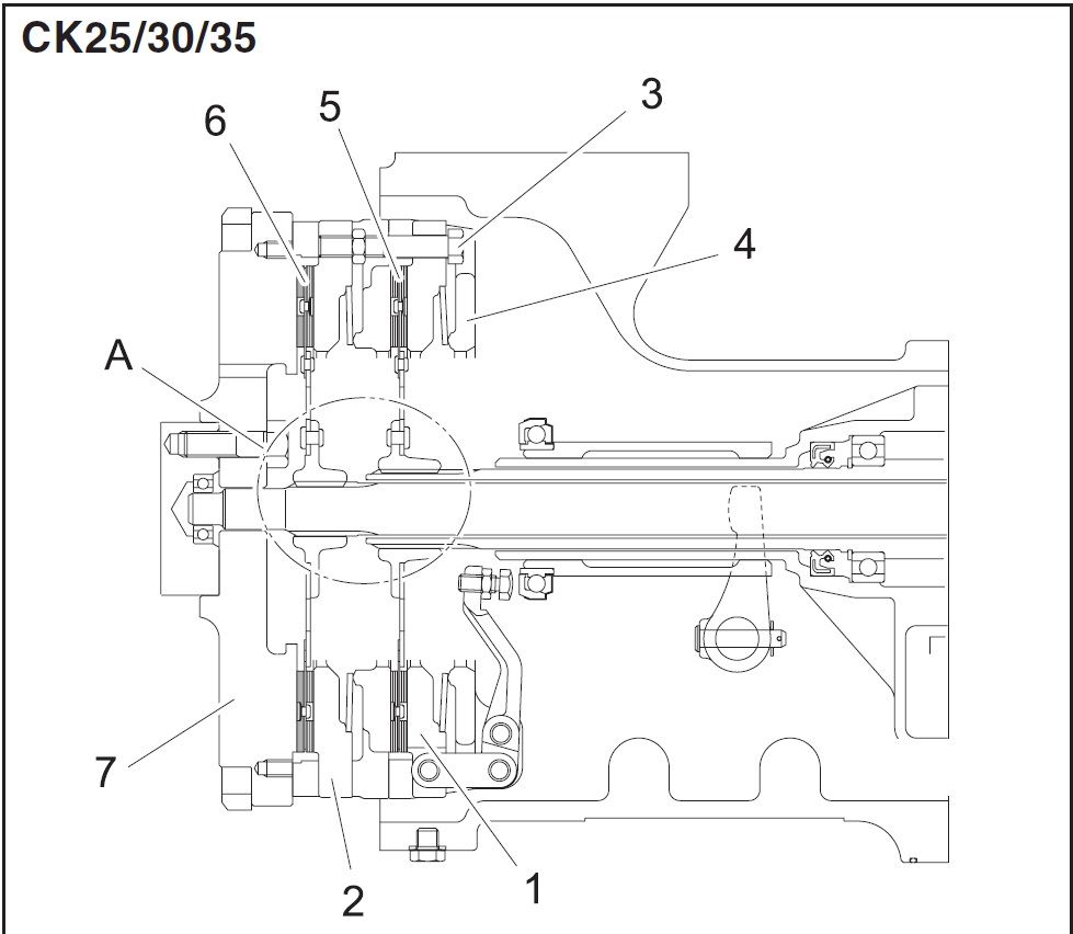

With that said, is there anyone with advice on how to adjust the PTO clutch pack portion of my two stage clutch, not worked on a two stage before. I've got owner's and service manual, neither are of much help, they spell out play in peddle but not much else. I need to adjust mine, I've got enough drag fully depressed that I can not engage implement.

I'd like to hear from those that have adjusted a 2 stage clutch as well. Not the first time hearing the manual isnt much help. If its like adjusting a clutch on a vehicle/pickup, I got that part. Curious if its similar.

You can/should adjust the external clutch linkage IAW the manual. The free-play is the main part. If there is too much free play there won't be enough stroke to fully disengage both clutches.
If the free play and stop are correct and the PTO clutch still doesn't release the clutch disk may just be frozen to the pressure plate or one of the internal (inside the clutch housing) adjustments could be messed up. The bad news is that (as far as I know) you need to split the tractor fix those internal adjustments.
Here's a cross section of the dual clutch: clutch.jpg
The lever on the cross shaft pushes the sleeve forward so the throw-out bearing pushes against three (only one shown at bottom of clutch pack) levers. These levers pull the drive pressure plate (#1) aft to release the drive clutch disk. Each of these levers has an adjustment screw, which could be mis-adjusted. More likely, the bolts (#3 in diagram) that connect the pressure plates (#1 and #2) could be out of adjustment. The release lever mechanism only moves the aft (drive) pressure plate but (after taking up the slack) those bolts (#3) pull the forward (PTO) pressure plate to release the PTO clutch disk.

Thanks my fear is that my adjustment may need to be internal as my drive free play seems to be right on based on feel will measure this weekend
I guess I can adjust to get some more throw at the bottom of pedal stroke and maybe that will do the trick as I don't think I'm hugely off as under a bit of load the implement will stop spinning with clutch fully depressed
