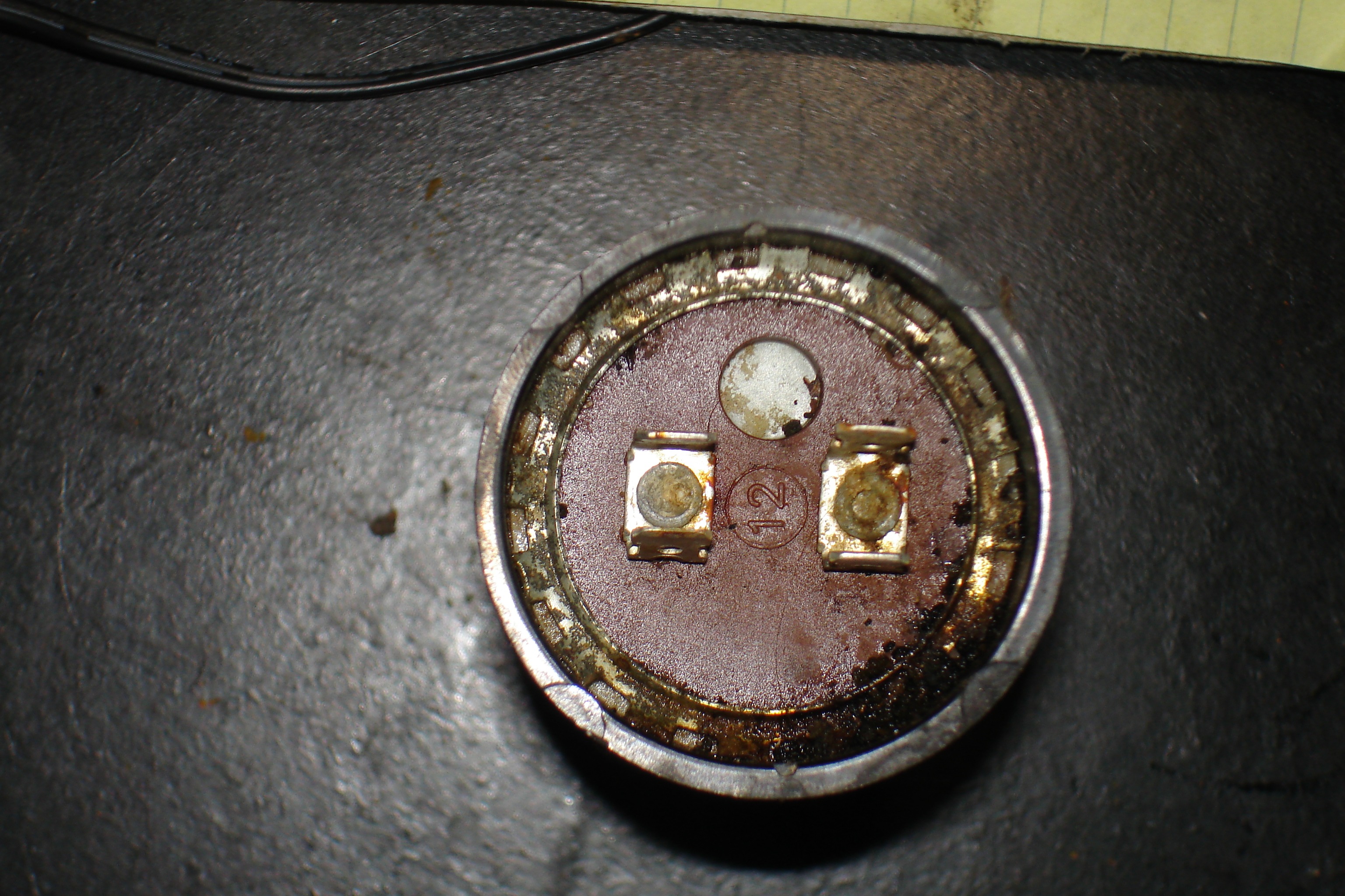

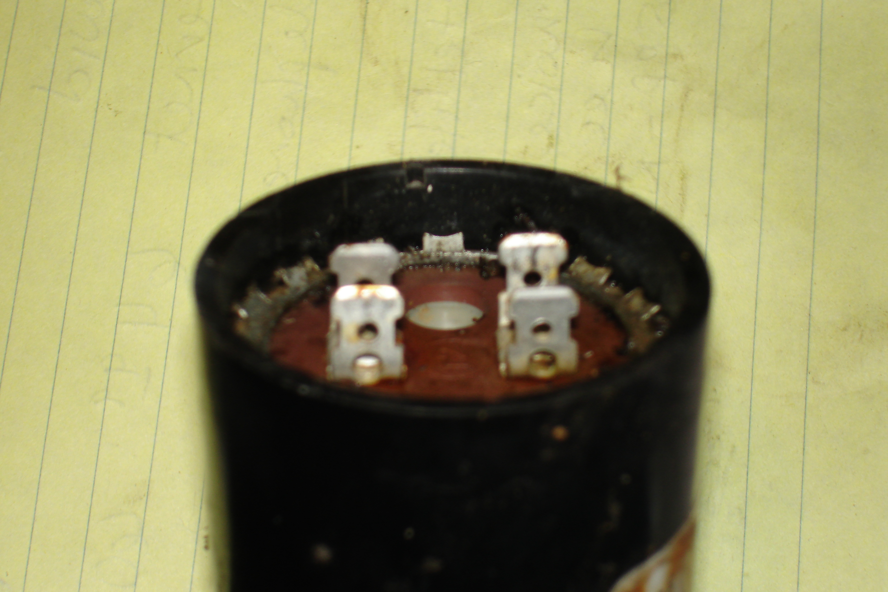

I have a homemade chicken plucker that I built a few years ago I used a Marathon 3/4 hp farm duty motor from Tractor Supply. While moving firewood last winter the motor got hit and the start capacitor came off. There are 2 black wires from the motor, one is brass colored the other is silver. The brass terminal has J9 on the wire and the silver has T5. I see this on the wire diagram I have but I do not know if it makes a difference what side goes on where. There are 2 sides so does it matter what side they are on. I know they need to go on separate terminals

Doesn't matter, wire markers are basically where they come from.

Those capacitors are non-polarized and are being used for A/C current, so it doesn't matter.
   / START CAPACITOR WIRE QUESTION FARM DUTY 3/4 HP MOTOR #5
Does not matter. If the capacitor is damaged, install a new cap with a voltage rating as high or higher than the original. The microfarad rating can also be increased, this will improve starting torque.

It looks like that one may be leaking out oil any way, good reason the replace. They are not really made to get; the metal ring holding the case on is thin and rusts quickly.
