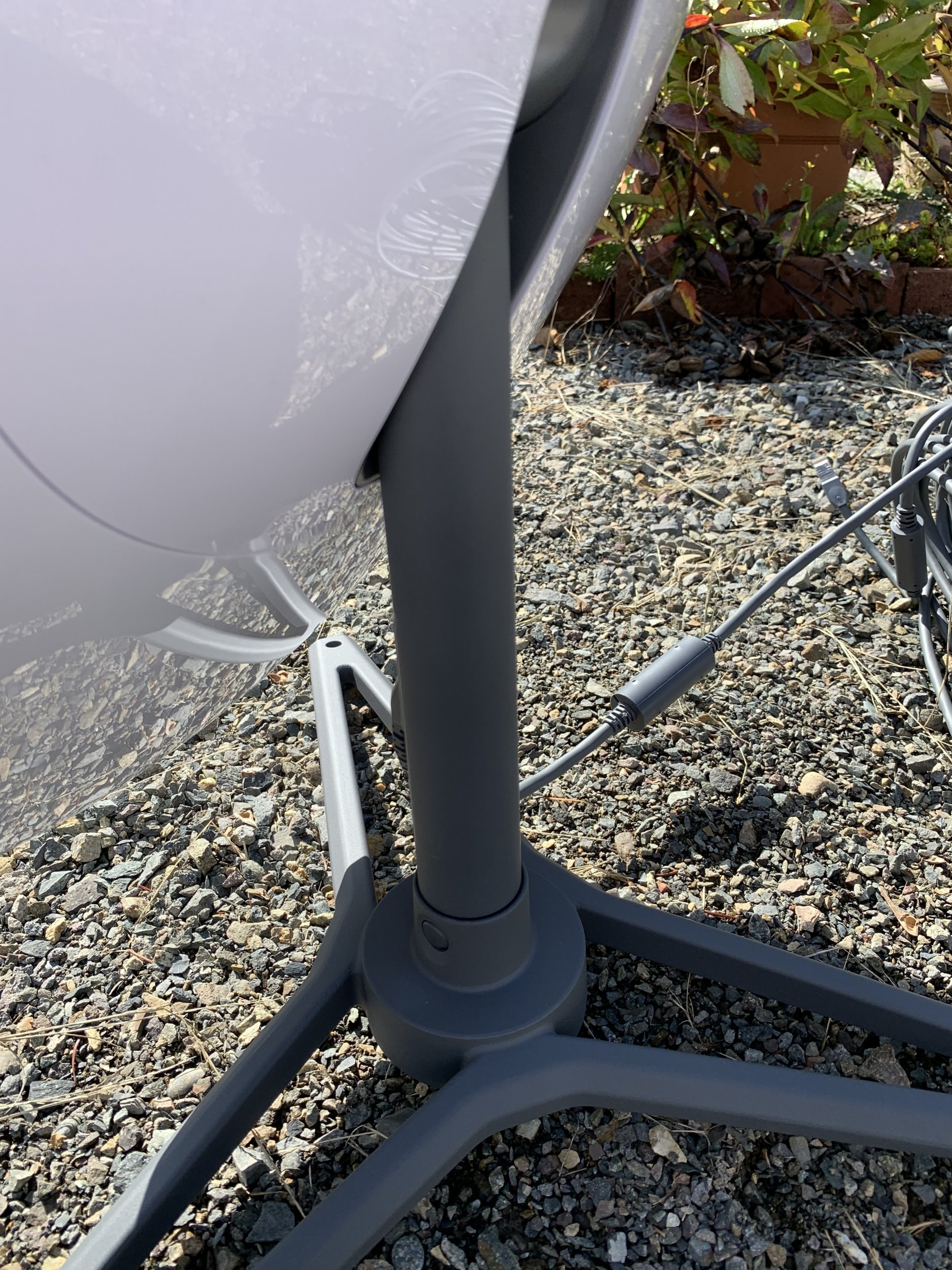

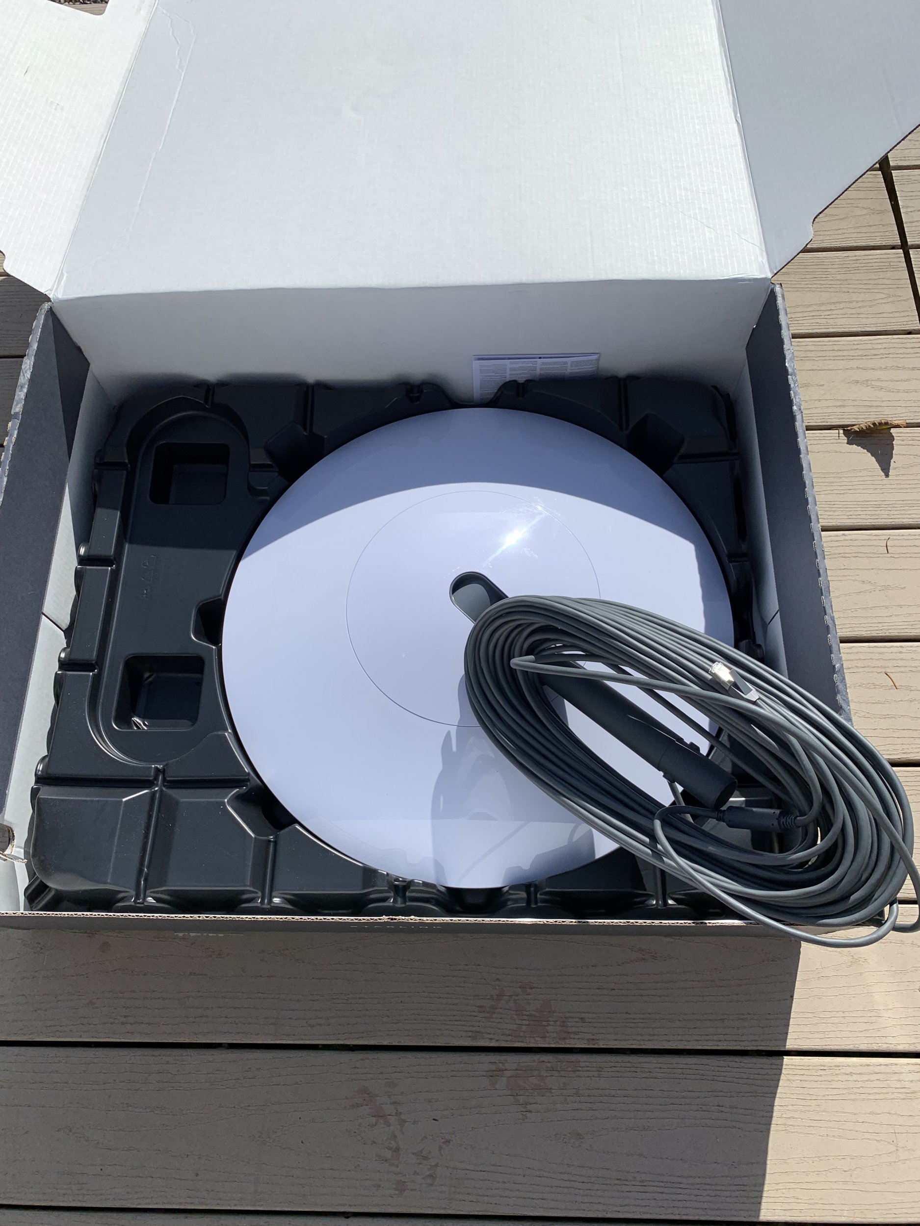

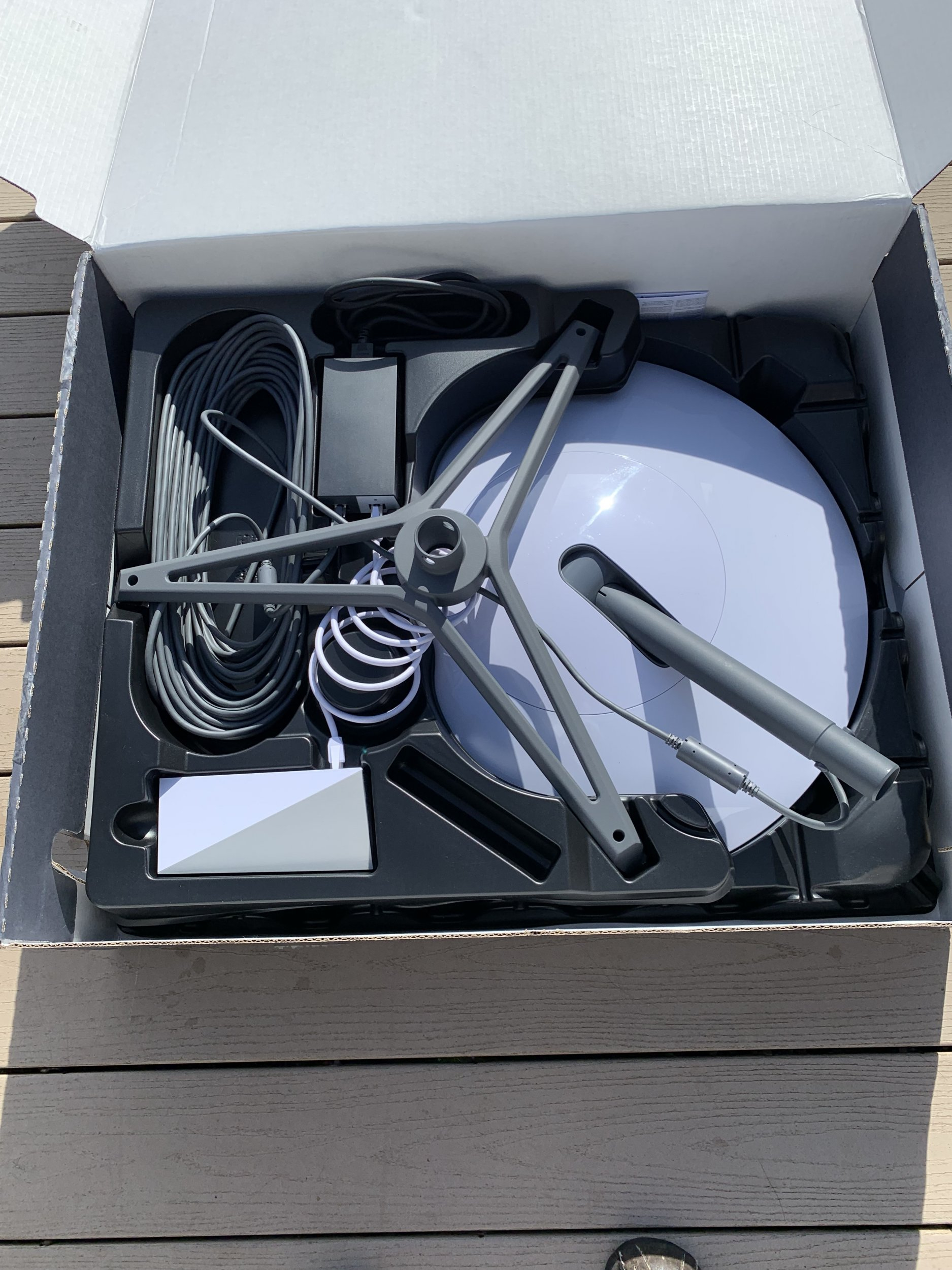

/ Starlink #1,346
/ Starlink #1,347
It is great to see more people getting one! What revision is yours?
All the best,
Peter
/ Starlink #1,349
Thanks! The dish is what I was curious about. Rev2 hardware is supposed to have about half the running power of revision 1. (40-50W) With Starlink's recent comments about manufacturing changes, I was curious what is current.
All the best,
Peter
/ Starlink #1,351
