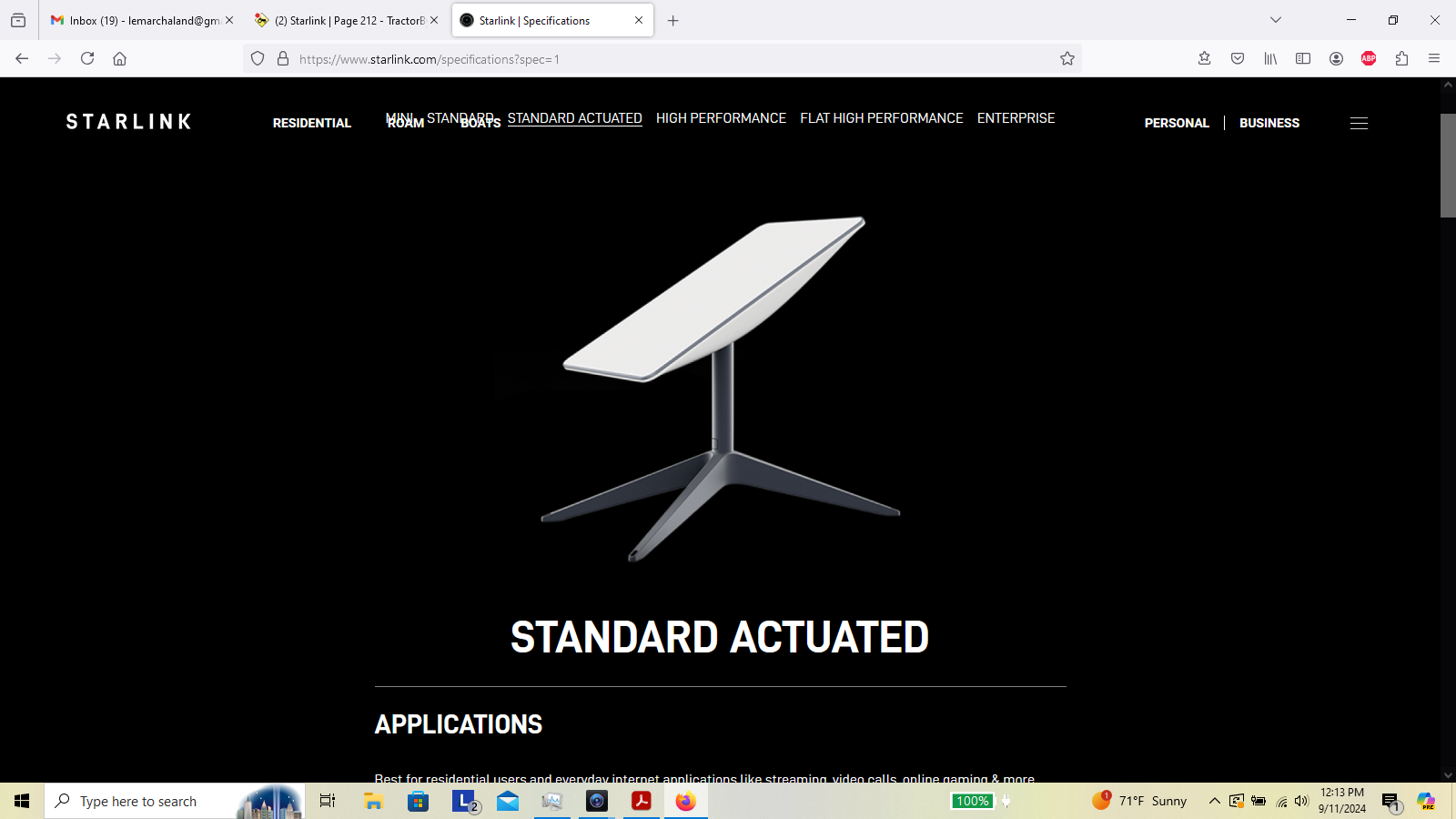

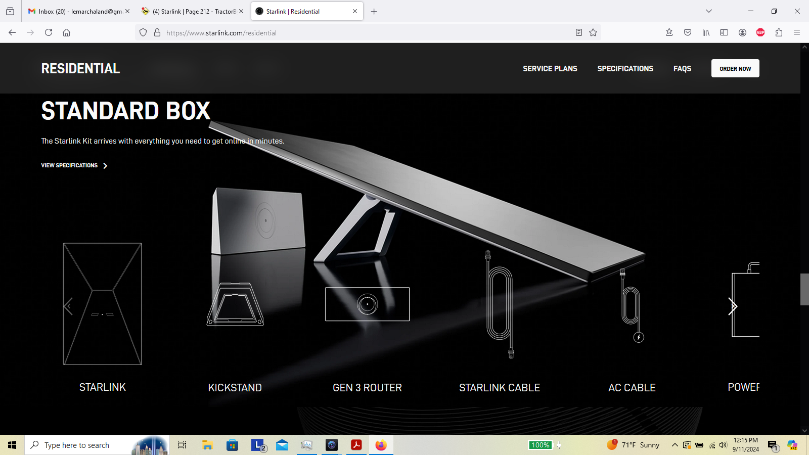

They actually have two "standard" kits;
The one is still the motorized self aiming unit with the Gen 2 router which requires the adapter for the Ethernet port,
and then the "newer" standard which you have to aim which has the Gen 3 router with the built in Ethernet ports
Starlink's site is a bit of a morass to navigate in my opinion.
That's their specifications page that includes older hardware. The order page only includes the newer non-pivoting residential and business antennas, plus the mobile and lite versions;
