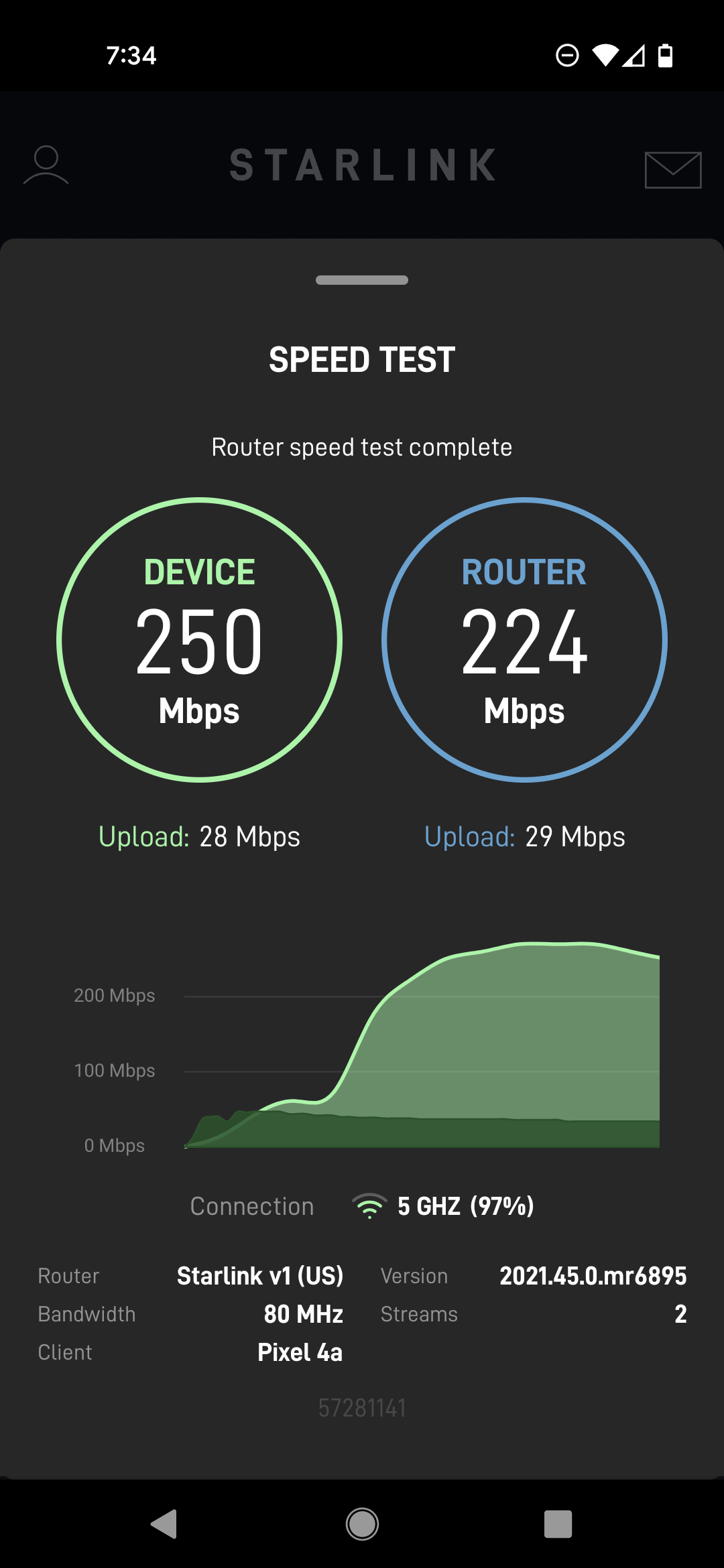

I just got the same email. Based on the disappointing performance of my Starlink system so far, I may have to rethink this. I'm within the 30 day period so I can get a full refund if I choose to.
What did you ultimately decide?
/ Starlink #3,340
I decided to keep Starlink. I'm not sure why but the performance greatly improved. I'm now getting 150 - 200 down / 15 - 25 up on a regular basis. The speeds slow a bit during heavy rain / snow but I can live with that. Service interruptions have been short and relatively infrequent. Overall, I'm happy with the service.
There was also a price increase on my wireless internet so the $110/mo. is a bit easier to take.
