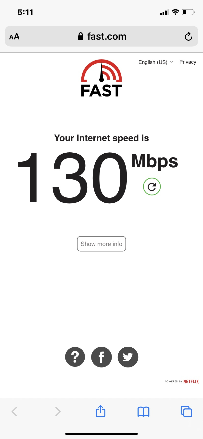

Still chugging away with frontier at a whopping 1.5mps, hoping for that starlink golden ticket soon.
Our Golden Ticket arrived last week. 🕺:LOL: Starlink went down at 2:00 or 3:00 in the morning after it was setup, I assume doing an software update. Since then it has been rock solid. The router said there were a couple of 2 second or less disruptions but we could not tell. We do have a slight obstruction in one direction very low on the horizon so I assume that was the cause of signal loss.
We will keep our 1.5 mbps DSL lines for a bit longer and then cancel.
We have been using a cell base Internet connection, which we will keep as a backup to Starlink, since it does not cost that much on our cell plan. The cell based Internet was pretty good but it is night and day different with Starlink.
