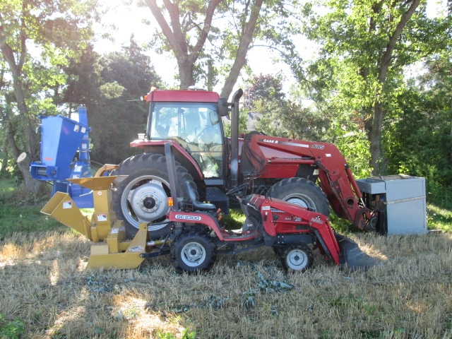

Used every summer to elevate the trees bordering the fields.

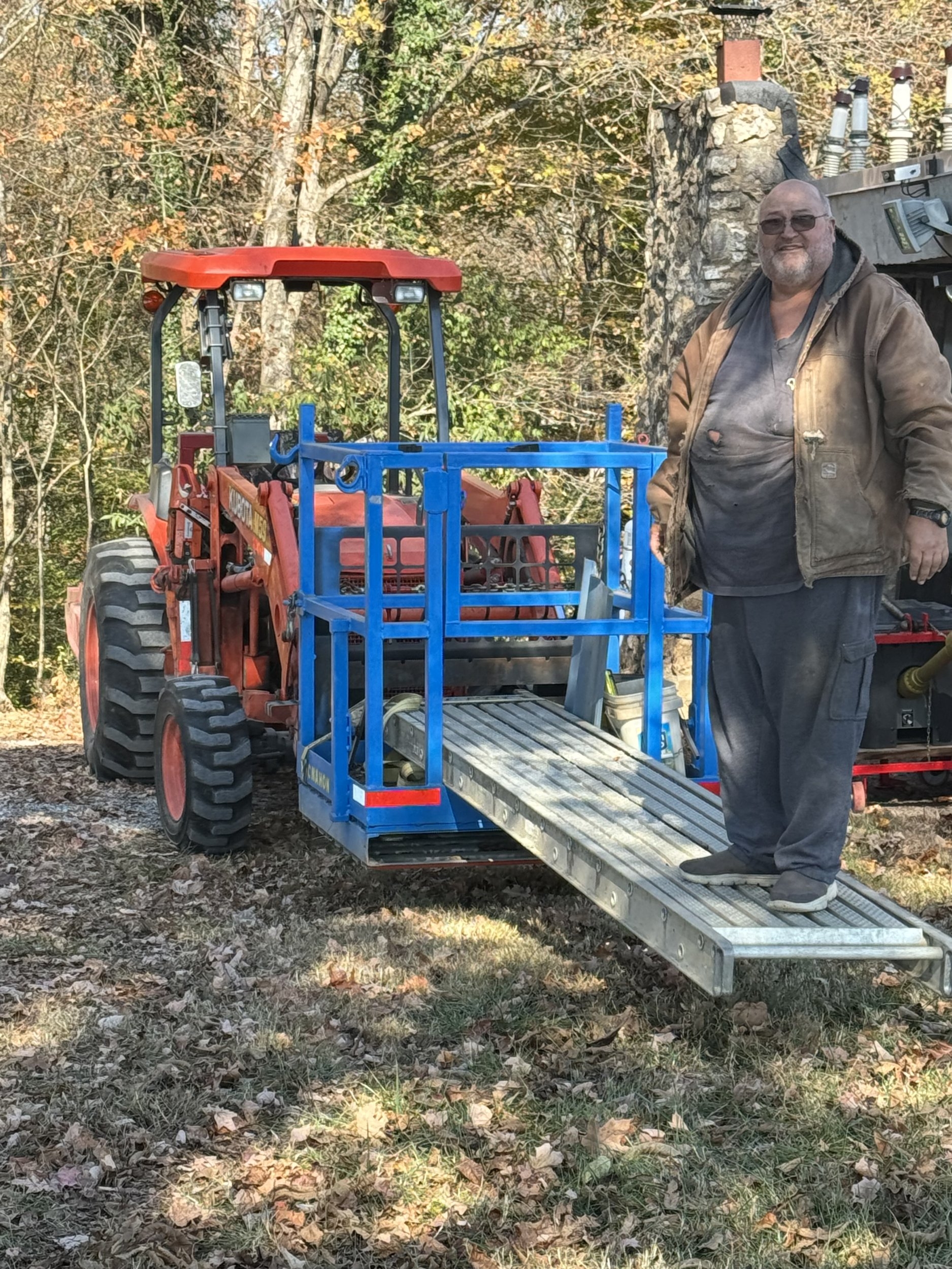

Made my platform and real handy around the farm. Wife regularly uses the B26 and is a good operator of the M59.
Made safety legs for the platform. One will hold it up if you release the hydraulics. Design concept I wanted to try. Down side the platform will not fit where it’s stored in the barn so don’t normally use them.
Walk boards can be used different configurations, on rails or extended depending on job. Have ssqa hitch that attaches to the backhoe that allowed reach to one part of the barn.

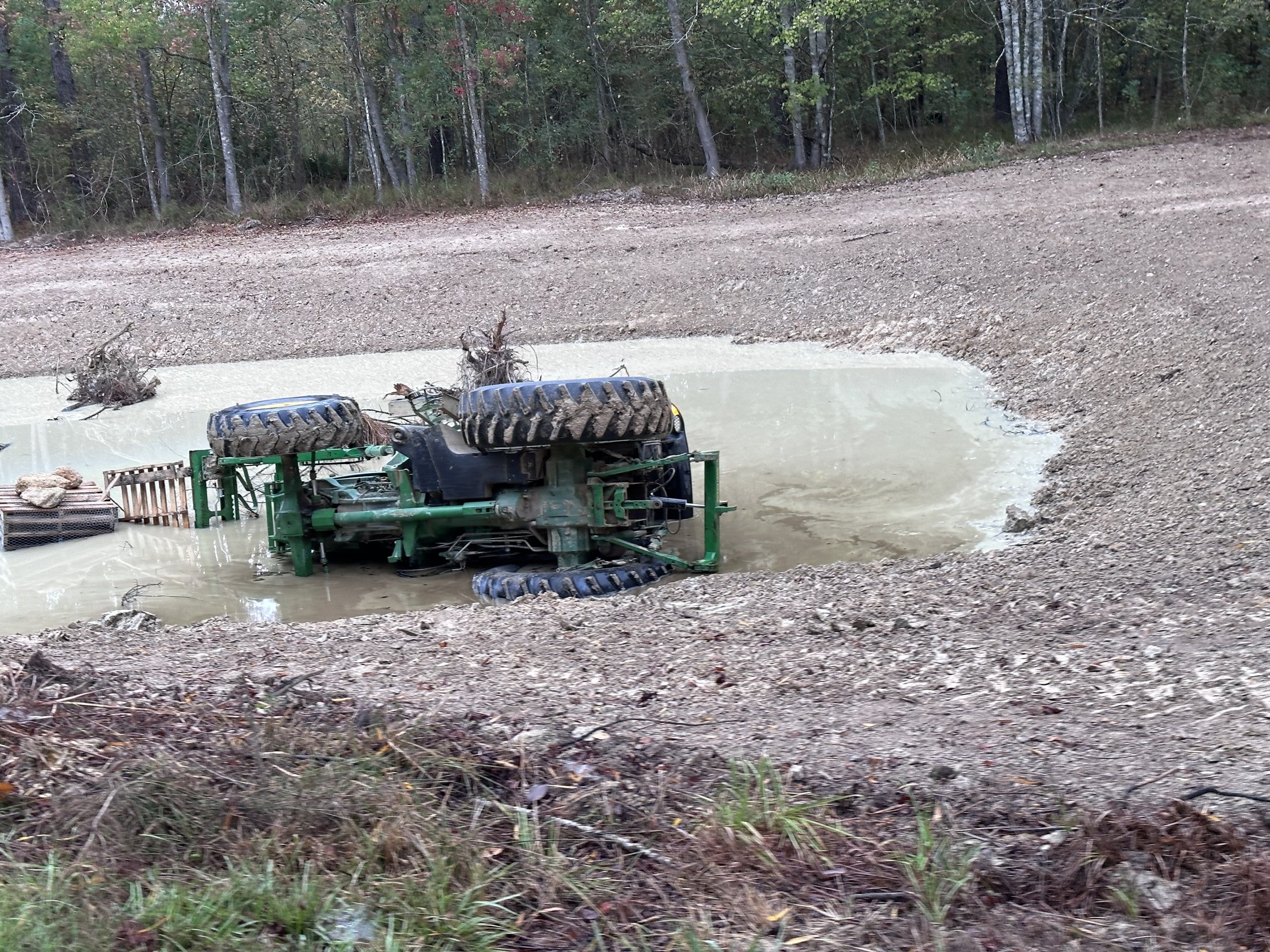

About 2 weeks ago I was standing on the pallet when this happened. Luckily I was in a position to jump in the opposite direction. No one was injured. Things happen fast.

"backhoe subframe and stabilizer legs (whatever they're called)? Seems like it would help in the safety dept."
Whatever the cost, cheaper than a hospital bill if you weren't so lucky???

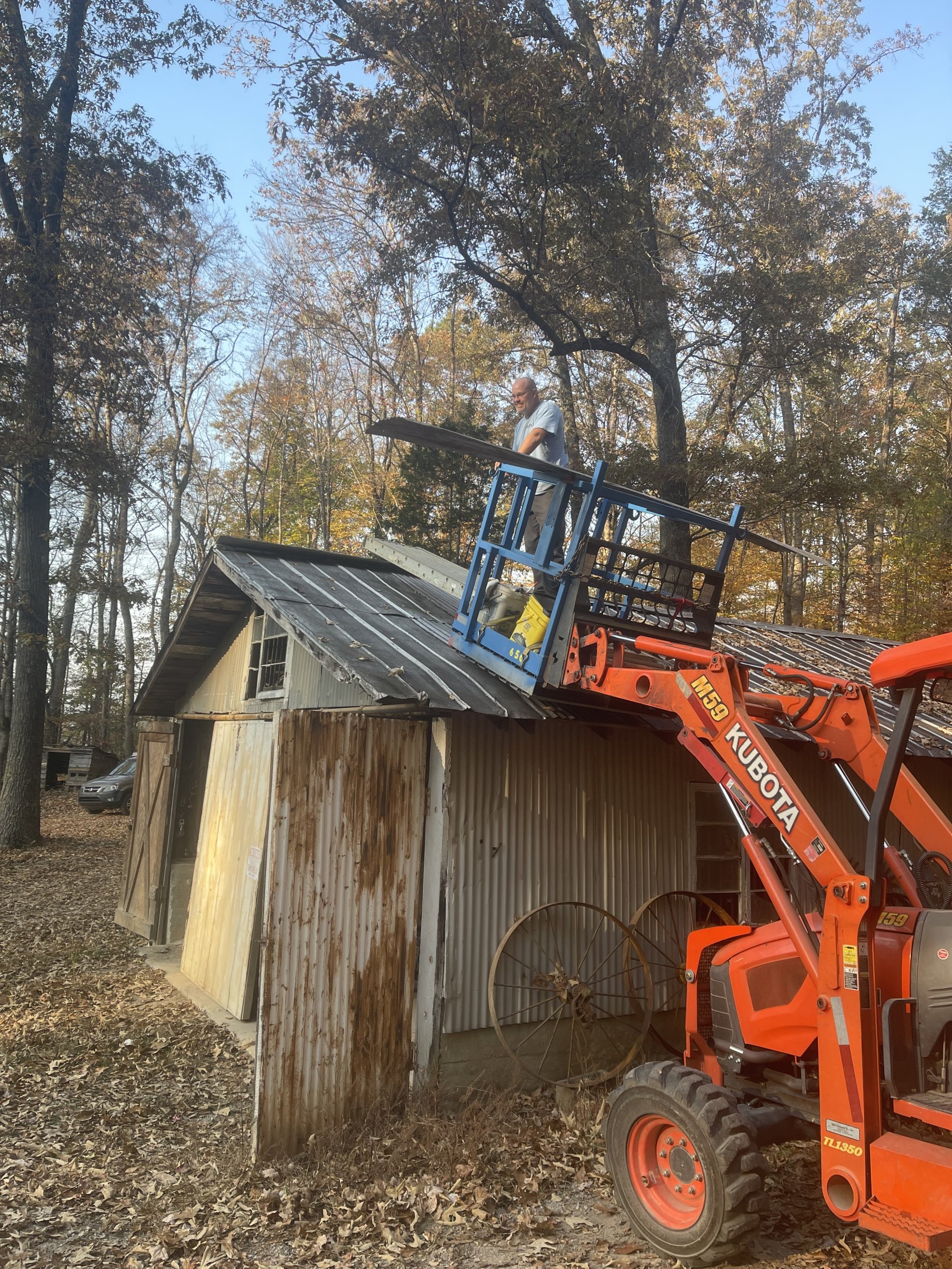

SSQA on backhoe pic?
ATI attachment.
Part of the barn I couldn’t reach with the FEL. Using the man basket either front or back, the backhoe outriggers are helpful to plumb the tractor on the hillside farm and prevent rolling over.
Plans to try some other ssqa attachments like Danuser Intimdator to pull evasives on steep road banks and hydraulic auger.

a good note & glad for the safe landing. thinking the failure was in arms, not the curl, being potentially more dangerous. regards
