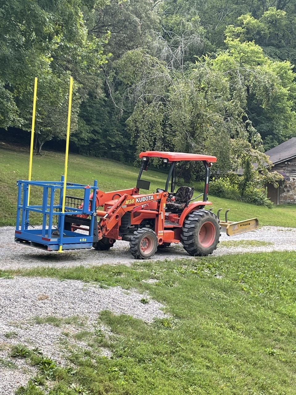

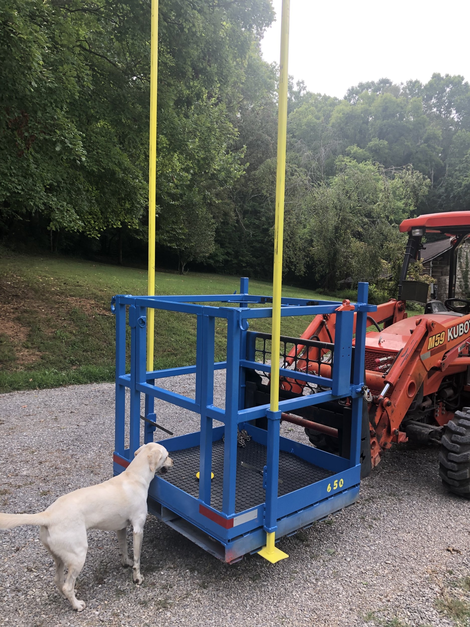

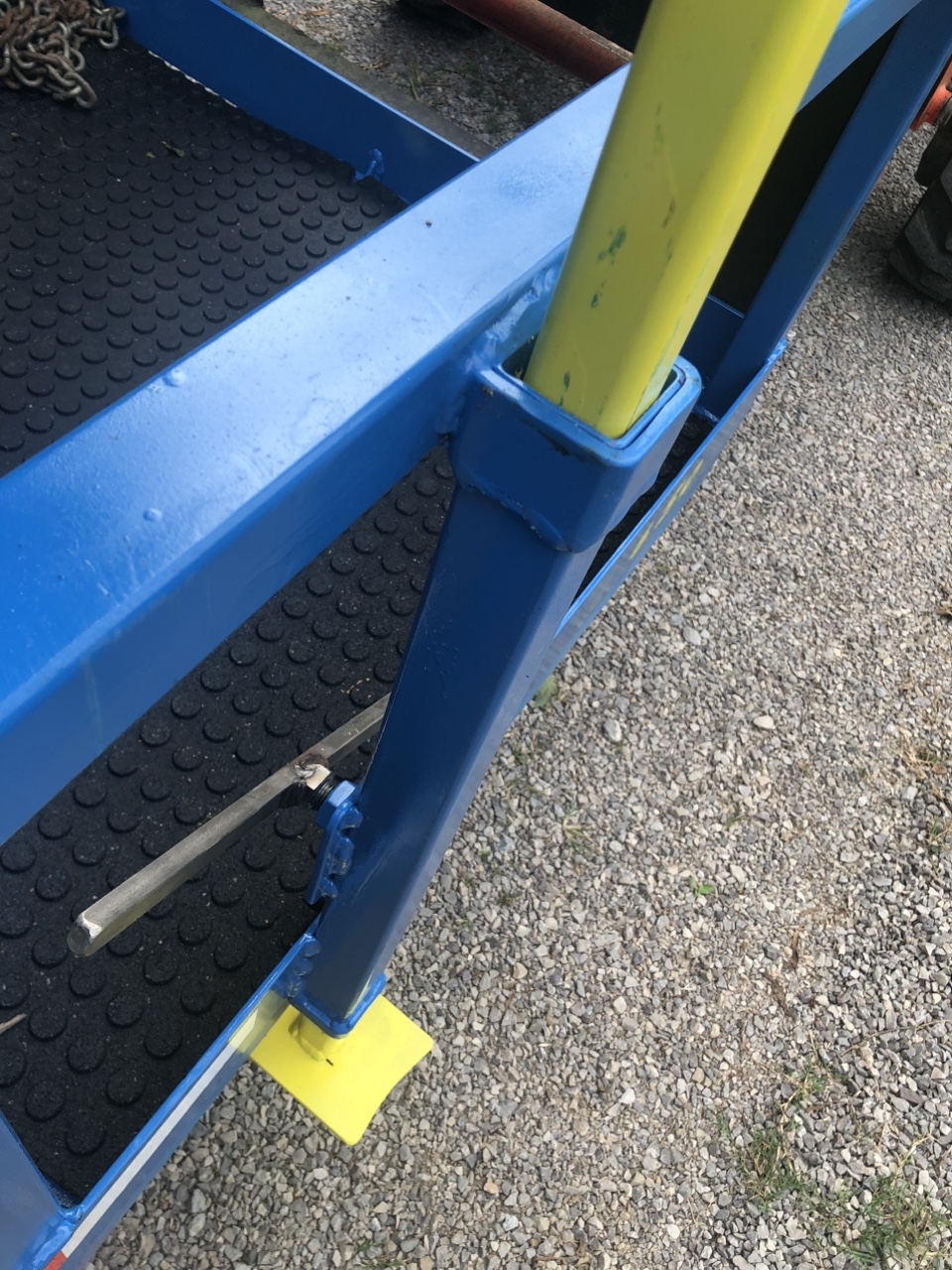

When I built my platform tried an experiment by adding safety legs. Easy to deploy. Only bad thing is they don’t fit under the part of the barn where I store the basket. Basket used more often without safety legs, just lazy on my part. Gets used often as part of the farm maintenance. Wife thankfully is a good operator.

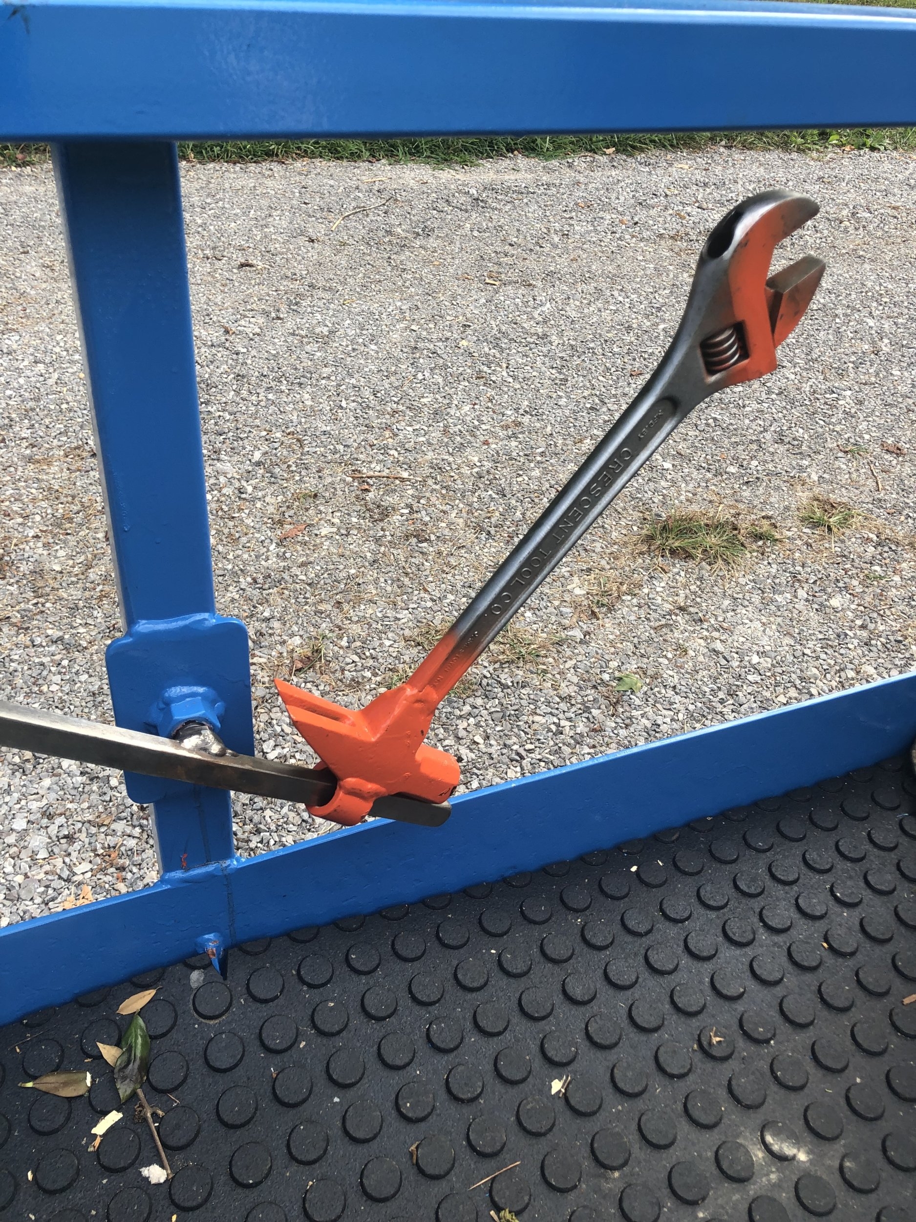

Good ideas. Love the Hammer wrench (y) (y) (y)
Planning a HF trip to get the hammer and wrench to copy that and put it in my tractor toolbox
Thank you for posting

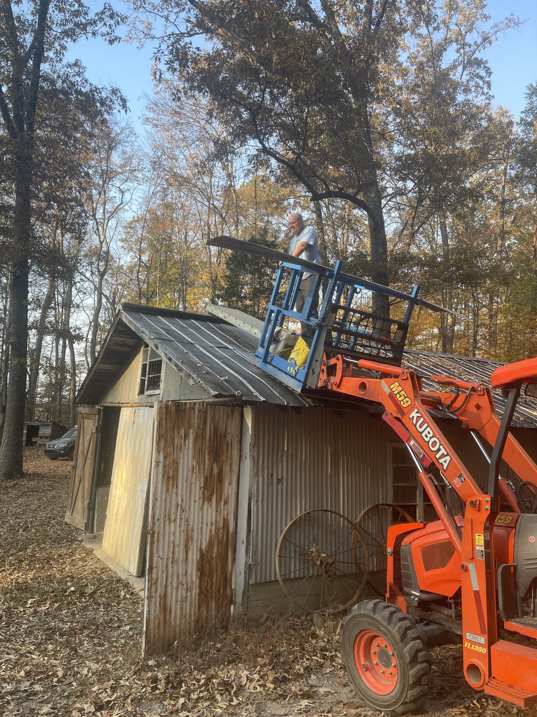

/ Standing on Platform on FEL? #31

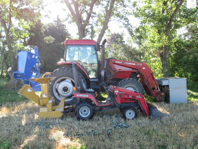

Used every summer to elevate the trees bordering the fields.

/ Standing on Platform on FEL? #32
Like the idea of a platform on pallet forks, beats climbing a ladder w/a saw. Hardly the right tool for the job but could save considerable time trimming trees, cleaning gutters etc.
Aside from failing hydraulics and lame FEL operators w/out MSL, how about adding backhoe subframe and stabilizer legs (whatever they're called)? Seems like it would help in the safety dept.

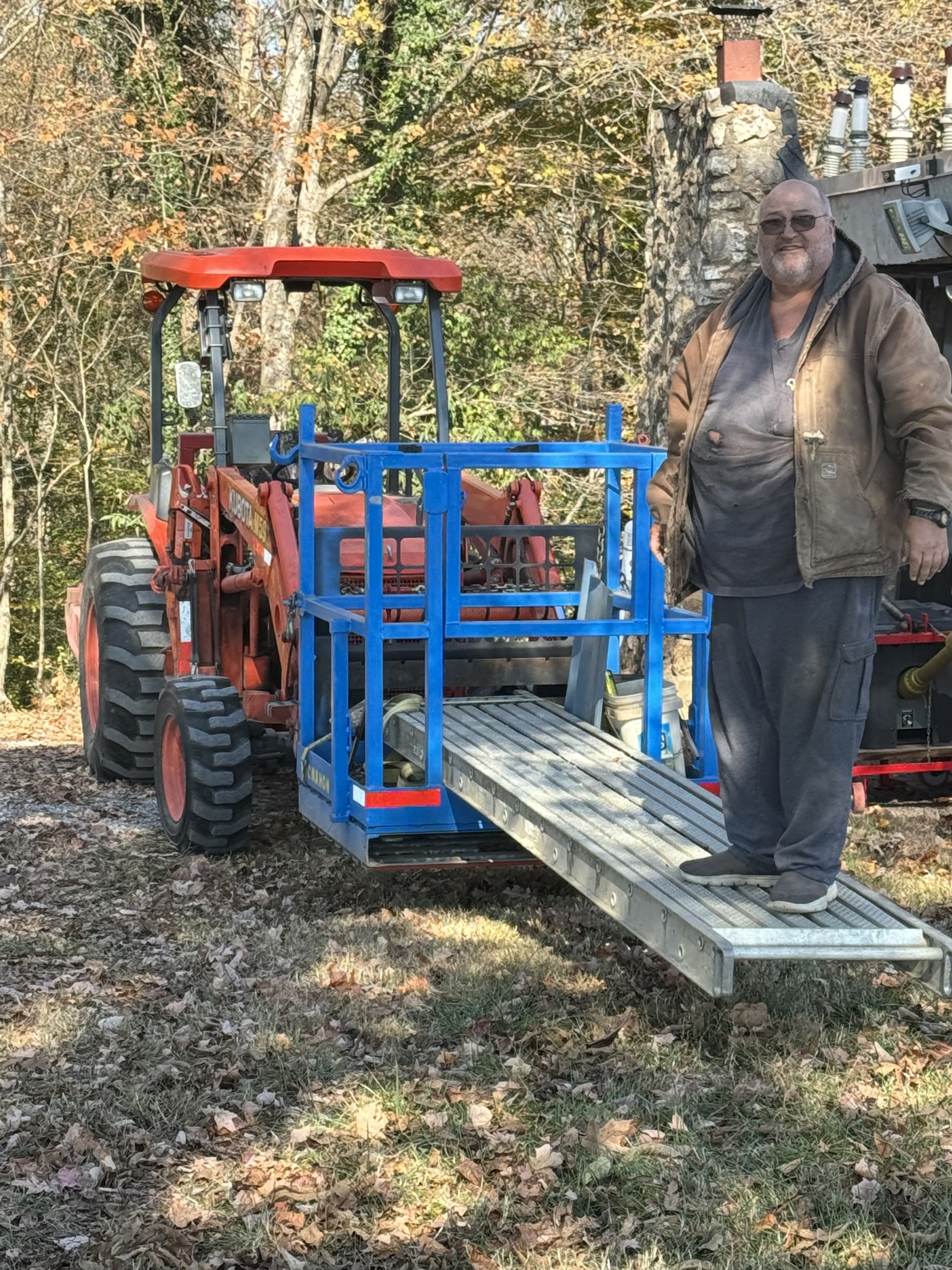

Made my platform and real handy around the farm. Wife regularly uses the B26 and is a good operator of the M59.
Made safety legs for the platform. One will hold it up if you release the hydraulics. Design concept I wanted to try. Down side the platform will not fit where it’s stored in the barn so don’t normally use them.
Walk boards can be used different configurations, on rails or extended depending on job. Have ssqa hitch that attaches to the backhoe that allowed reach to one part of the barn.

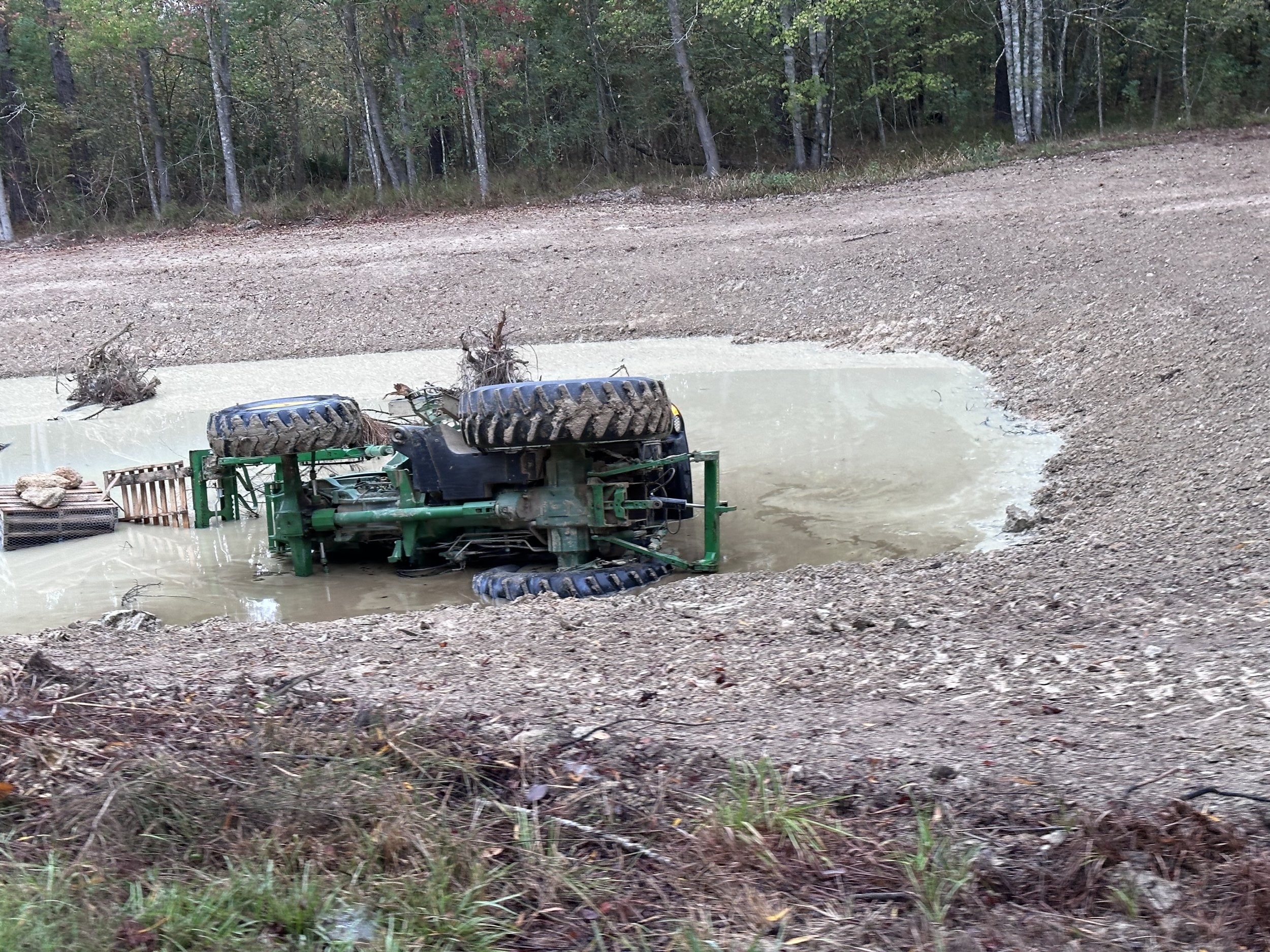

/ Standing on Platform on FEL? #35
About 2 weeks ago I was standing on the pallet when this happened. Luckily I was in a position to jump in the opposite direction. No one was injured. Things happen fast.

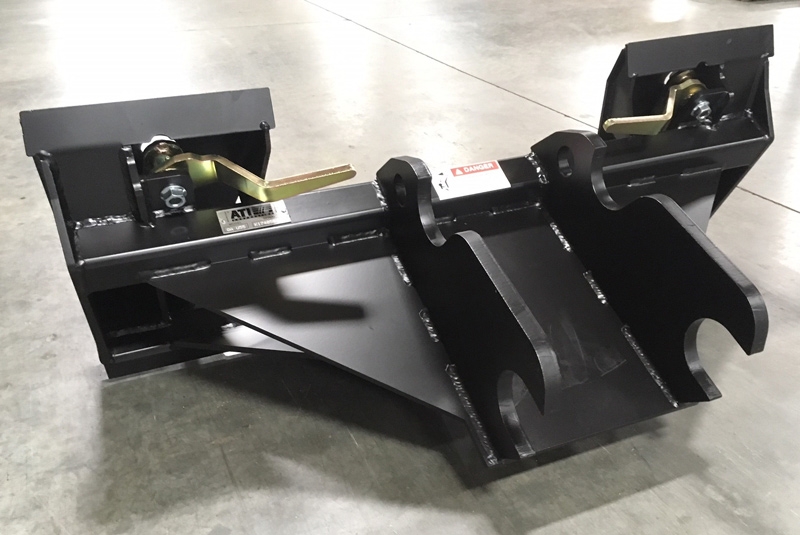

SSQA on backhoe pic?
ATI attachment.
Part of the barn I couldn’t reach with the FEL. Using the man basket either front or back, the backhoe outriggers are helpful to plumb the tractor on the hillside farm and prevent rolling over.
