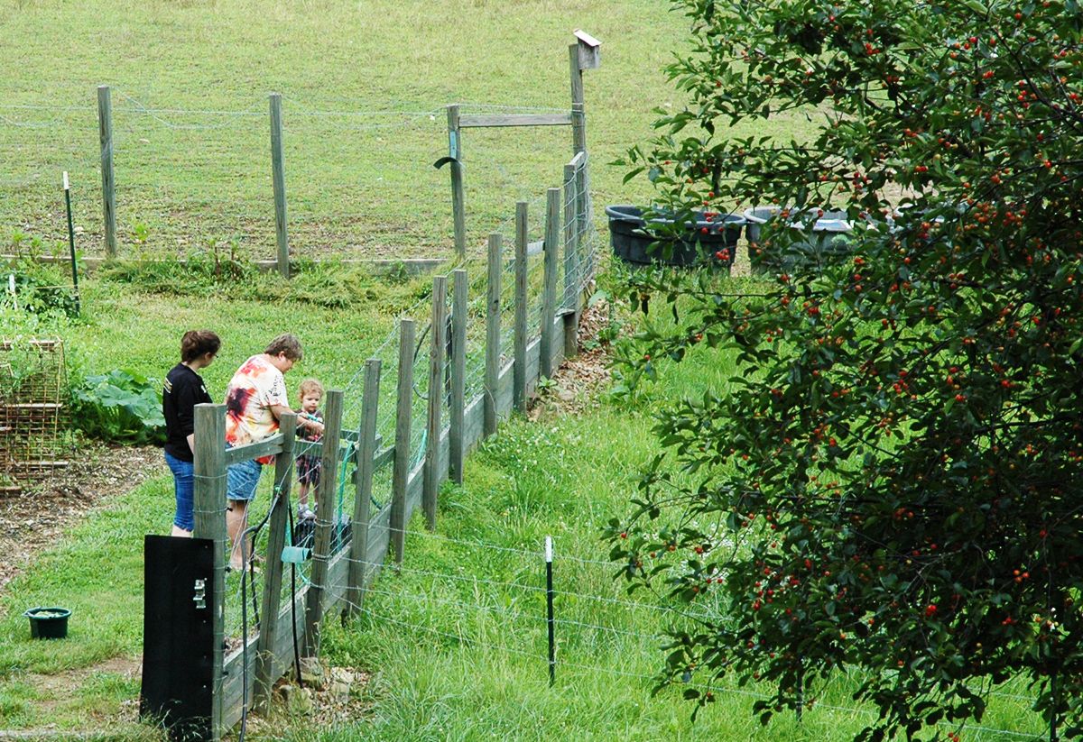

I have not looked for oil based lately, but, we did use it about 20 years ago,,
we have over 1000' of CCA treated fence that is stained.
The color my wife selected is the color we believed CCA treated wood will "go to" in time.
If you choose this color, there is MUCH less concern about the finish coming off.
The girl mowing the grass was 10 years old when we installed the fence behind her,,,
That is my daughter, she now has a 7 year old daughter,, and the fence looks great.
Two neighbors installed oak board fence within 3 years after we installed the CCA fence.
Both neighbors put some "black" finish on the oak,,,
both oak fences are now broken and falling down,
Coincidentally,, my daughter purchased one of the places with the oak board fence.
Here is a pic of some of that fence,,
you can see there are sections where the oak boards are falling down.
