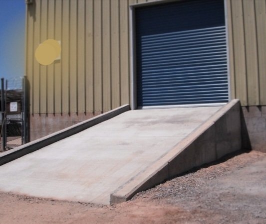

pour a concrete ramp
Did you do that with bags of concrete, or a truck? How much concrete? If you don't mind my asking, how much did it cost?
I don't know much about working with concrete. I've poured little slabs and set posts and poured steps one at a time, but that's it. How do you do that job? Maybe you do the side walls with boards held together through the wall, then pour the ramp once the walls are strong?
That looks beautiful. The whole setup looks beautiful.
   / Treatment for PT plywood for outdoor ramp #28
I had something similar done and that can be done as a monolithic pour. They'll frame the sides and fill with dirt and compact it then use a shovel to dig out along the form walls. The curb will be a "floating" form board suspended from the wall form. The concrete will have to be stiff enough to stay in place on the slope of the ramp.

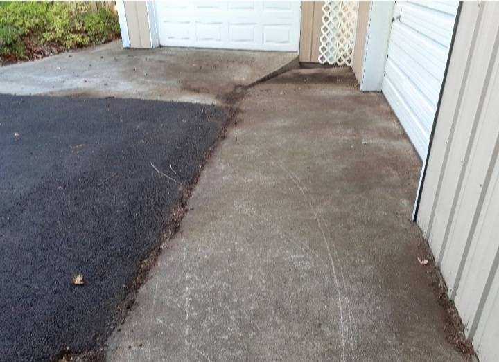

That was just an example I found online. There are others here who know much more about concrete than me, I'm just a hack and have poured concrete. Me...I'd measure ramp area you need. Then figure out depth concrete needed. There are formulas based on weight. I think you said 5".
everything-about-concrete.com
Is a good site to check out. It explains the procedure, it's not that big of a deal. Lowe's, Home Depot has wire & Quickrete. If you have a wheelbarrow, hoe & water you're set. Just form it with scrap lumber, level with shed opening, pour, screed, broom finish.
This is a ramp here from asphalt up about 6" to a shed. It's 4ft wider because to left is a walk in door. Sidewalk slopes away from building on right and I cut in a trough under lattice for heavy rainfall, water goes downhill if drains can't take all of it.
