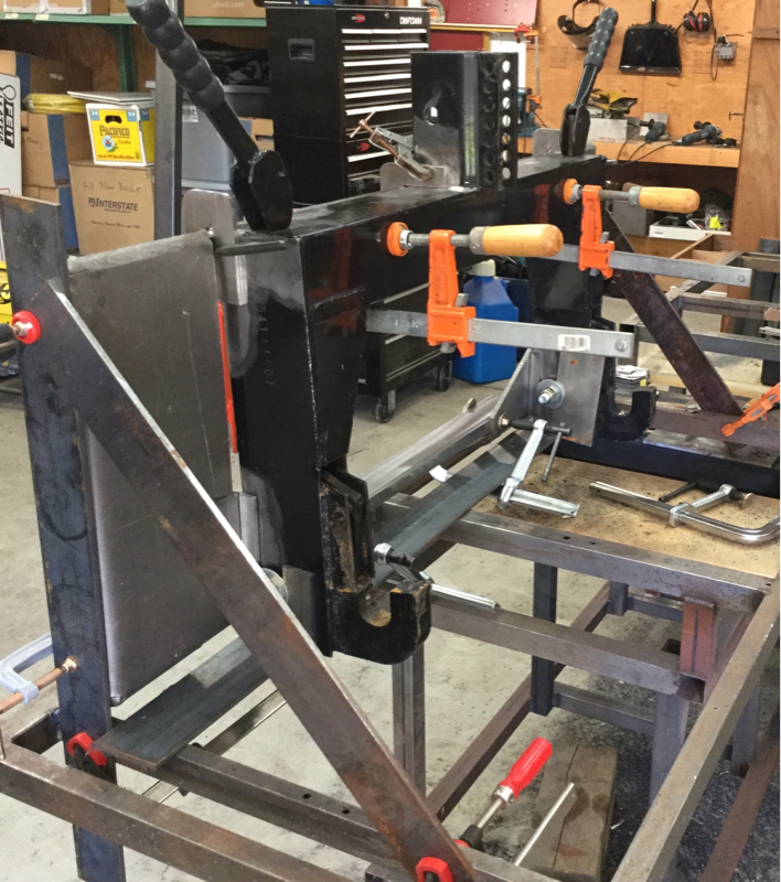

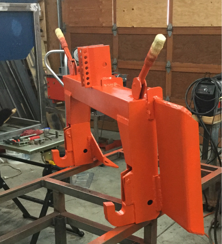

I decided to get one of these so I can use the trailer mover and some other things on the front of the tractor. Did not intend to make one but the prices were kind of high. $1000-$1200 from mainstream retailers and $500-$600 on ebay. So then I figured someone on TBN surely has already solved this problem.

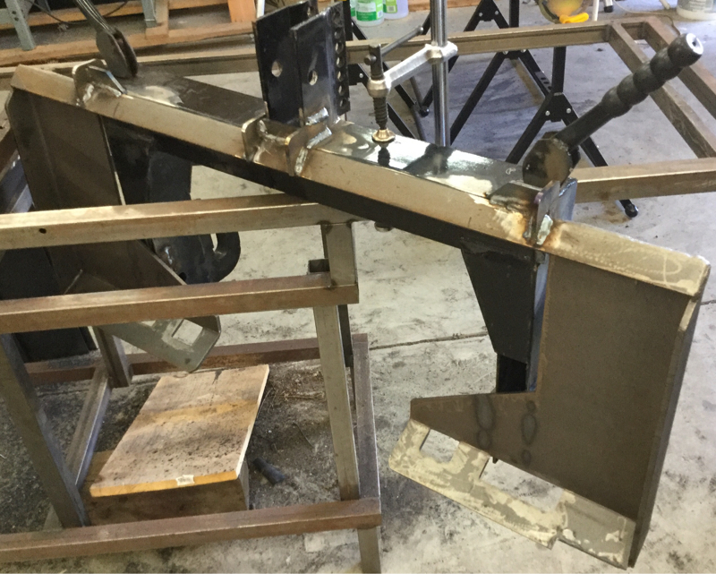

My first search turned up a build by countrybumpkin, he welded ssqa plates to a HF quick hitch. I thought that was pretty slick so I did the same. I got the quick hitch for $79 with a 20% discount and a Titan ssqa plate for $95. Welded them together. Two pix below show it jigged and ready to tack, and then welded up. Needs paint although someone here said that rust is also a color and I may go for that.

Looks good ... :thumbsup:
I need to do one of those myself ...

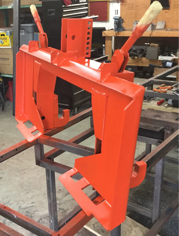

I decided it would be too demoralizing to leave it half-black and half-rust. Painting a HF quick hitch is definitely lipstick on a pig though.
On the question about use for me it is a convenience worth a couple hundred dollars and some work.
/ SSQA to Three Point Hitch Adapter #6
Did somebody say something about a pig wearin lipstick around here lol jk . Hey that looks really good, and for what your into it it's a no brainer. Nice Job

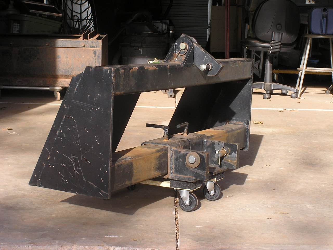

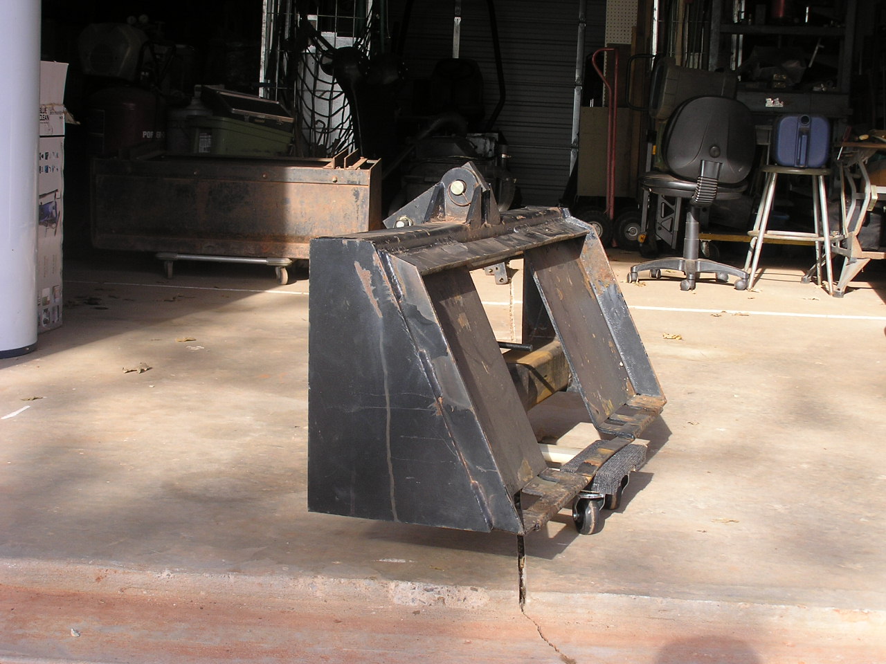

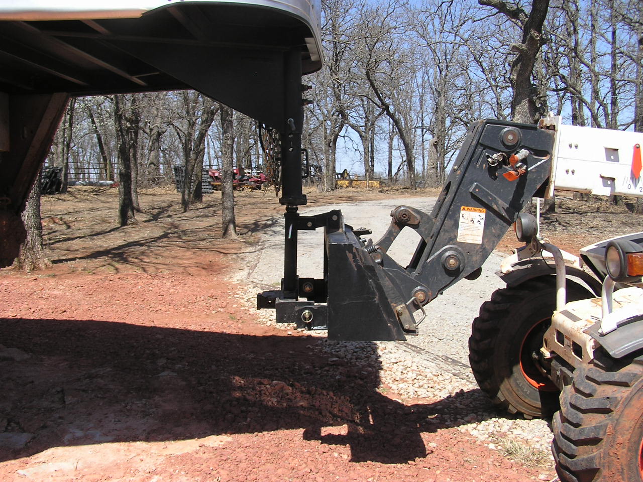

I did the same thing, QH welded to a SSQA plate. Haven't painted mine yet.
My only regret is welding it flat & not giving the QH some rollback. I can dump it past parallel to the ground, but really can't tilt it back past level.
It's currently the pivot & mount for my snow plow. It pivots on the bottom hooks & I hook a chain to the top hook.
I hook my 3pt trailer mover to my loader far more than on my real 3pt. And I store a few friends trailers on my place in addition to my trailers. So I shuffle em around a fair bit. Keep thinking about how to add a 2" reliever to the QH/SSQA plate, but haven't put any effort into figuring out where I could fit it yet.

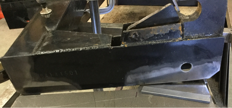

I did the same thing, QH welded to a SSQA plate. Haven't painted mine yet. My only regret is welding it flat & not giving the QH some rollback.
I was able to get some rollback by grinding and positioning the QH. Picture shows it. More would be better but also a more complicated build.

******. Now I'm committed to building me one of these! Any pointers before I weld 'em together? Size thickness of the Titan plate?
The plate is 5/16. The bar across the top is 3/8. I got this style so can see through to the ball on my trailer mover for easy hookup.

One thing I thought about is gussets on the "wings" at the side. Decided not to. The QA lips top and bottom add a lot of stiffness. I don't think it will bend under intended use.

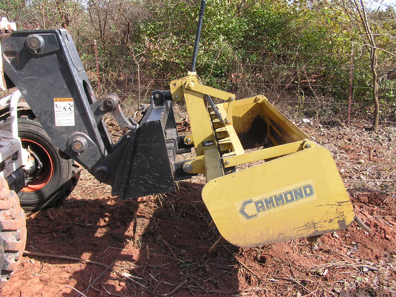

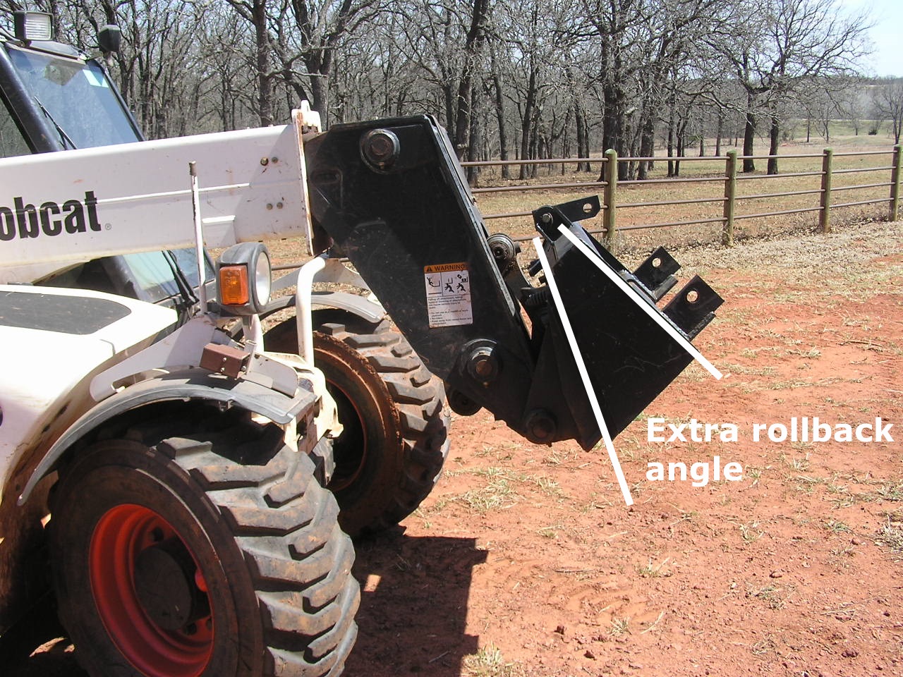

The 3 point adapter that I bought has a lot of extra rollback built in:
/ SSQA to Three Point Hitch Adapter #16
Xfaxman, that's a great setup you got there. No doubt it will fit just about any 3ph implements!!!
/ SSQA to Three Point Hitch Adapter #17
Thanks, it is cat2, so I have to use bushings for some things.
