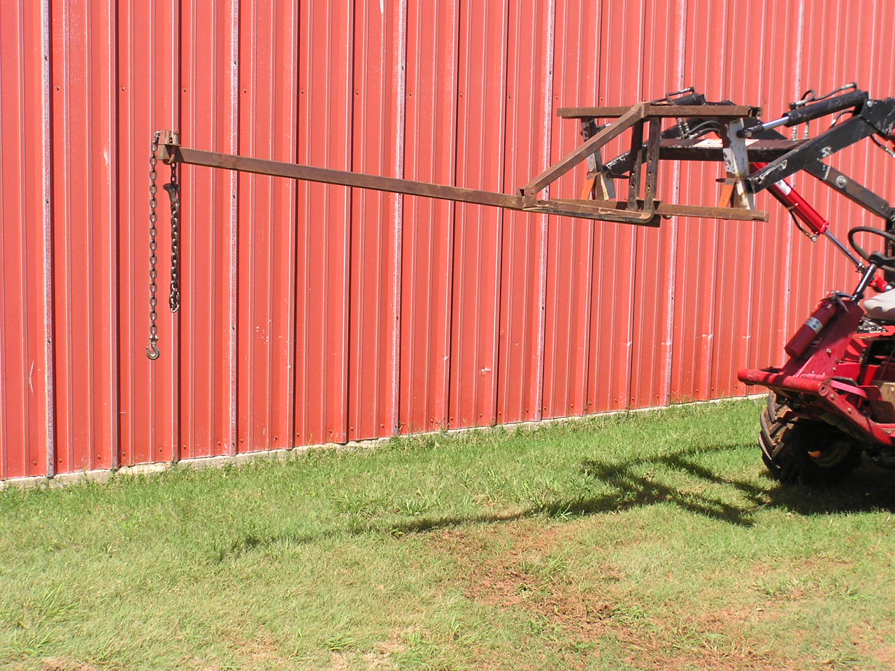

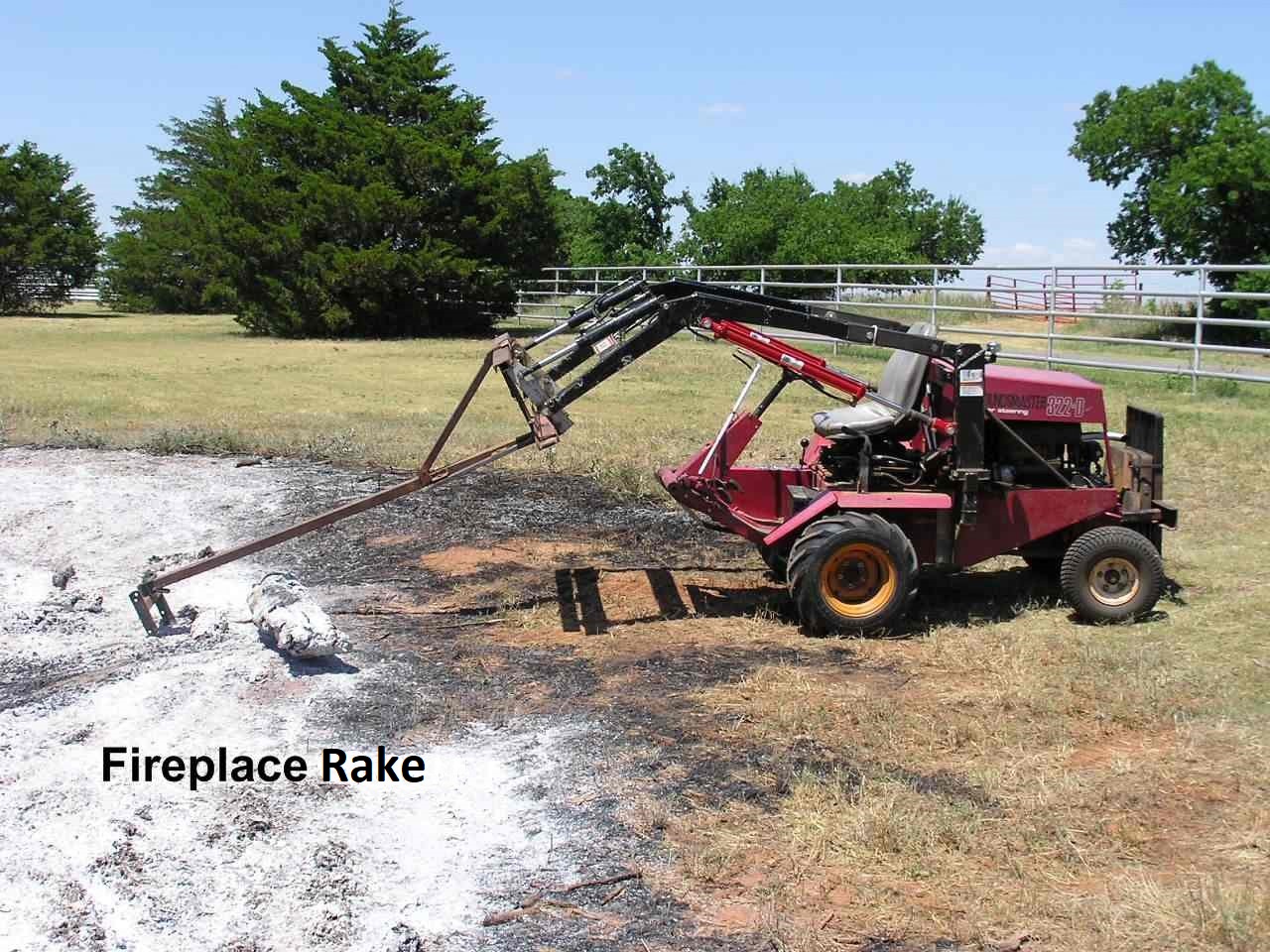

Yep, very handy. Made this one fifteen years ago to fit on the forks:

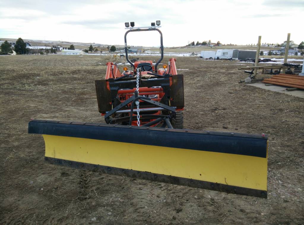

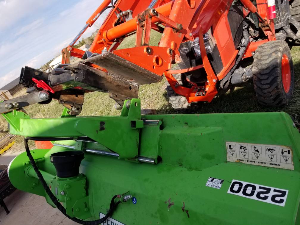

I welded a 3pt Quick Hitch to a SSQA plate twice. First one was the mount for a snow plow & sold with my old machine. It was handy enough for moving, lifting & maintaining various 3pt impliments I made another with spare SSQA plates & QHes I've collected. Just don't get under things hanging off the loader without supports.
Good learning project. It would go well with a 2" reciever, hooks & several other listed mods or projects.20200419_165219.jpgIMG_20150117_153824-1.jpgIMG_20150117_153836-1.jpg
