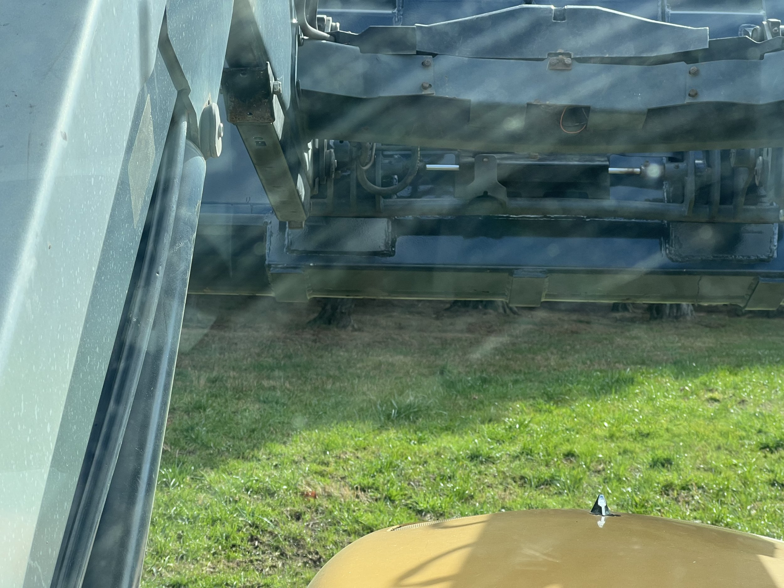

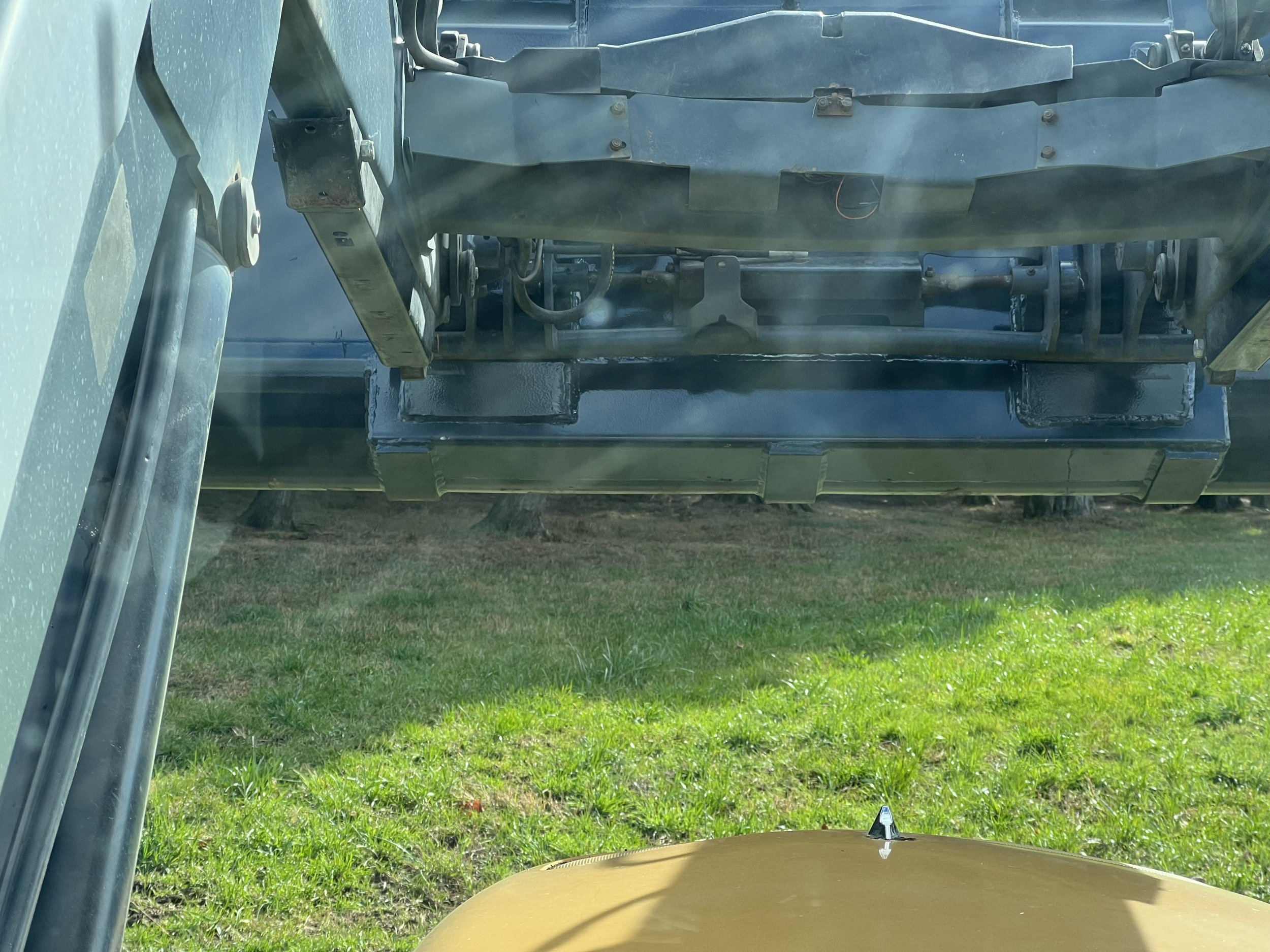

Here’s kind of how I do it from seat.
Here’s a view of the 8’ loader bucket looking through the windshield from the my seat. It is supported by the top hooks of the bucket hooked onto the global quick attach bar. Note the pins are in their retracted position. I have the bucket raised to confirm this.
Next picture is of the pins after they have been “shot” into the loops on the bottom attachment point of the bucket. I am done attaching and ready to roll.
It really couldn’t be any easier. Its a bit of an upfront expense to install, but once it’s done, like power windows on a car, you’ll wonder how you lived without it.
