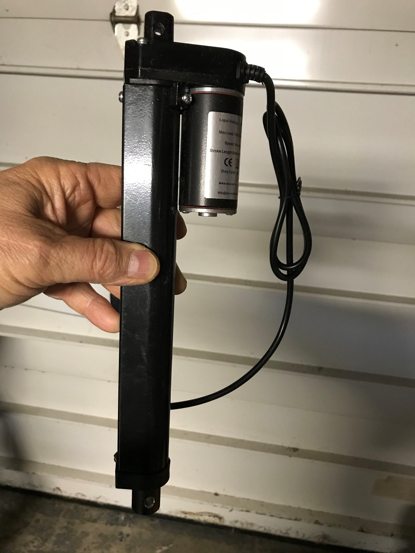

DIY MW is a site I've visited a number of times, but not recently. Thanks for posting that link. His method of connecting the LA is simpler than I was planning and is very helpful. I bought an actuator last Spring, but have been too busy on other projects to get to it. Procrastination paid off in this case:)

I probably missed it but does the actuator stop automatically when end of stroke is reached in either direction? In other words, does it have internal limit switches?
/ SSQA, From the Seat Release #10
Yes it does have limit switches
