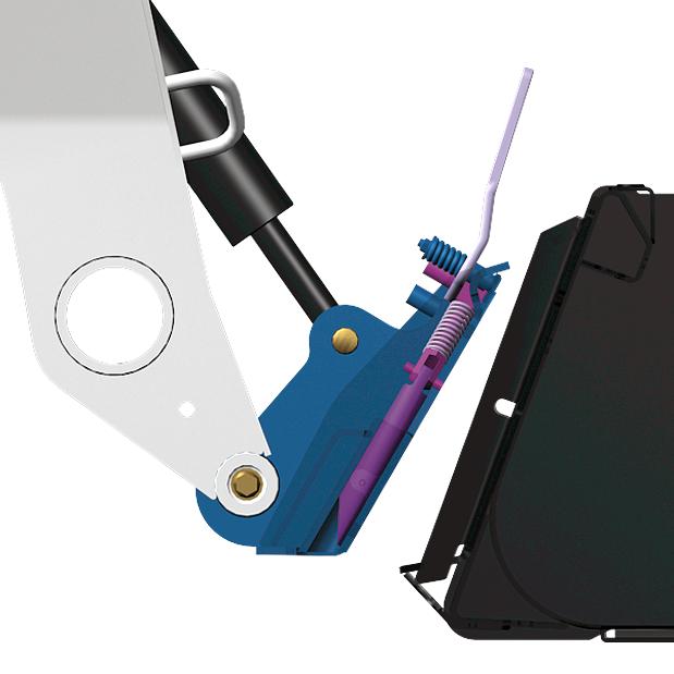

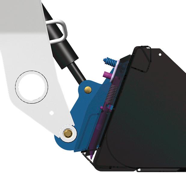

Yeah, I don't get the wedges. They don't draw the plate in. What do they do? Maybe just pierce through dirt/frozen dirt and ice. But they don't tighten up in any way.
   / SSQ Bucket falls off #72
They pin the plate to the QA.
Does this drawing help?
   / SSQ Bucket falls off #73
Thanks. I meant the slant serves no purpose of acting like a wedge. Only, maybe to pierce an obstruction in the opening. Some Ag attachment systems do use wedges for a secure attachment.

Take a second to review his top pic. It clearly shows how they work. If you still don't get it then you'll just hafta take our word for it.
