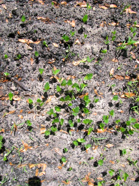

Here is the Hancock Spring & Summer mix April 8, 2013; 34 days after planting.
Can anyone tell me which seed has germinated? Looks like a cowpea to me.
