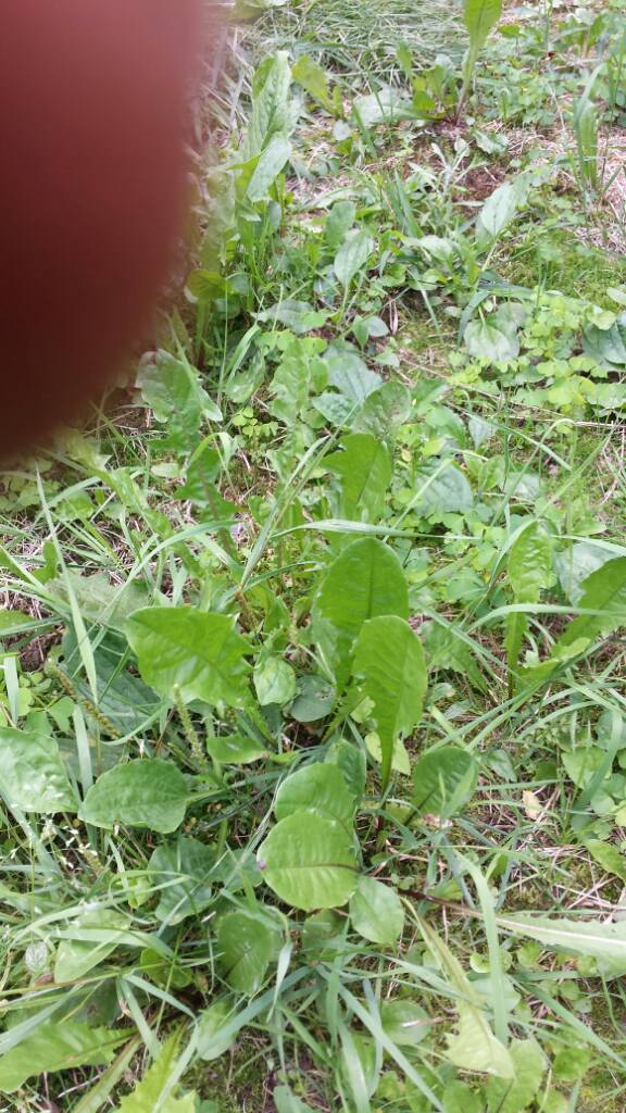

Here you go Steve I'm no weed expert but I can tell you this weed is a pain there everywhere.
   / Spreading lime #20
Don't let those weeds go to seed. Not ever.
Use generic roundup--glyphosate--and buy at Rural King if one is nearby.Cheap and effectve. Kills all but marestail and nail that with 2,4-d.
