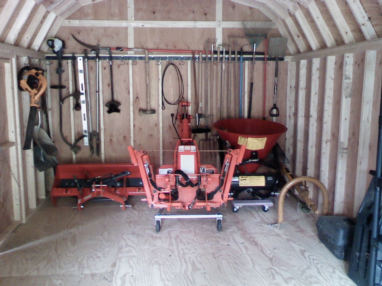

Like others, I purchased my 3ph spreader from TSC and it works great. Each year, I spread a couple of tons of lime and fertilizer on my horse pastures with my BX24. Cleaning and greasing after each use should keep it in working condition for a long time.
Thavil; thanks for posting that. Your storage building looks tucked and tight, well done. :thumbsup:
/ Spreading Fertilizer with BX #20
Thank you!! The storage building has a lot more "stuff" inside it now but the implements are still in the same location. Dollys really help out with saving room.
