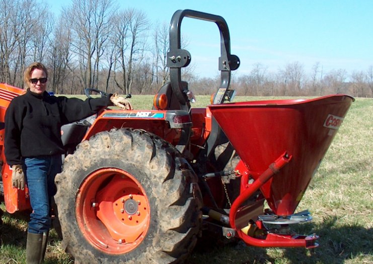

Picked up a 3 point fertilizer/seed spreader from TSC yesterday for $421.00 with tax. It was made in Italy, huh!?! Well I used it for a little fertilizer and pasture seed today. I guess I'd have to say I'm satisfied so far. Here's a pic of the spreader on the Kubota and the tractor model. LOL, don't tell her I said that, notice she's wearing gloves, she works harder than I do usually.

I am seeing a bend or something unusual on the back side of the seeder top. Maybe it just my picture or is this a new design?--Ken Sweet

Yes this one is the 500lb model. As far as a pattern it basically throws a 180 degree arc and yes the rate is adjustable. There is a chart on the spreader that gives you a pretty good idea of rate per acre at a given mph.

Ken, yes the back of the spreader is a little flatter than the rest. I can't really tell if that is the design or a shipping problem. Either way, it works just fine.

I think it got 'tweaked' in shipping. I have used the same spreader for the past 3 (4 maybe?) seasons to spread clover and milo and the like. I plan to use it for bermuda this year if everything works out right. It gets a little hard to adjust on small grass and legume seed. Works pretty good with peas and soybeans. If you run any fertilizer through it, make SURE you clean it out GOOD. You probably already know this, but nothing is as hard on metal as fertilizer. Especially if you let a lot of ammonia nitrate build up on the thing. I don't run fert through mine at all. I let the local Feed & Seed place do that with their Stainless Bed spreader trucks.
