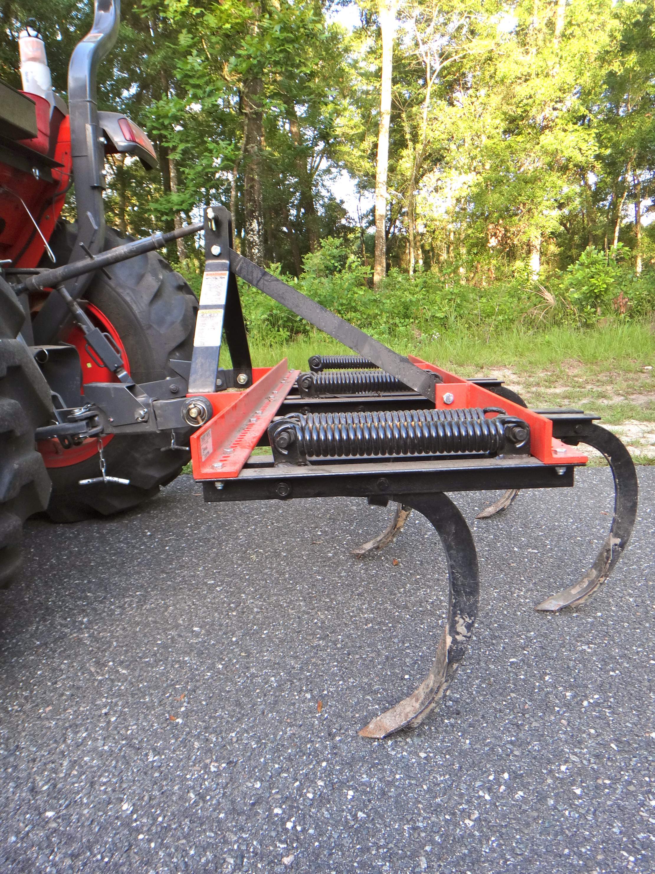

Horses can pack down a pasture so hard grass gradually declines. Is your soil hard? Does it require aeration?
There are many forms of aerators. I use a Field Cultivator in moist soil. PHOTOS.
Field Cultivator preserves existing grass.
If you have irrigation pipes in your lawn, a plug aerator is less aggressive.
VENDER: 3-Point All Purpose Chisel Plows
IOWA FARM EQUIPMENT (GO TO TILLAGE) Iowa Farm Equipment
A Chain Harrows will loosen the surface, which may be all you need in the pasture. Pull the Chain Harrow set in its most aggressive orientation and see what a pass or two accomplishes.
For your turf, mow very short then pull the Chain Harrow set in its least aggressive orientation to dethatch and scuff the turf surface. Removing the thatch will increase seed germination and take.
Here is an overseeder. Pointless to seed unless the ground is prepared, pH correct and fertilized. I recommend a soil test.
FERGUSON "YARDMAKER": Aerator Products
