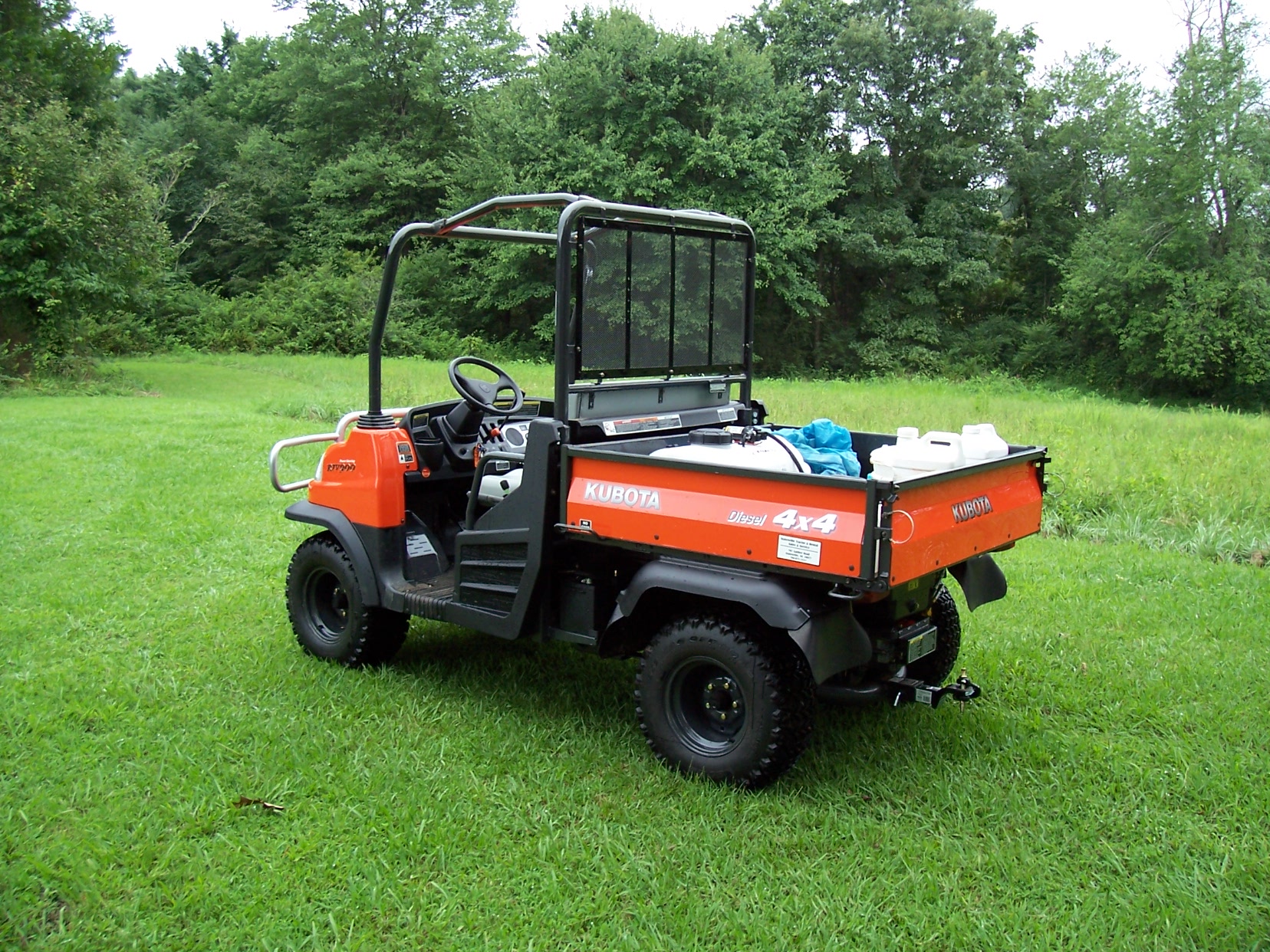

I'm in the process of trying to rid my farm of privet (a truly abominable invasive species). I have a 15 gallon sprayer with a 1 gpm flow rate that does a decent job, but I plan to upgrade to a 25 gallon sprayer with a 2gpm flow rate.

I just bought a 40 gallon spot sprayer with a 12v 3.8 gpm pump from TSC. (Delivered yesterday.) I formerly used my dad's 155 gallon PTO sprayer, but it's a pain to hook up and it leaks pretty badly.
Glyphosate is the chief weapon in my one-man privet war. I spray a 2% mix (of the 41% concentrate) on the foliage, and I saturate a freshly cut stump with straight 41%. The stump treatment is about the only thing I've found that will kill a sizable (15-20 foot) privet "tree" in one treatment. But, of course, then I've got a tree carcass to dispose of.
