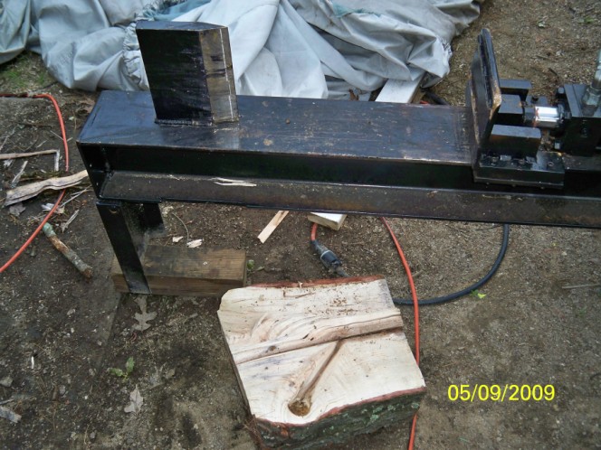

I actually ended up welding the wedge to the beam- an 8" x 1" wedge - Just for the sake of keeping it simple, plus, I was running low on argon and it's a 2 hour round trip to fill the tank.

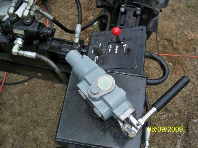

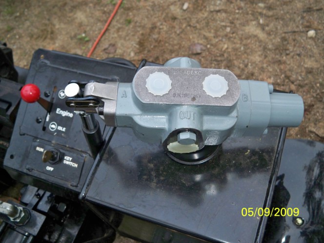

Another (potentially stupid) question- I just picked up this SpeeCo Log Splitter 3 pt. control valve. There's no mounting holes or bracket to bolt it to my splitter. The only flat area is on the top of the valve. Am I supposed to drill & tap this flat area to mount it? Even then, I'll have to build a bracket to allow me to mount it from the top... I couldn't find any info from their web site.
I bought this Speeco valve to replace the Victor Fluid valve I'm currently using- The Victor valve keeps creeping forward on me while the engine is running. Plus, I wanted to get a detent valve, which the Victor is not.

Now that's strange to me! No mounting holes? What's chances of incorporating the work ports to hold it to a 1/4" plate. Sort of like a bulkhead? IE come out of the work ports with a hydro fitting that has 2 jam nuts to sandwich the mounting plate, then attach your hoses under the plate. I'd be doing lots of sweating, drilling into a valve body! ~Scotty
PS- Also a comment on the 'dedent' valve. Mine is dedented in both directions, and kicks to center at the end of each stroke, either forward or reverse. I know the 'Safety-police' won't like it, but I wouldn't have it any other way!~S

Totally agree with you Scotty- Drilling into a valve body doesn't sound like a good idea to me either. The bulkhead method sounds promising, I just wonder if that would be too much back & fourth stress on the fitting acting as a mount over time:confused:

Many of the new valves I see on store bought splitters are mounted directly to the cylinder with a pipe nipple from one work port to one inlet port on the cylinder. Like this picture.
I guess they do this to simplify the building of the splitter, no bracket needed. This also keeps down cost on the materials for the bracket and the hose needed.

I am very glad that I mounted the wedge on the beam. My neighbor purchased his with the wedge attached to the cylinder. His splitter has two stops which are supposed to hold the logs in place as the ram is retracted. I have seen him fight with several pieces which got stuck.
Yes I have also noticed that units that can split vertical have a ram mounted wedge versus horizontal only have a beam mounted wedge.
If possible, I would get a different valve which did have mounting holes. I used a Cross double spool valve which was great to mount. The second spool on mine is for the log lift. Saves on my back.

I would not weld the wedge to the cylinder. All the designs that I have seen have the wedge bolted to the ram, but the bolt doesn't actually do anything when splitting. Their is a push plate on the back of the wedge so you don't shear/bend the bolt. The bolt is only used in reverse.
And as far as putting a wedge on both the cylinder and the beam, I have not tried it so I cant speak from experience, but when you have a peice of stringy wood that doesn't split all the way, you have a lot of leverage to pry them appart with only one wedge and the "hinge of stringy stuff" being at one end of the wood. With two wedges, and the "hinge" being in the middle of the wood could be frustrating.
The odds of both wedges making a split that meets is astronomical. You would get a lot of very thin slices on good splitting wood. On sstringy stuff you would wind up with two batches of strings to free up.

Wedge on beam for me. The drawback there is if you are buying a commercial unit, you are pretty well stuck with the vert/horiz models and wedged on ram. You can find Horizontal only ones but they run big bucks.
I just replaced my old homebuilt 1986-2009 RIP. It was underpowered and slow as well as having eaten its share of wood over those years.
My thoughts:
Height - get it up to about where your knuckles brush the beam. Mine was low until 2007 when I finally wised up and raised it 9" - world of difference!
Wedge location:
On ram (tip-up models):
Nice: The wood still to be split is right in front of you.
Bad: the "works" are right there with some of it in the way in horizontal mode. Also I have had splits fall off the log cradle and hit the engine. It is still in break in mode and that log cradle will be modified.
Bad: On wood that tends to "pop" it tends to come right at you (I caught one right in the 'nads') With wedge on ram they go away from you. I have seen some fly as far as 6' off my old splitter.
On beam:
Good: Any flying stuff is going away from you.
Good: All the finished stuff clears the work area without having to pick it up and toss it aside.
Good: Plentyof ways to build a table to hold the stuff that still needs splitting.
Bad (sorta): With an 'off-feed' table you have to pull the unsplit stuff back all of about 16" or less if it splits before full ram extension. That only takes a minor twist to one side, reach and pull.
Other than having unsplit stuff right in front of you (not a big deal) I can see no advantage to wedge on ram. That it has to be there for 'tip-up' operation is not an advantage.
My big hate of wedge on ram is having the 'works' right in the way of the operator.
