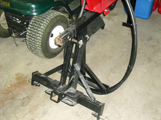

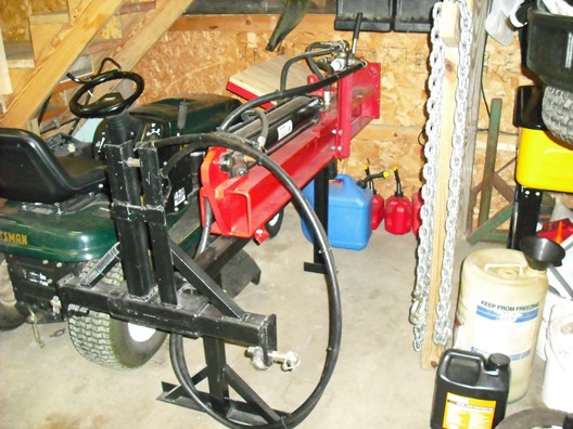

Well- $60 in fittings later and a little welding, I figured out how to mount my new spool valve. I had to cut the original mount and reverse it to gain enough clearance from the cylinder, then I used a bulkhead design to mount the valve, it's pretty solid. So nice having a detent valve! All I have left now is to mount the new axle I picked up for it, which will raise the splitter a good 8".
Nice! I miss the detent valve I had on my old splitter - I should have changed it to the 'non-detent' one I had before I sold the thing. Yes, a detent valve is a hazard and I would not let anyone else use it for that reason. I almost lost a finger due to that valve.
I also miss not having a 'center mount' valve on the new one so it would be operated from either side...but then being a tip-up model with offset axle I guess it couldn't be anyhow.
On the method of mounting the valve. My Troy Bilt also has the pipe nipple mount. However, on the opposide of the valve it has two tapped holes for an alternate mount.

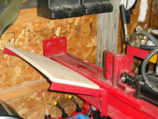

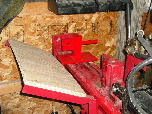

I have wedge on ram. Home made with hoizontal beam. To address the chance of angle cuts slipping off the stop plate I made mine just 2" wide and also put some teeth on it by welding some beads on the face and grinding slots about every half inch.
